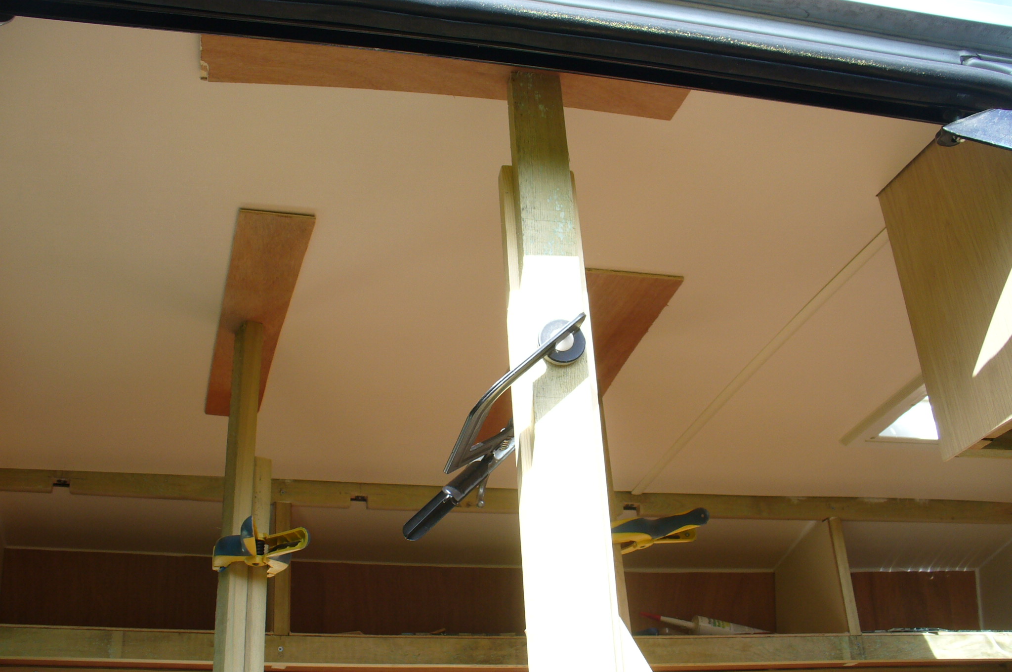

Using 2 x lengths of 25 x 50 mm roofing laths, overlapped and then clamped to create holding props along with spreader pads to attach the Morland vinyl ply that was used for the roof. I used exactly the same method to attach the 6mm ply side walls, leaving in place for 24 hours until the Stixall had fully cured.
The design and build of 'Millie'
