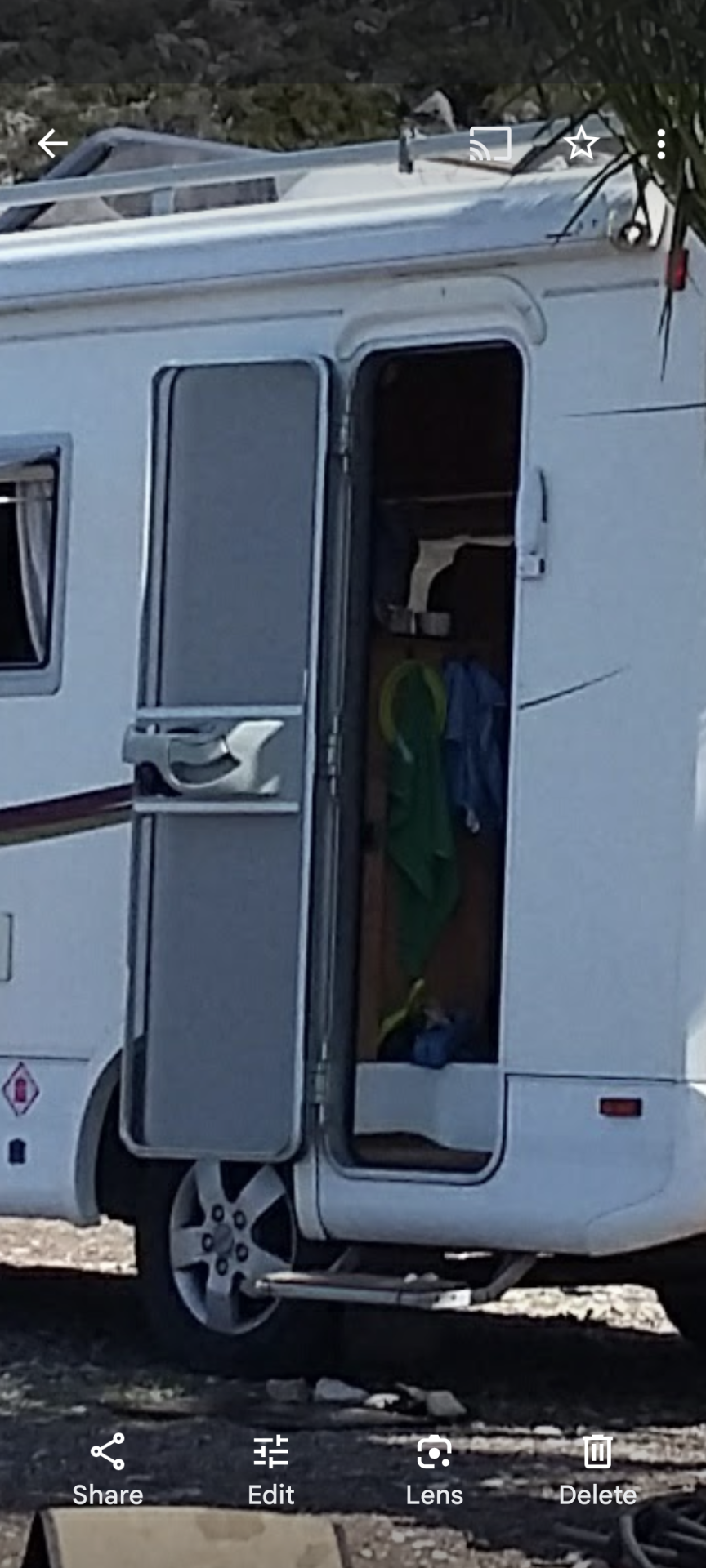

My door is a bit different to most I think. It has an aluminium framed fly screen that can open and shut with the door or you can open the door and leave the fly screen shut.
It’s the fly screen making the noise. While the door itself has 3 hinges, the screen only attaches to an extra plate on top and bottom hinges.

Edit: Found a picture of the door as attached. Guessing this is similar to yours? Screenshot_20231029-073027.png

Edit: Found a picture of the door as attached. Guessing this is similar to yours?View attachment 124433
While it is different to you pic the idea is exactly the same. Looks like I will have to take each hing off in turn and fettle them up. Did it need the pins driving out as one part will be fixed in one part of the hinge won’t it, (one fixed and the other free)?
