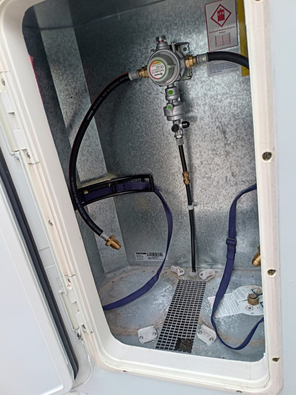

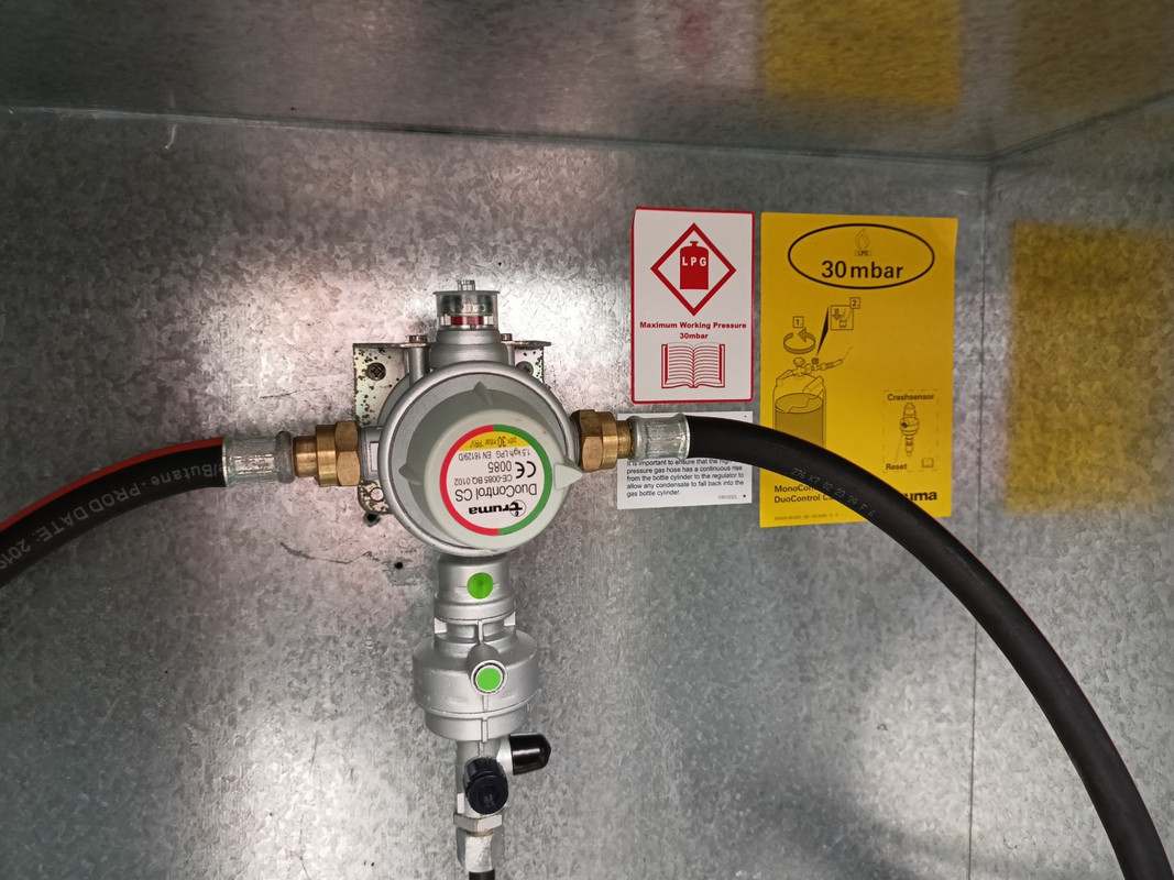

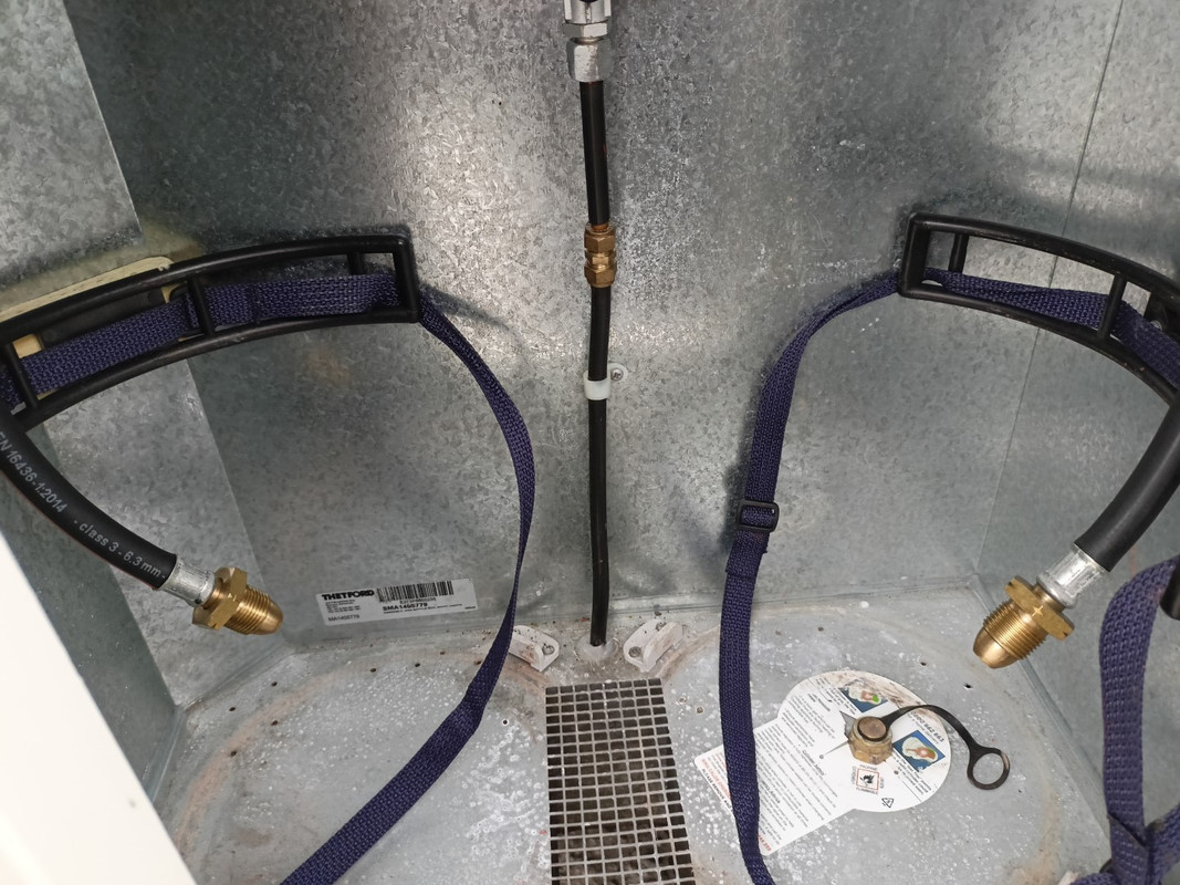

Current van has a single 11kg Gaslow with a 6kg Calor as backup. There is a filler for the gaslow on the side of the van. Proposed new van "appears" to have a gas locker that will take 2 x 6kg bottles (not sure if it will take a bigger bottle. What would be the best solution for an LPG system that allows for a Calor backup? I am a bit reluctant to put in a 6kg Gaslow and an 6kg Calor as ill be forever hunting for LPG stations. Are underslung tanks a good idea and if so would it be possible to incorporate a calor backup in the locker. I have been talking to Autogas 2000 in Thirsk but their 2 x 6kg Gaslow system is between £780 to £830 which seems a lot to me, underslung tanks probably more.
Any thoughts or recomendations?
This is the locker on the potential new van which is a Swift Esprit 496.
I suppose one option would be 2 x 6kg Gaslow and then stick a 6kg Calor in storage somewhere. Not ideal though.

I wish I had measured the blooming locker now. Does your locker resemble the one in the photos above at all?

I note your locker space is limited.
Maybe an 11kg refillable and a 6kg calor will fit ? Or 11kg and 6kg refillables.
That would be ideal as its what we have now but I dont think the 11kg will fit and im kicking myself for not measuring the locker and cant find anything online. Unless Stephen from autogas 2000 who has been really helpful comes up with something else I reckon ill just fit 2 x 6kg and get all the necessary bits to swap one out for Calor when in the UK.
