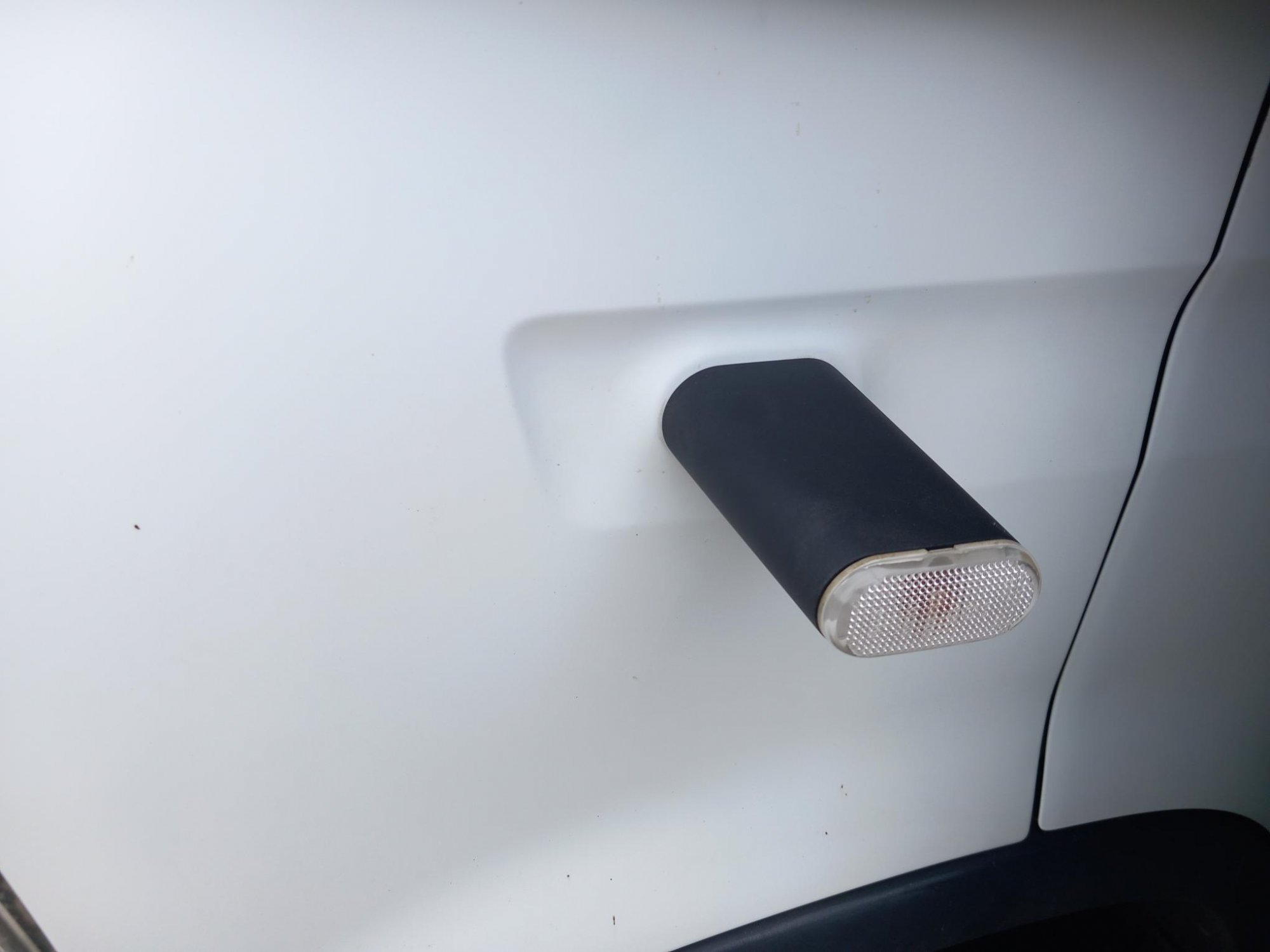

Interesting. The part number is the same but the part looks different. Mine does not have the part highlighted in yellow
Unless the lens has come away from the white piece in the photo below. It would make sense if the part that normally fits flush with the vehicle body is the same as the one that is on the end of the extender.

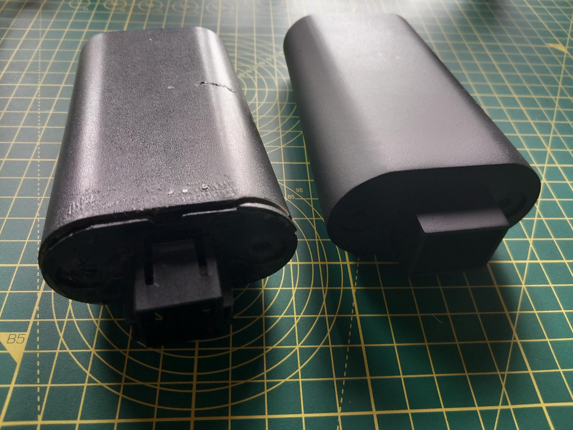

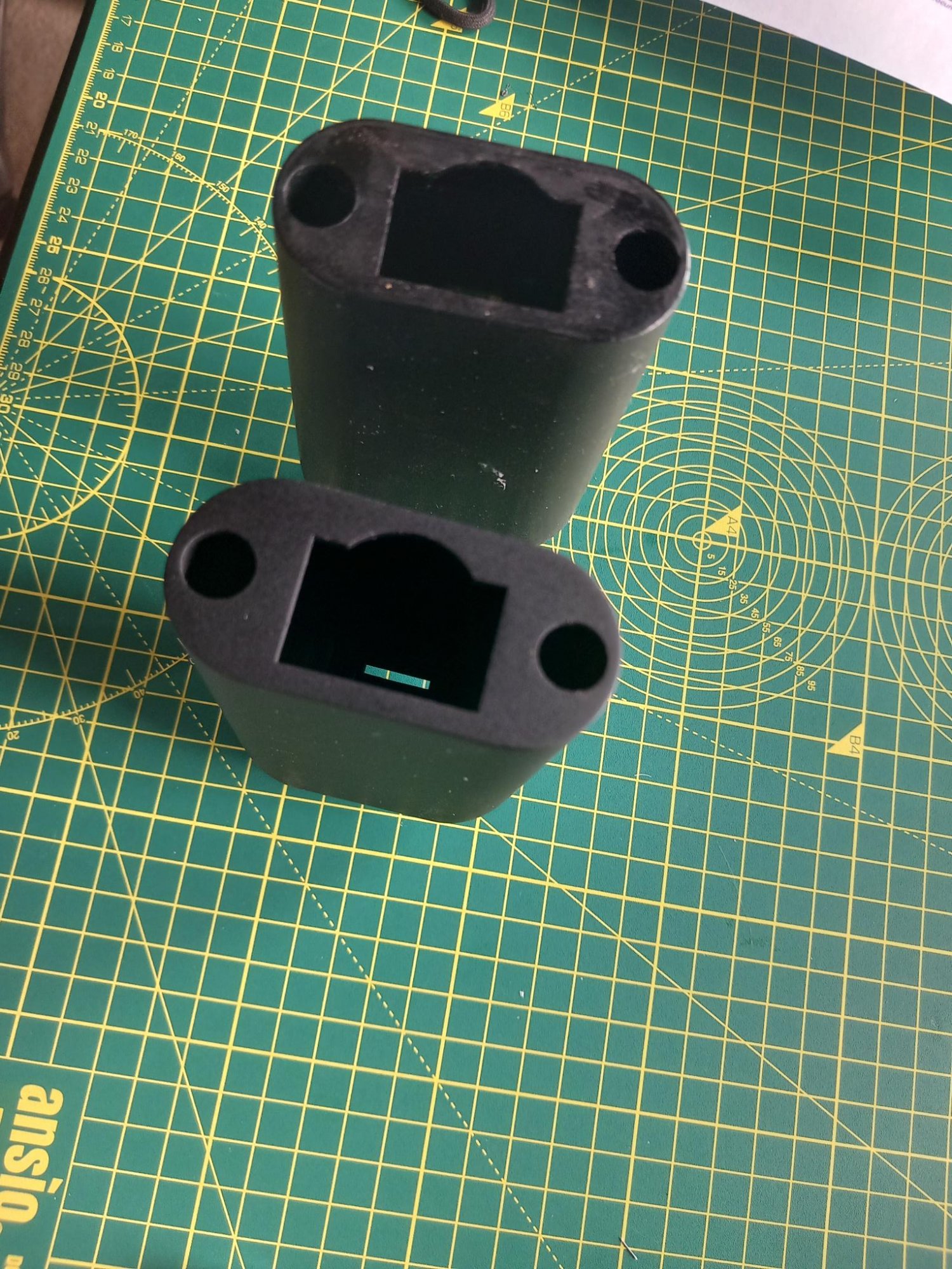

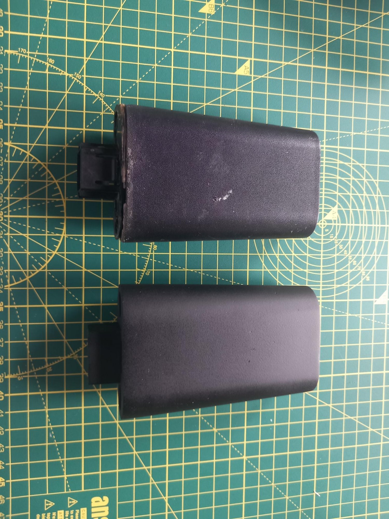

The indicator extension tube on my Renault Master-based Knaus Sun Ti got broken off by somebody in a car park.
I couldn't find a replacement anywhere, so I modelled it using FreeCad and had it 3D Printed in China.
Took about 3 weeks, but I was very impressed with the print quality. PM me and I'll drop your the .STL file.

I appreciate it's the side indicator lens you are missing - there seemed to be quite a few sources by Googling "Renault Master Side indicator extension". If it doesn't fit exactly, I think I'd attack either the lens or the stalk with a Dremel & sikaflex it in!!
For any Renault Master parts, you can also try a Vauxhall Dealer ... the Master and Movano are the same basic vehicle and share 99% of parts.
It looks like just the lens bit has parted company, may as well order and fit the new part when it gets back.
