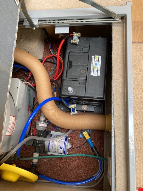

Looks a tight space that. Obviously check the measurements on any replacement. As regards solar if your van is like ours of a certain age and not very power hungry you will probably get away with a single 100w panel and mppt controller. If you can fit it yourself, about £200.
Not only a tight space but no secureing clamps. :eek:
You definately have a size limit there with the heating hose.
The battery also looks fairly small. Be worth measuring the length and the depth(width) of the current battery and also from sides to hose in both directions to see what could be possible, AND the height of the enclosure as well to see what limit you have there.

The battery appears to be clamped into the base plate at the sides, Trev? *
It certainly won't budge without unbolting the metal supports that are tight against it 🤷‍♀️ :)
(* and the base plate is definitely going nowhere as it is also bolted firmly to the floor... 🤔 )
There is space, I think?
But the battery sits on a metal plate which is bolted to the floor.
Is this is a standard sort of setup?
Guessing the current restriction for a replacement battery would be the size of the metal base plate it sits on? 🤔🤷‍♀️
Looks tight. You might get a 110 or 120 in there at a push but you might have to modify the plate. I had a similar issue which is why I mentioned it. I took all the precise measurements and the 120 AGM fitted but only just.

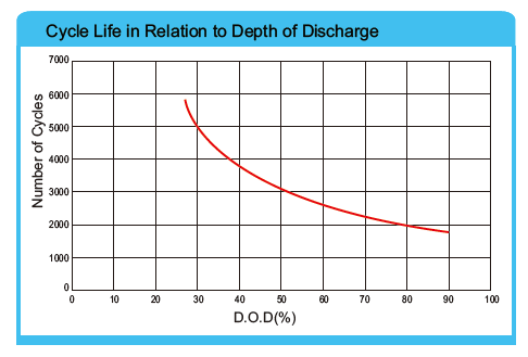

According to Alpha Batteries "• Typical max. cycle life of 700 cycles @ 50% Depth of Discharge (DoD)" Trev.
Not sure which battery you are quoting for the above info?
No matter, the manufacturers (Ritar) Data Sheet for the Lead Carbon Batteries from Alpha Battery is available on this link - https://www.alpha-batteries.co.uk/1...rbon-gel-ultra-deep-cycle-battery-exp12-160c/
Within that Datasheet, there is a chart of the correlation of Expected Charge Cycles vs the Depth of Discharge (DoD = 1 - SoC. e.g. 80% DoD means you take the battery down to 20% SoC).
Below is that charge grabbed in a screenshot
I would say the numbers are pretty good and maybe on the upper side of optimistic, but even if you halved them you get both a performance way better than something like a Banner Bull say and even if you discharge lower than the "never go below 50% mantra" oft repeated, you still get a very good peformance.

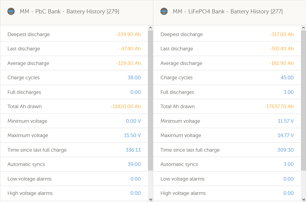

With my Lead Carbons I don't worry in the slightest if they drop below 40% SoC (I have 30% as my minimum) and the Lithiums can drop to Zero% if they want. So far in around 3 years, according to the Victron BMVs I have done under 50 cycles on the batteries (and the BMS on the Lithium is from Memory in agreement give or take) so I care not if a battery is quoted as 3000 cycles or 1500 cycles or 1000 cycles -it will make very little difference I would think for me.
