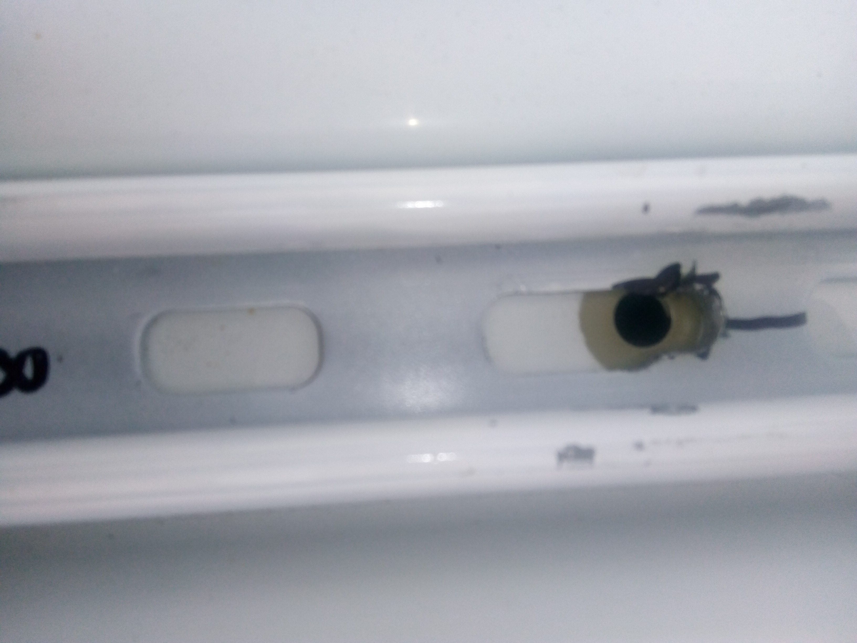

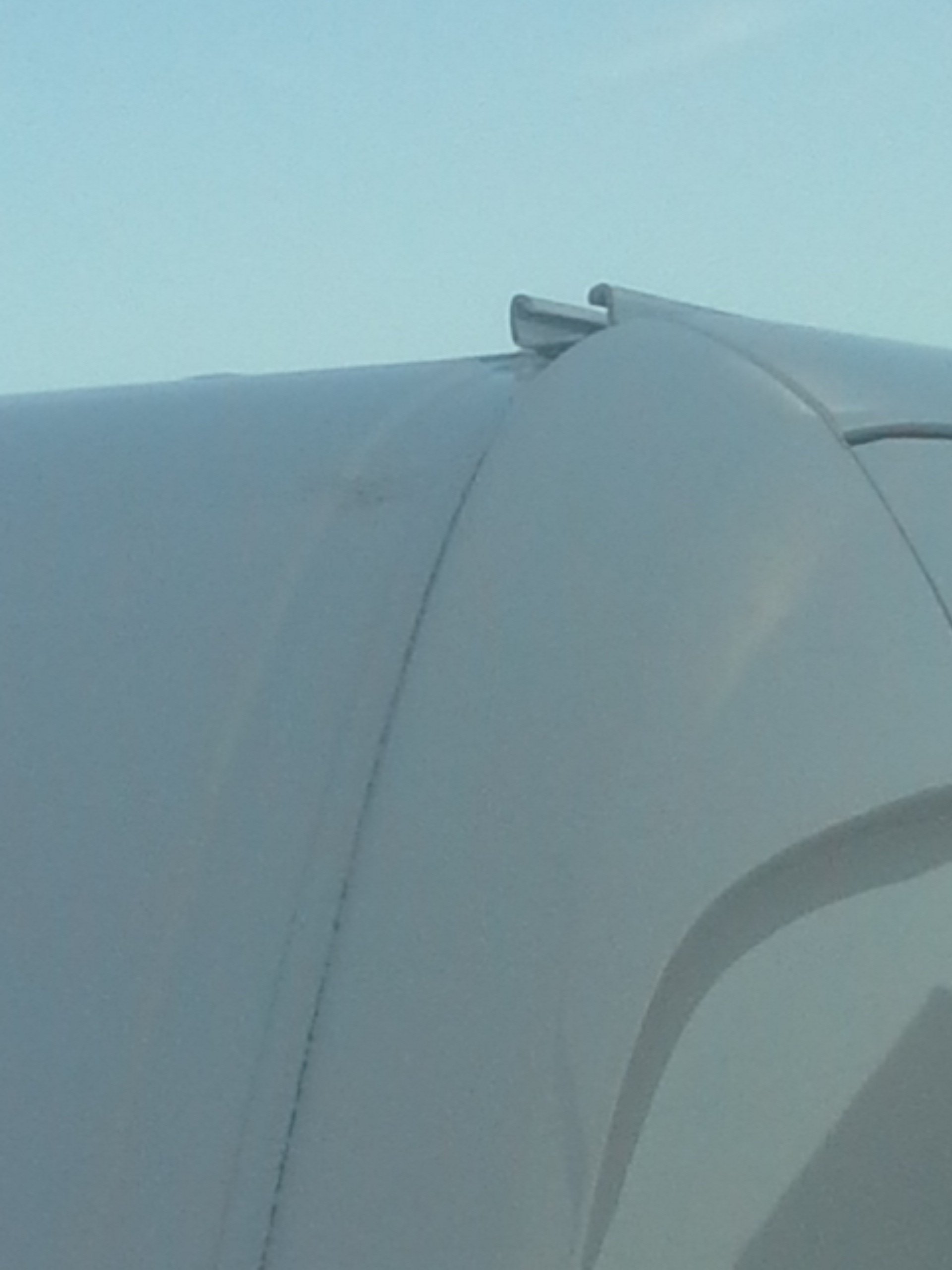

I put 19 mm of strip mastic tape and bolted down from inside no leaks. ?

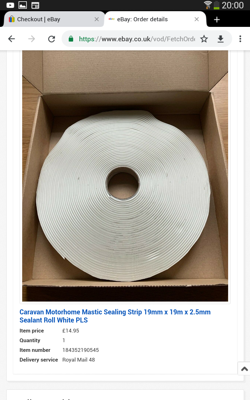

Got 20 meters in 2 days from ebay £15.00
Like this

And this
This is the one I used

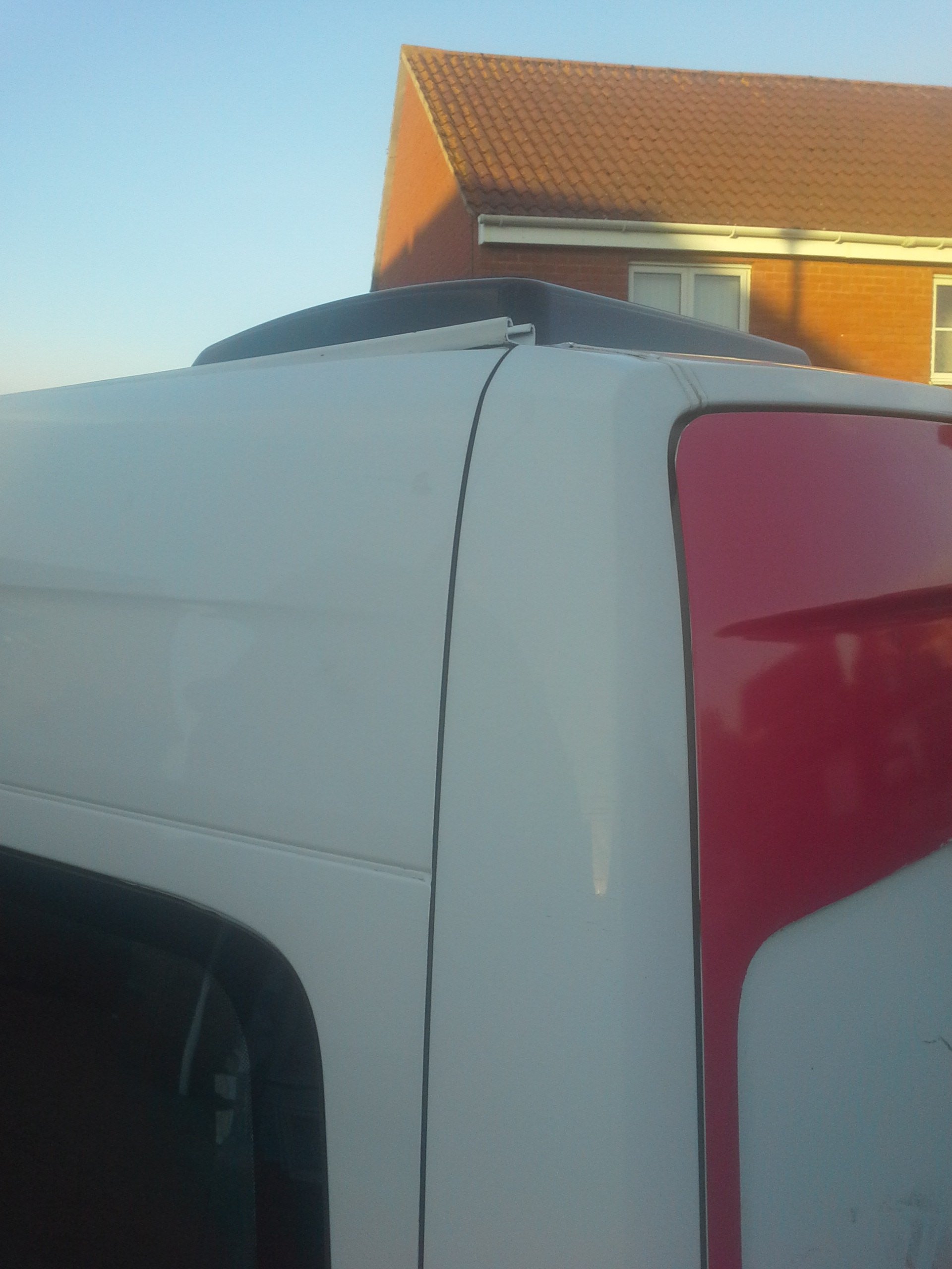

Thank you Sprinter but I am not penetrating the body. There are two roof bars in situ and I am using them. Good idea that though

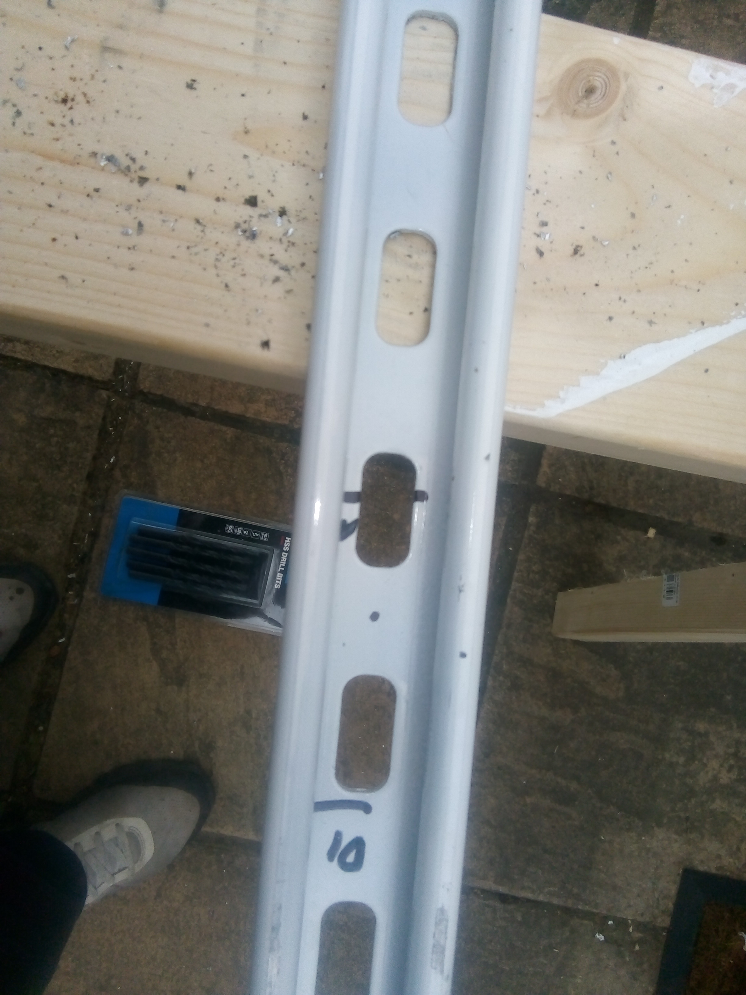

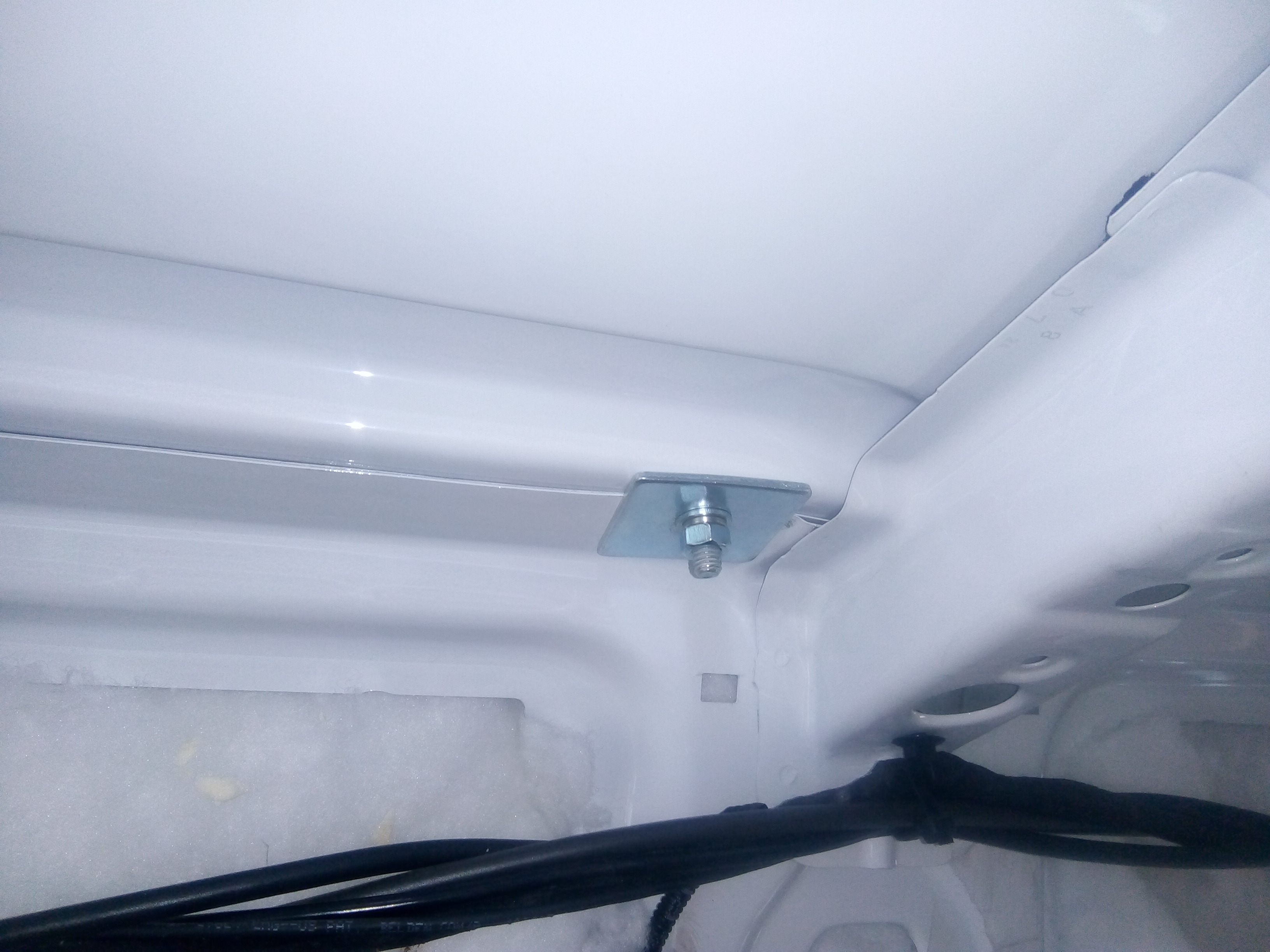

I used the low one 22mm as I'm hanging a awning of the unistrut. And it sat inside the gully up there 4.6 m. .run it a little longer as I got the 6 meter leangth at £30.00 each including 2 cross railsoff cut for lighs rails
back and front.

I asked as i was not sure if the 22mm one is tall enough for a cross bar.
Many thanks!
Thank you!
Not fitted cross beams yet. the out side of the sprinter roof sits proudest . Its like a W shape
