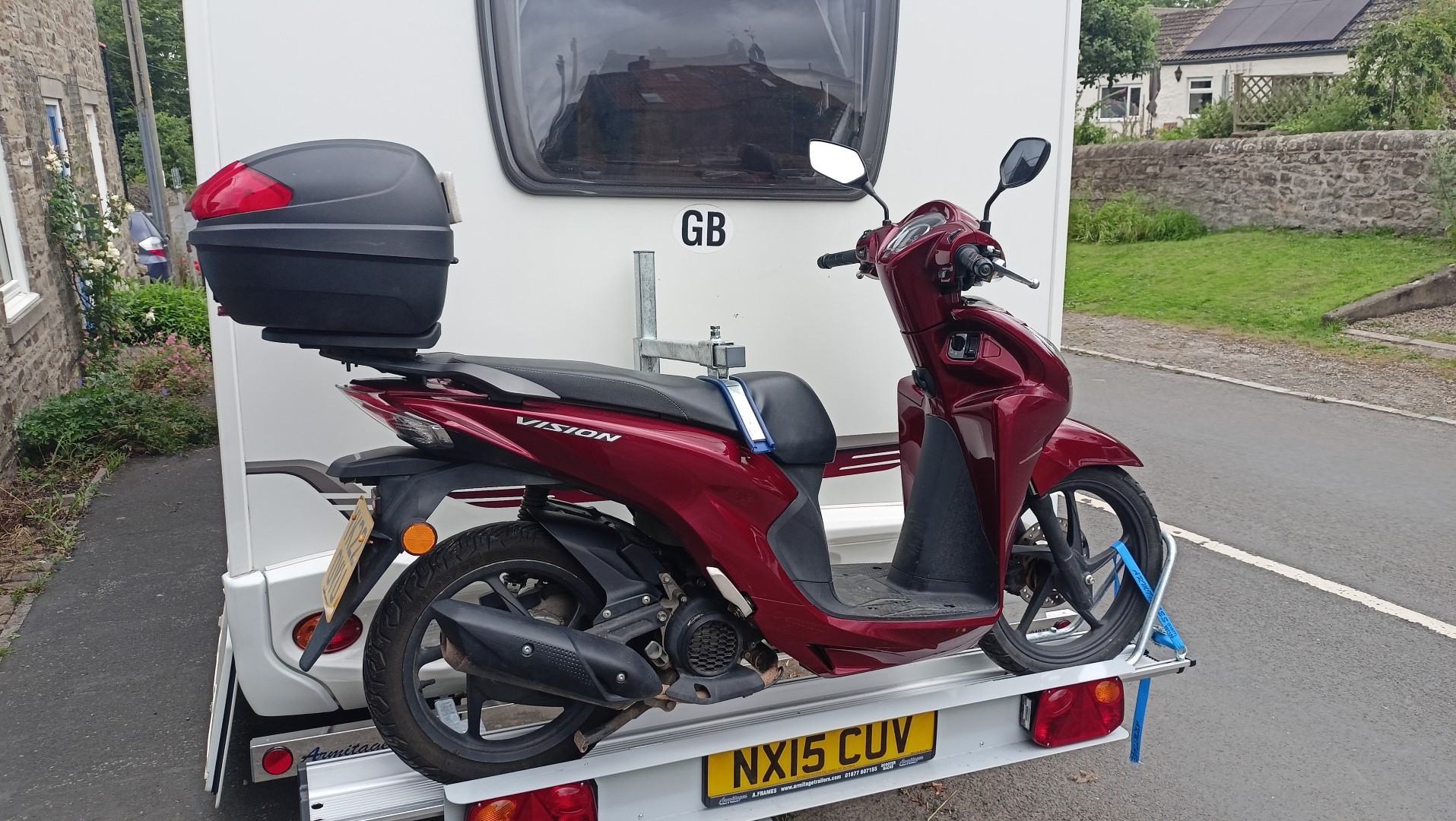

You might not be far out. When I put my first rack on my old Kontiki the rack was about 30kg and the bike 95kg and after doing the maths it added about 300kg. Just within the limits. That was a long wheel base Alko chassis though. That van is very short. I never noticed any difference to handling but I loaded up the luton to compensate. My pal dear old Tuggers (RIP) did on his Bessacarr though. Again a shorter van but he definately noticed a difference on the front wheel handling and that was just with a Honda vision on the back. On our new van 8.5 metres 4.25t there is no difference at all with the bike on or off.

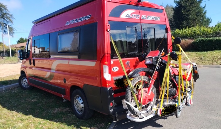

You can't have enough ratchet straps apparently. :LOL: This was a guy I was conversing with on the Motorhomers with bikes group on FB yesterday. Better be safe than sorry I think he said. He seemed a bit flabbergasted when I showed him mine with just two. :D I dont suppose he will mind me posting it. I blacked out his reg (although he never did on FB)
You can't have enough ratchet straps apparently. :LOL: This was a guy I was conversing with on the Motorhomers with bikes group on FB yesterday. Better be safe than sorry I think he said. He seemed a bit flabbergasted when I showed him mine with just two. :D I dont suppose he will mind me posting it. I blacked out his reg (although he never did on FB)View attachment 140688
I would trust your two straps more than his 700 straps, the way he has put those straps on most of them aren’t doing anything,
You missed blacking out the reg at the top of his van Barry.
