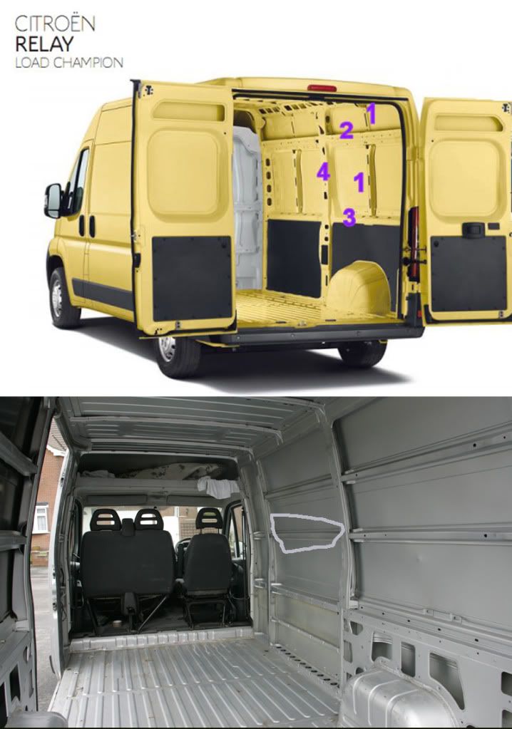

Usually the mid height horizontal stiffener is important. On my van the there is a small vertical stiffener above this midspan which is just a panel stiffener. You can remove this when you put a window in. It's usually clear where the windows are meant to go by looking on the outside of the van and seeing where the indentations are.
In the attached picture 1's are the one you can cut away easily if you put a window in. I wouldn't touch 2, 3 or 4. You might be able to remove 2 if you put in rails of equivalent strength above and below your window. Very much at your own risk though.

Hi
My van is slightly different to the van in firefox's pic. I would like to remove the horizontal bar I have circled......
I removed both of those on my boxer, I did fit a bonded window which gave it the strength back, if you are fitting seitz or the like I would fit timber strenthening battens.
Yep, that one is OK, It's where the window normally goes. They confusingly put in a horiz panel stiffener, not a vertical one!
