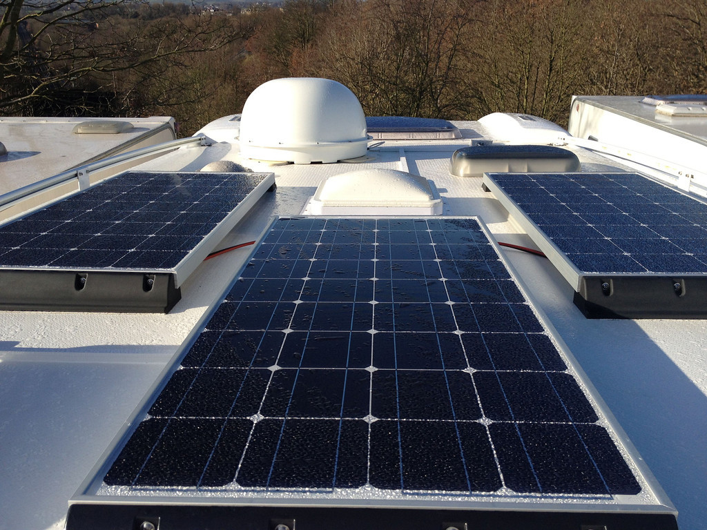

2 arrived today. Took 4 days, not bad considering they come from Belgium and the disruption on channel crossings.
Very well packed and they look very well made.
I was happy with the 80W panels on my last camper from the same seller and these look even better made. Frame looks very robust 35mm.
