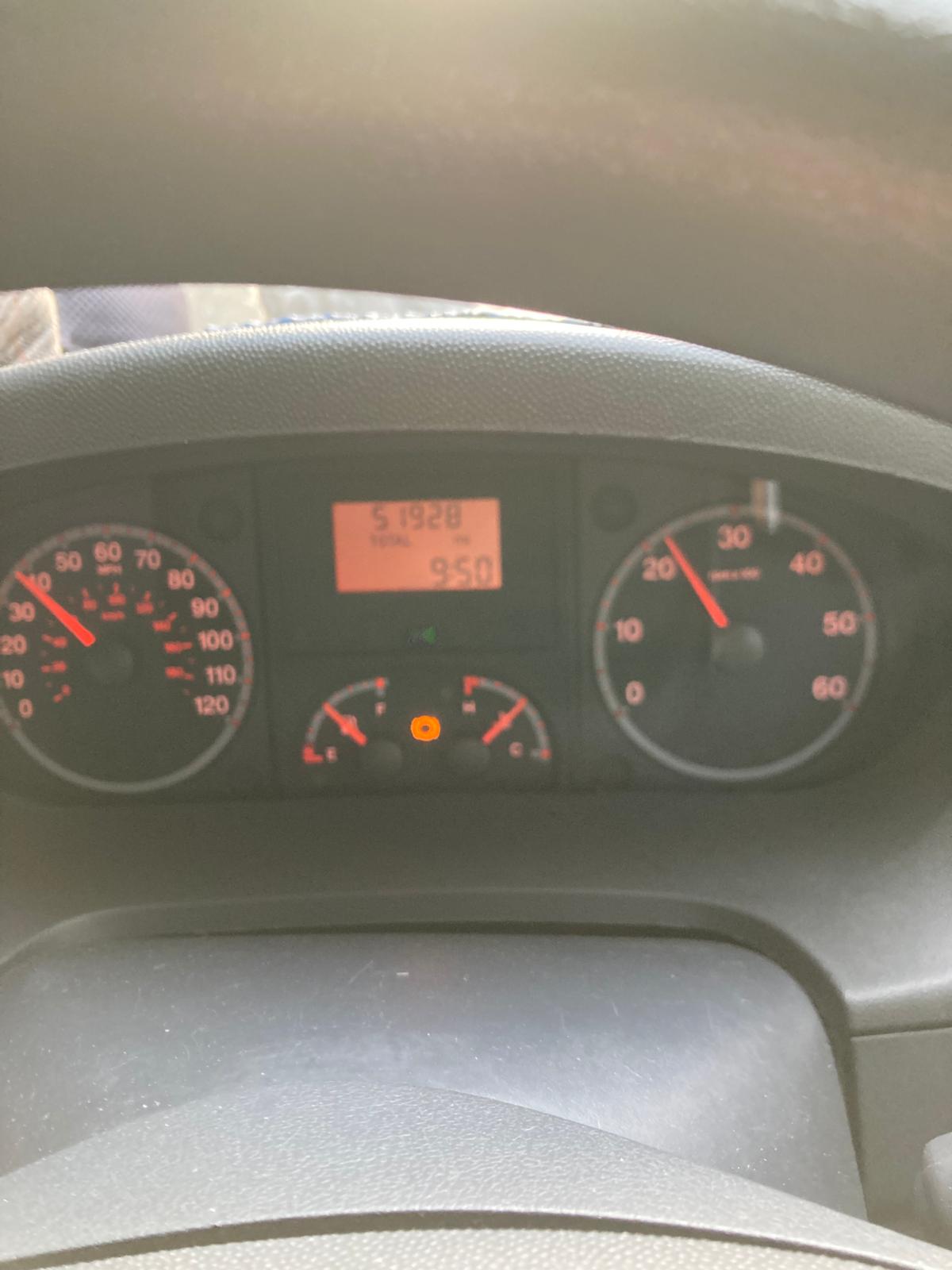

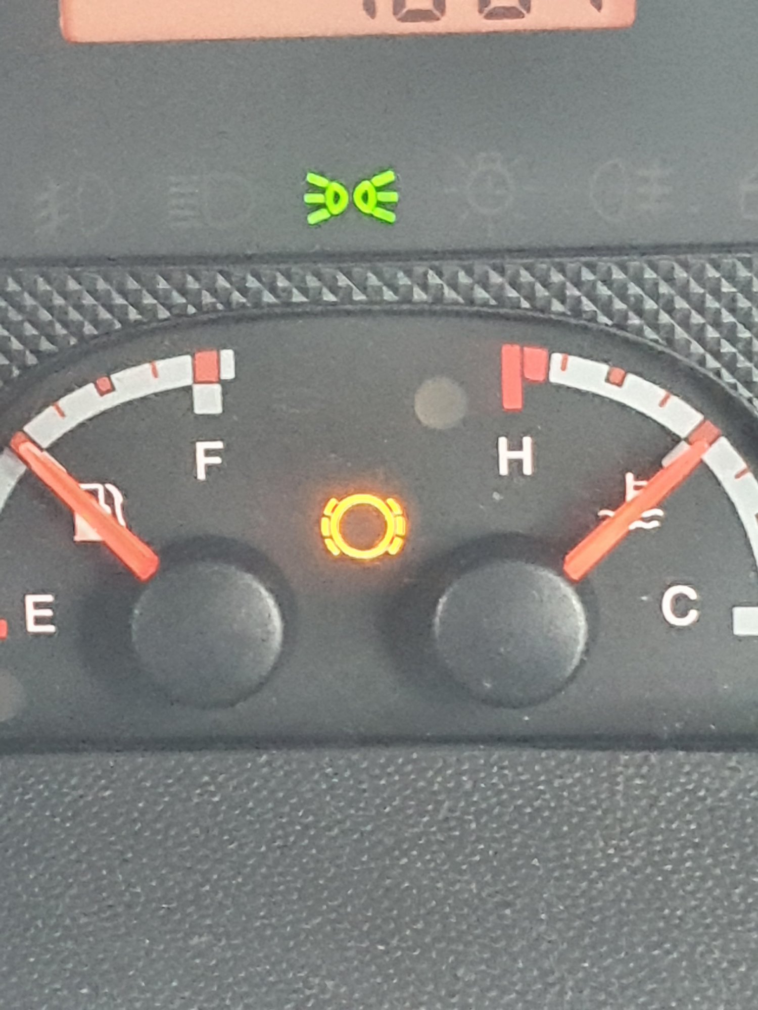

Between the fuel and temp gauges. opped up a few times now, goes off with ign for a while then comes back, my online manual misses it.

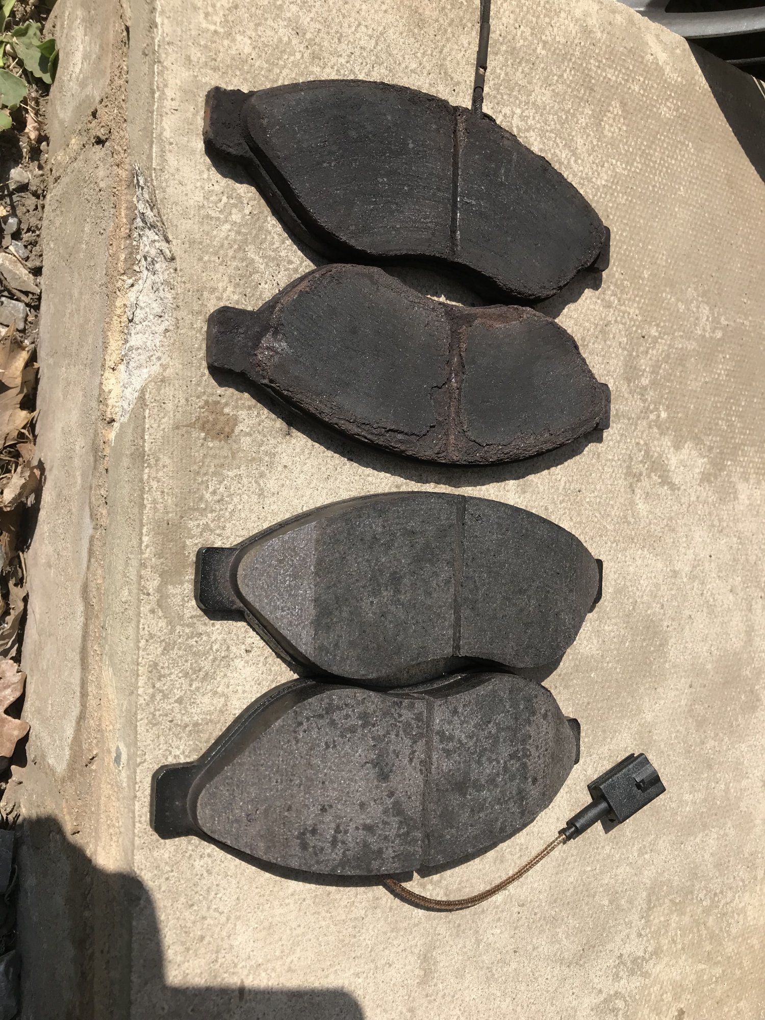

As the low wear method for the Ducato (I’ll assume Boxer is the same) is only ONE front pad has a wire, it maybe that it is getting just in the edge of low and only contacting intermittently. I’d be checking both sides for certain. I had one time the wire dropped out of the pad and ended up with almost metal pads.

Not for rear shoes, and by the time the warning light embeded wire hits the disc you may have only hrs to sort & sometimes the pad leaves the metal backing plate.

All new two years ago, nsf sized up on M6 so had to get them done, I'm light on my brakes normally, I thought it may be fluid, but it has no sensor and is full anyway.

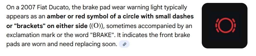

Oh, yes that looks like your typical brake pad wear indicator, strange it's in a different position, and strange it ain't in the manual though.
