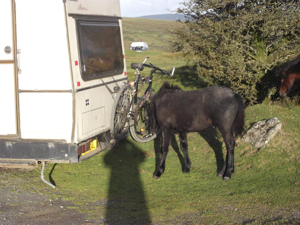

I've had one of these now for four years. It's a very handy 2 bike carrier which clamps on to your towbar with a scissor action. It will be helpful if you have a back window to thread the secondary supporting straps through. Easily removable and very solid, it cost me £45
Warning! Dartmoor ponies can be very partial to this particular make!
