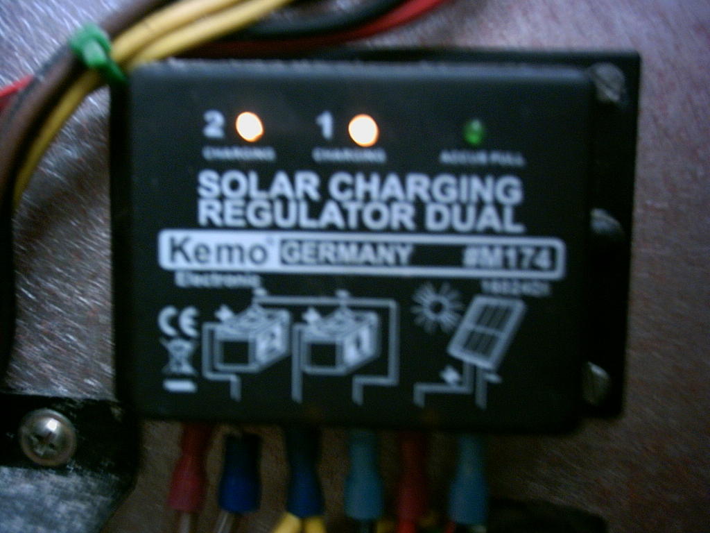

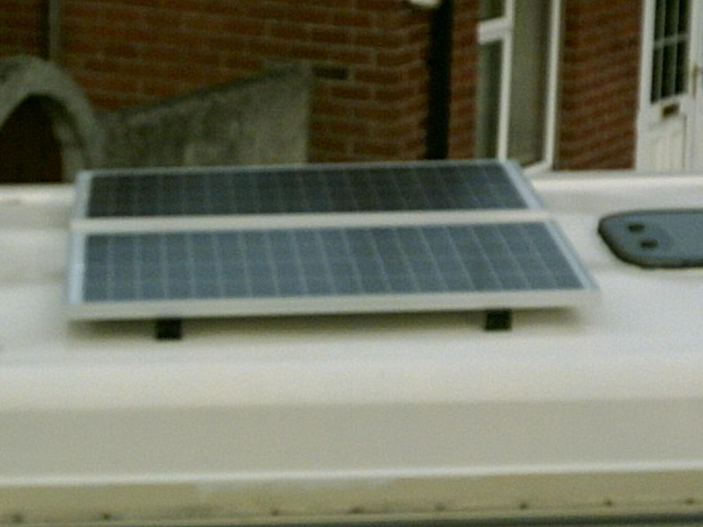

i got 2 100 watt panels of ebay 100 bucks and used this split regulator charger 25 bucks which charges starter batt and leasure with the lowest one geting charged first.
