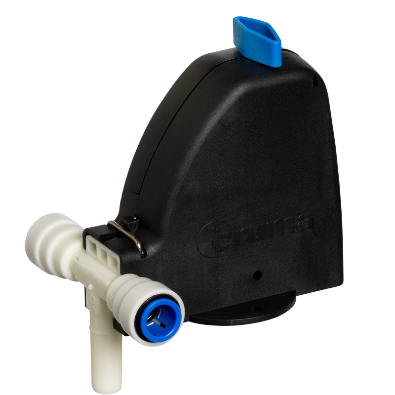

When using my van during freezing conditions I leave the heating on overnight and to stop the water dumping on my older type valve it just requires a clothes peg on the valve to stop it dropping and allowing the water to escape.
Picture is of the newer type valve which can also be blocked but I can't advise how
It looks similar to mine, does it have a plunger that comes out when the blue knob is turned?
If so, on mine I have a piece of dowel against the wall wedging it shut. A bit bodgey but it works.

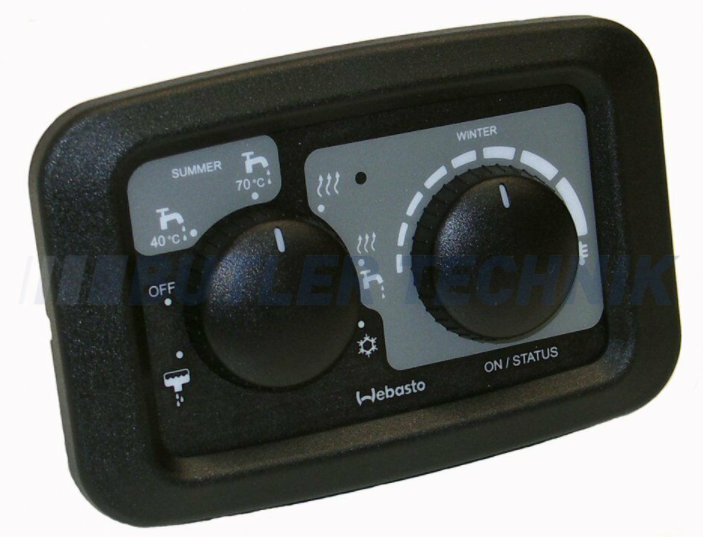

If you have no water showing when switched to drain down it’s more than likely the drain it’s self is stuck due to limescale buildup. The unit will also dump water if voltage drops below a predetermined point again to protect the unit. If you’ve never had the unit serviced I would recommend viewing webasto website full instructions are given on descaling unit. To give you more info I would need to know what controller etc you have fitted as there a few different options. FYI I am an approved service agent for webasto. HTH oh and please don’t “override” the system as these tanks easily split with frost and are very expensive to replace
Hi Mpdyork, thanks for the reply.
The unit is described as a 'Dual Top'. A pic of the control panel is attached.
I cant find any info on my unit or descaling on the webasto site anywhere, I'm probably not looking in the right place?
Previous posts have lead me to the conclusion that the I actually need to block off the drain outlet anyway so to be honest so I'm not particularly bothered about getting the automatic drain facility functioning 'properly' because ultimately I'll need to disable it anyway!
I'm the 2nd owner of the van so obviously don't know it's use history, it's 9 yrs old, 26k miles and the interior condition indicates that the van hasn't been used a lot, the tap spout outlets don't have any limescale deposits so I'm thinking that the limescale build up in the boiler will be slight at worst? I'm obviously quite wary about putting chemicals etc through the system if there's no genuine benefit to be had.
From your experience what happens / fails when a unit isn't descaled?
Merl

The floe device I think will be tapped into the cold supply from my experience, so will blow through if both taps are open. if you wish to inspect the drain valve you would have to remove the end cover and associated pipe work not an easy job to carry out off your back. As you say it may be better to leave it be, especially if your not familiar with the workings of the unit. I would be cautious though of any “blocking” device as if there is an overtemp situation the pressure has to go somewhere!
I had briefly considered the overheat situation but assumed that an overheat and subsequent over-pressure situation would be catered for by some sort of separate built in safety valve device somewhere else within the heater unit. Surely Webasto don't use and rely on the drain solenoid for this? Or do you mean that both the safety valve and drain solenoid are 'T'd' into the same discharge pipe?
