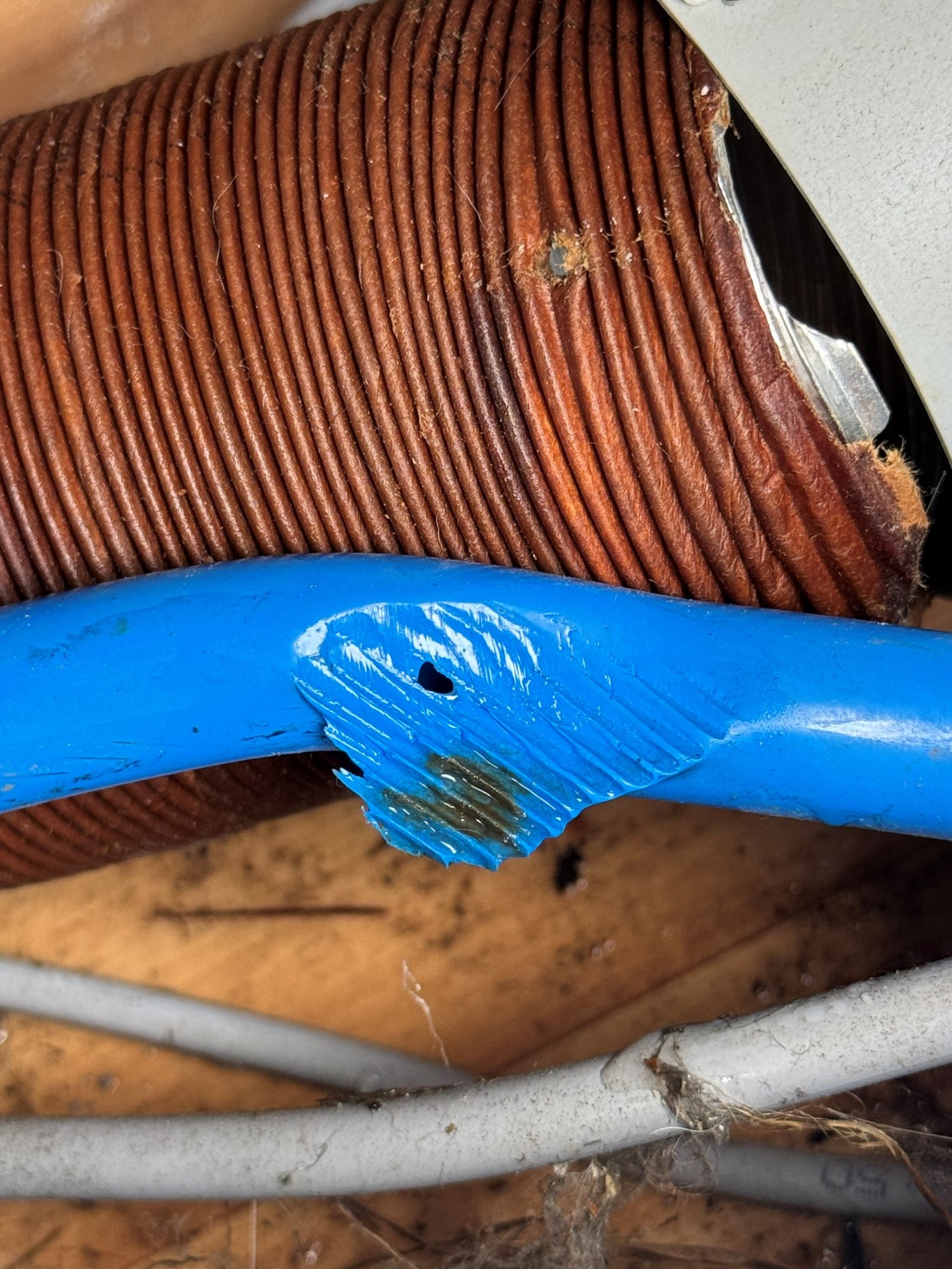

Thank you all for your help! I've had a fun day today. I saw that there was some water on the floor. Initially I thought that maybe it was an overflow from when I filled the tank. However, some time later and with the help of an endoscope, I found a problem. I think when I ran the new pipes I must have pushed one of the original pipes (the main pipe from the pump) up against a Truma hot air pipe. From what I can see, I think the water pipe has been melted by the hot ait in the heating system. I'm surprised (as I wouldn't have thought it was hot enough to do that) but that's what it looks like. I won't know for sure until I can properly get to the pipe. Unfortunately, it's under the toilet, so not the easiest place to access! It looks like the top of the pipe has melted so, while it might be letting a little bit of water out, the main problem is that it is letting a lot of air in. At least, I hope that's the problem .... although it would have been simpler if it was just a dead pump! :)
I can't believe that the pipe has melted. The pipework is capable of carrying very hot water after all!
You're right. It surprised me too. The heater pipe that was touching it was very close to the heater itself so it would be as hot as it was going to get but, even so ... (see photo).
It turned out that the pump was also struggling so I ended up putting a new pump in too. :-(
