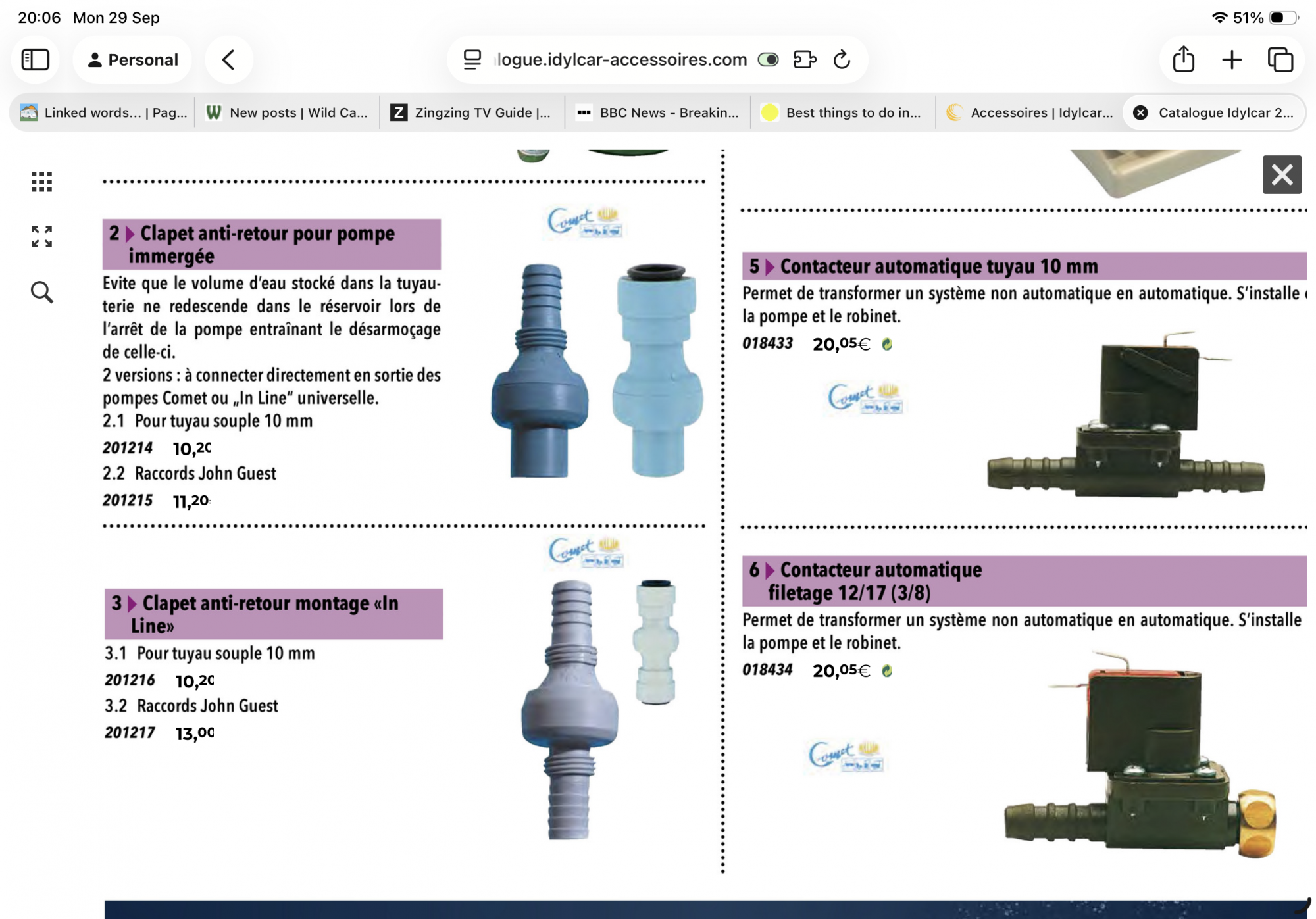

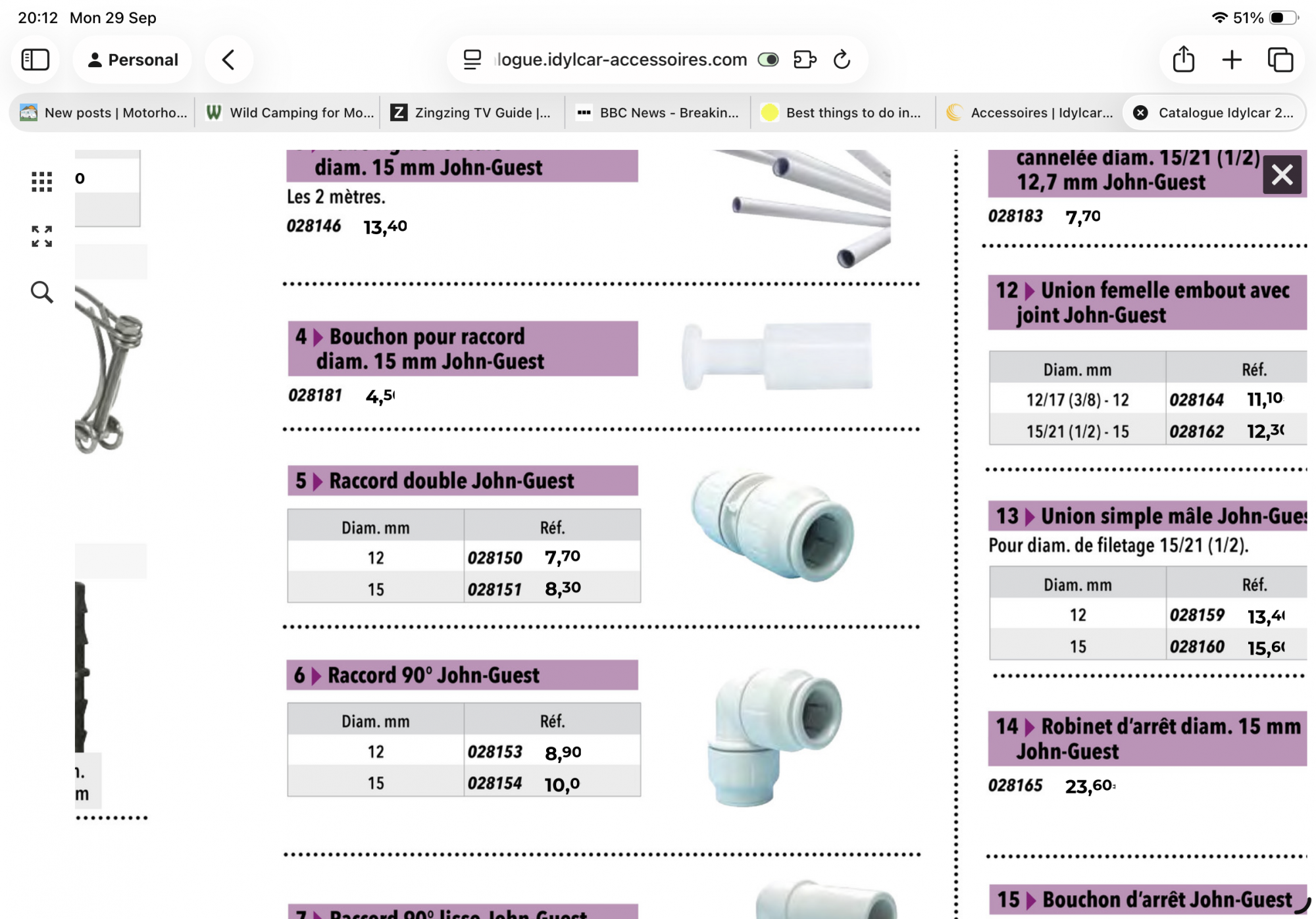

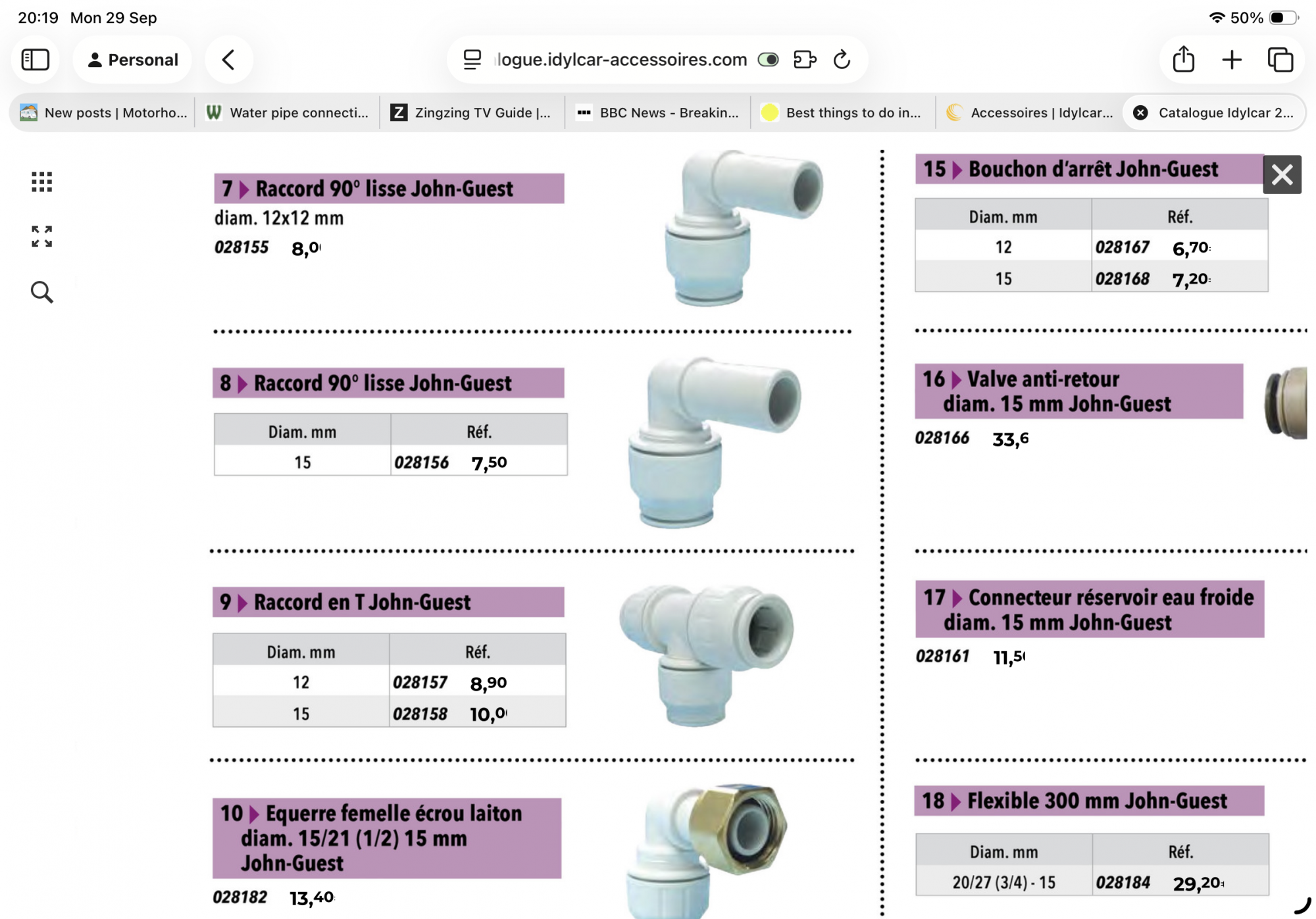

I missed this post yesterday! We are now re-routing to try here first for the fitting mentioned in your later post.Update ........
This outfit have dealer accessory outlets in Tarbes and Perpignan .....
This is an extract from their catalogue showing JohnGuest fittings .......Accessoires | Idylcar Tarbes
tarbes.idylcar.fr

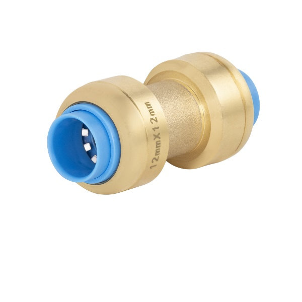

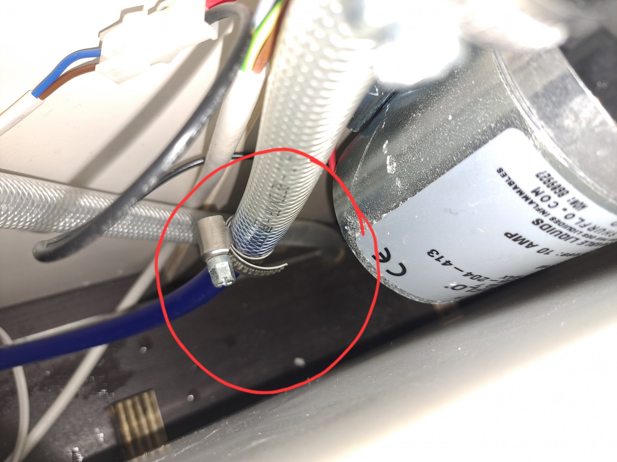

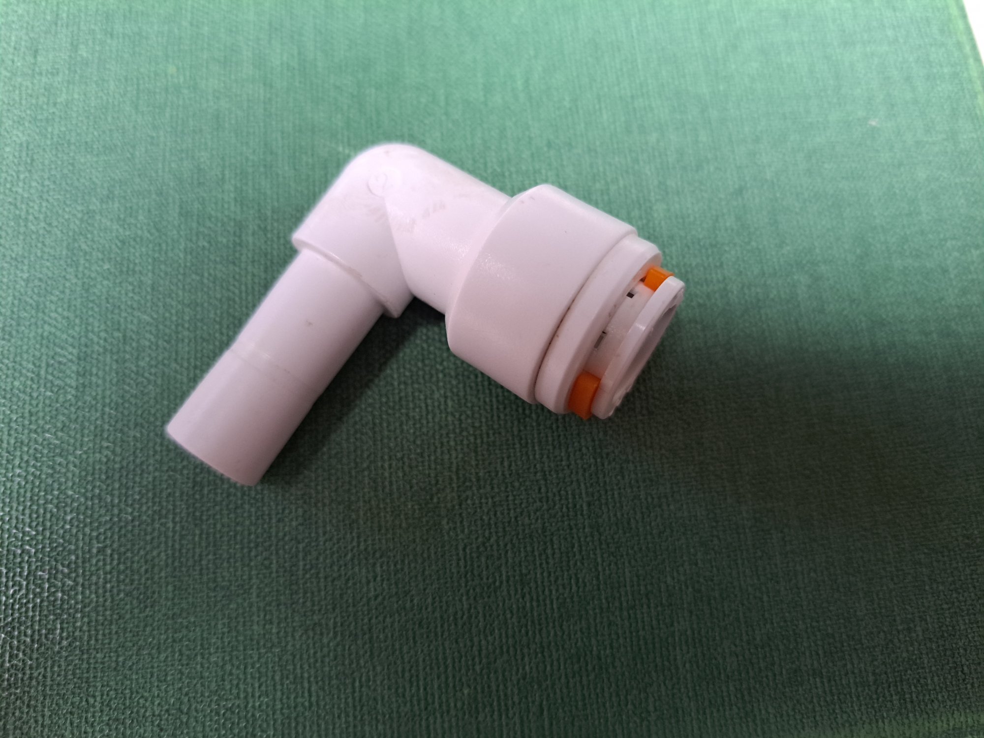

Thanks we have spent €7.50 and goodness knows how much in diesel & tolls to get a 12mm speedfit to 15mm pushfit. The pushfit doesn't have much for the jubilee clip to grip so we are trusting in our bodge, with this as a back-up.Hope you get sorted.
