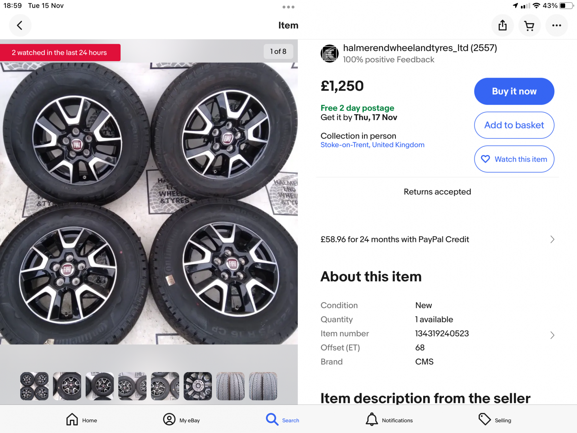

Potential spares here Simon?

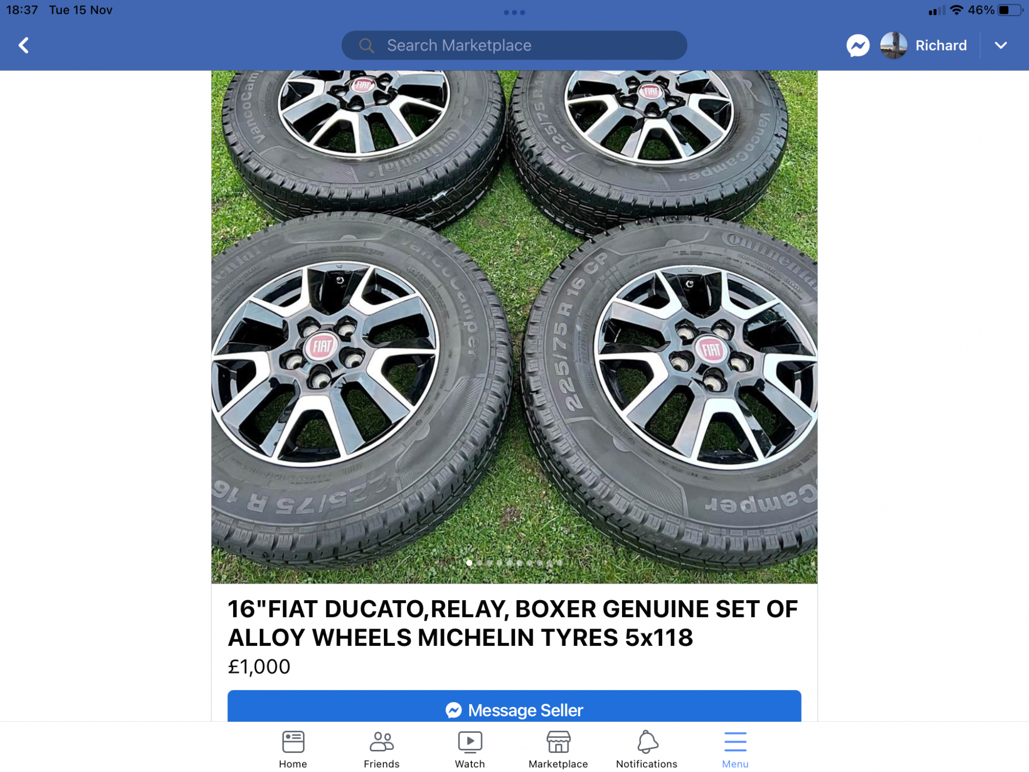

I have just seen these on fb market place
