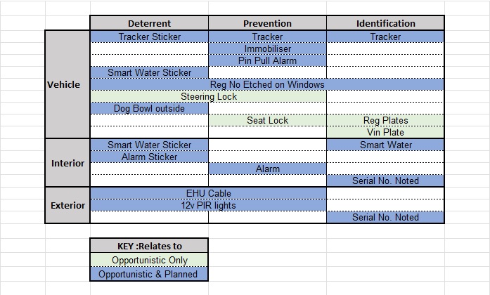

A few thoughts about security.
1) Security has three objectives.
Deterrent - to make them try elsewhere.
Make sure suitable devices are visible and use stickers when available
Dog bowls with Food & Water in it and a "I live here" sticker are possibly the most cost effective security measure.
Prevention - to stop them from stealing the item
Identification - To aid recovery
2) Some thefts are opportunistic. A friend left the hab door open whilst having a drink in the sun of the opposite side of the MoHo, someone got a free TV
3) You need to consider security of:-.
1) Vehicle: e.g. tracker / immobiliser / Secret switches / fuse removal / Locks (seat or steering or pedal ) / Pin pull personal attack alarm
2) Contents. e,g. Movement detection alarms (make sure it has a nigh time(or perimeter only) mode. / Marking (I use smart water) / security
3) Exterior. Seats & Trailers etc. e.g. Chains & Locks / EHU cable (thread it through outdoor items so theives have to unplug the EHU which activates the power loss alarm).
Security Audit
In general terms the more security the better.
It is an individual decision on our much security you have.
Some of the factors in this decision are depth of your pockets / type of sites used / storage location / value / attitude to risk,
It is worthwhile doing an audit to see what you have addressed and what you haven't.
This is an example of a Security Audit, if you disagree with my view on what doess what that is fine.

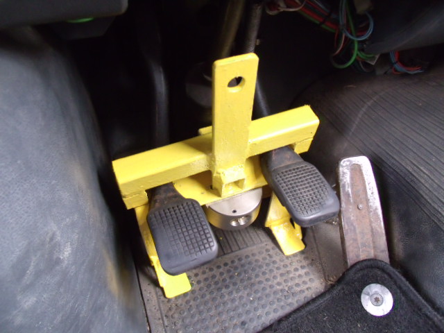

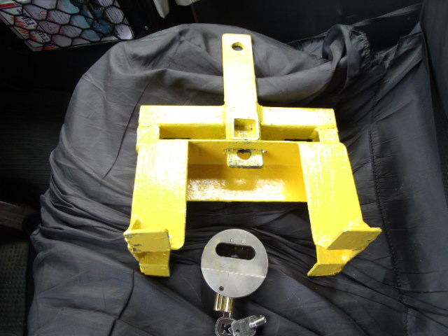

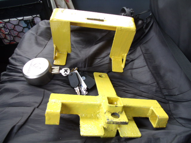

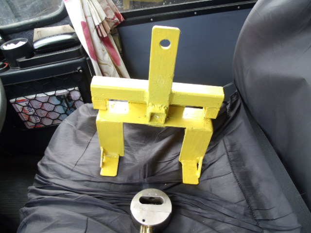

Made my own pedal lock but you can buy them with an inbuilt safe section, mine also has a ring for h duty chain to go around the s wheel, though they can cut a section out of the wheel, but along with the pedal lock i think they will move on to another.
