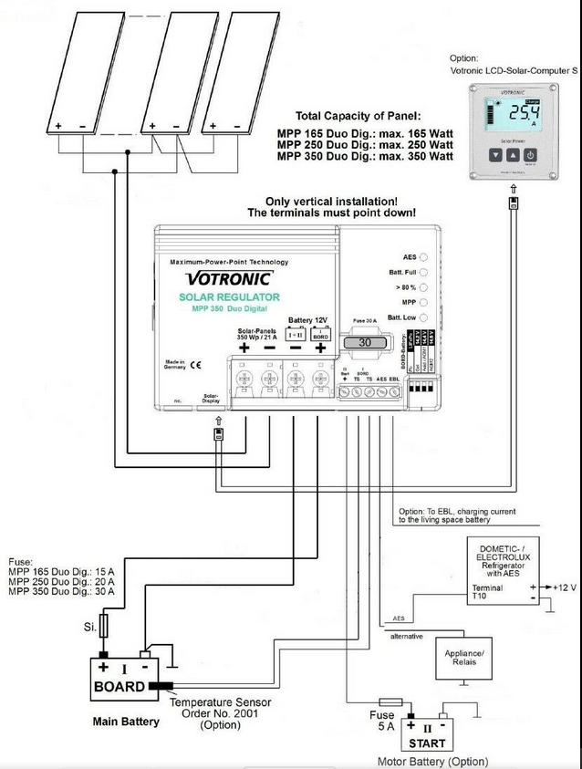

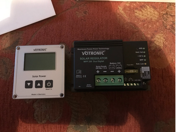

A votronic mppt regulator will take up to 50v, it also has a 1 amp blead to starter battery, depending on total wattage a 250 will cost about £140, there are also others out there, some a bit cheaper.
