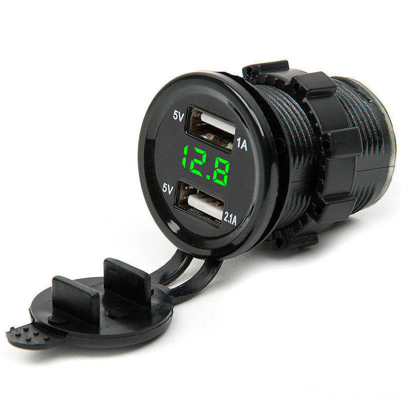

If you find the only purpose the cigarette lighter has is to fit a USB chager adapter then it would probably be worthwhile to replace it with a dedicated USB Outlet. Usually very simple to do. I replaced the Cigarette Socket in my LT with a combined Twin USB and Voltmeter so I can keep a little eye on the Starter Battery while in the drivers seat.

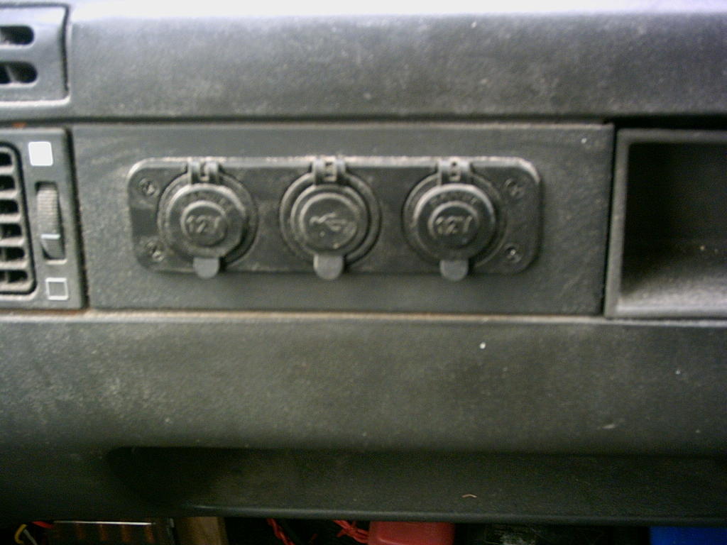

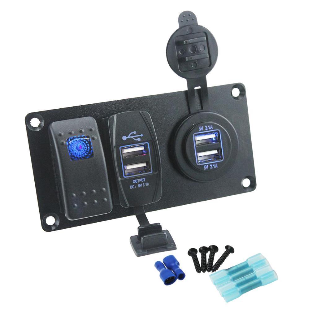

These,proper job

I've been buying these for ages, I just leave them fitted if I sell the van, cheap and cheerful, not had a failure yet, the rectangular mounting plate is removable.
12v 24v car caravan motorhome lorry motorbike boat lorry usb socket DIY | eBay

This is how to do it properly. I've used these for years, none have ever given a problem ( though possibly not from this seller)
eBay
I have the same unit to drive my Raspberry Pi (needed 3A and most sockets are 2.1A max) and working well :)

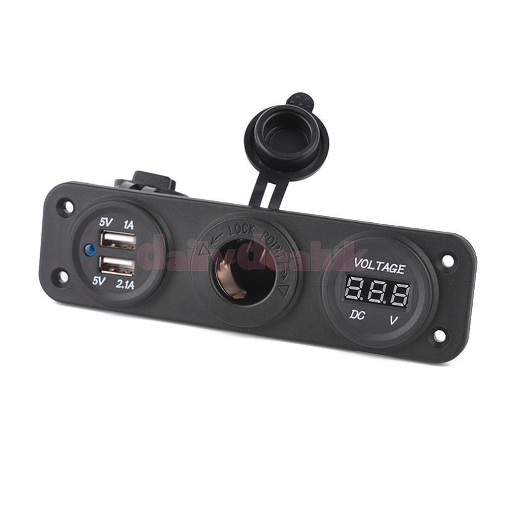

I also bought a plug in one about 4 years ago so nit in my purchase list, a 2xUSB with a Volt/Temperature/Amp readout tells the LB volt, cam temp and the amps the USB device is pulling, this too has just worked, I can post a picture if requested.
Looks useful I just have to workout where/how to fix it
Just looked I have a redundant ashtray next to the existing cigarette lighter which looks about the right size
I think it might also help with the pathway fro the wiring !
Link is here
12V USB Charger Voltmeter Cigarette Lighter Power Plug Socket Car Boat Motorbike 6263943453010 | eBay
