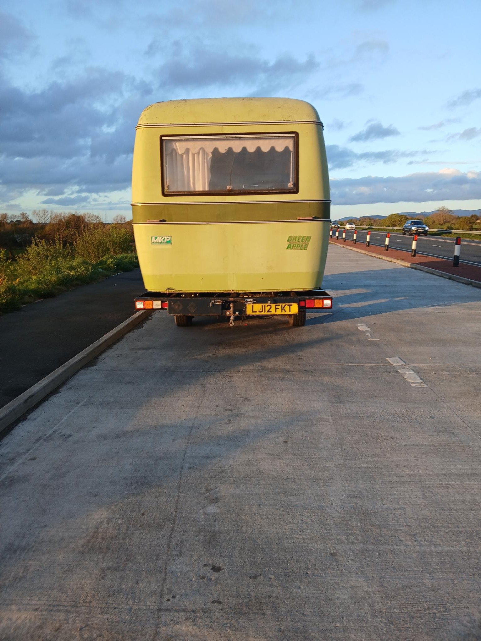

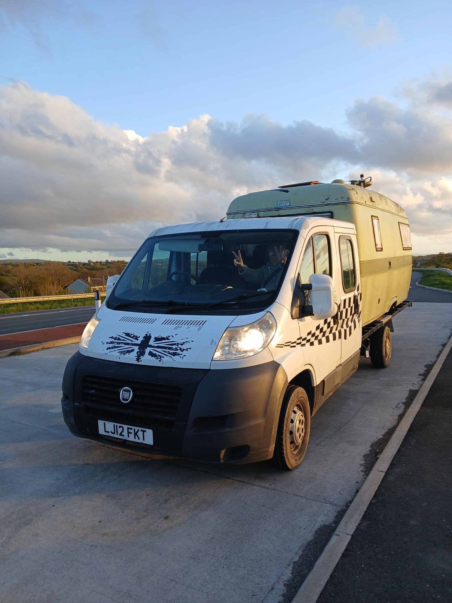

Hi folks. sorry if the following is boring and I have looked around already to see if an an
swer already exists, but I have an unusual problem re changing my classification to motor caravan. I have built a motor caravan by bolting a rare MKP caravan bolted onto the rear of a 2012 Fiat Ducato 7-seat crew-cab. I think you'll all agree that it certainly looks like a motor caravan, and of course, that is exactly what it is as itis a caravan on a motor vehicle.. However, it is currently registered as having a body type of 'Flat Lorry' on the V5c and the list that DVLA give as types of body that can be converetd to a motor caravan excludes this body type, what am I supposed to register it as. It obvioulsy is not a flat lorry anymore, but neither is it any body type on their list

It seems that there is not much benefit to registering as a motor caravan re speed limits etc anymore with teh latest info from DVLA being that it is what it is being used for and looks like to law enforcement agencies etc. that is important, (happy to afix decals it has an awning rail etc) but I have to presumably change the body type to something other than flat lorry. Hellllllllp!!!!!!!!!

Thank you for your erudite and considered response. I haven't asked DVLA to reclassify it yet; if you'd read my post properly, instead of scan-reading and looking at the picutres, you'd have known that. BTW. It isn't finished, it isn't painted to be colour matched, the awful Union Jack and other decals has not been removed, the side bars and lockers are yet to be put back on and frenched in, the wheel arches panelled in etc etc. Those pics were taken the day the bare MKP was bolted on. I didn't attach the pictures to show it off and have my ego stroked, but to indicate to people who might be able to help with my query of what was in progress. Here I was thinking I'd joined a forum where open-minded motorhome builders, who 'think outside the box' would support and encourage each other in building vehicles, even ones we may personally think are odd, unusual, and "not what I would do". No questions from you about why I needed a crewcab vehicle, why I've chosen to make a motor caravan in the way that I have done, what am I going to do to finish it, how we managed to lift the caravan up high enough to fit it, etc. I accept it is a completely different approach to the one you have taken with your smart-looking luton conversion, (all power to you BTW), but I personally am not fightned by 'difference'; maybe you are.
