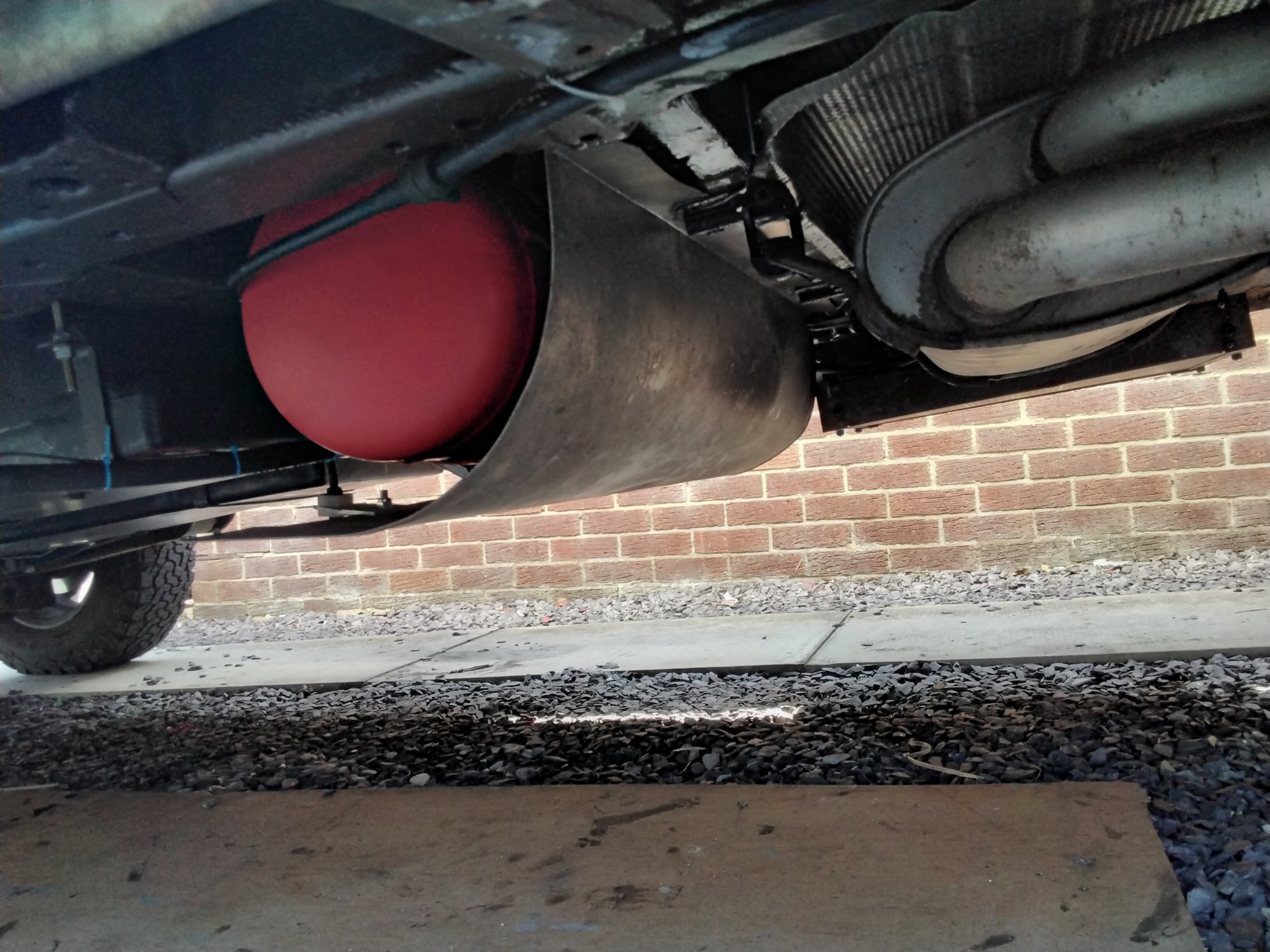

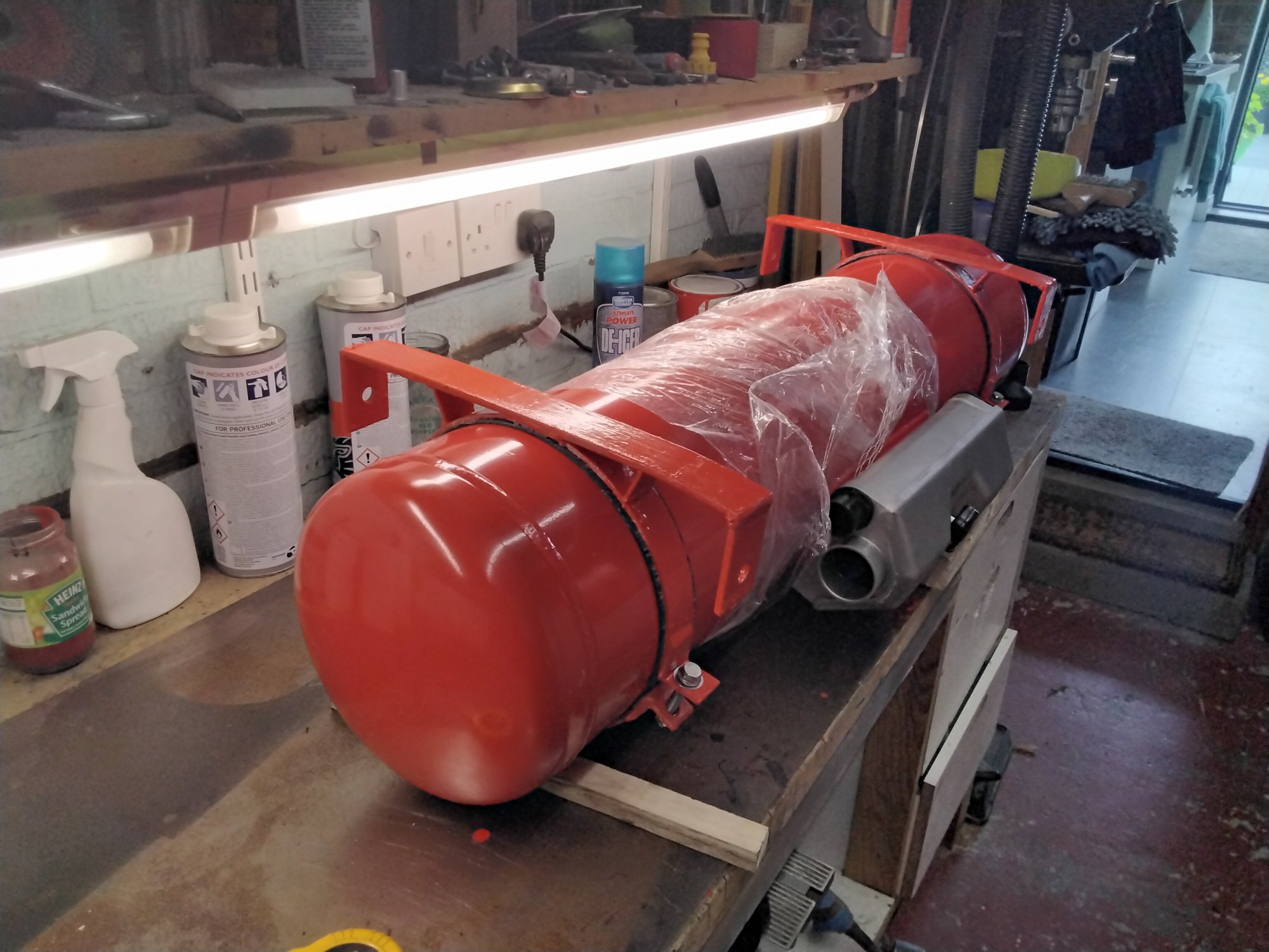

I fitted a new tank about a year ago but before I did I gave it two coats of zinc primer then two coats of white underseal + one coat of red paint + I have a huge alloy shield in front of it to protect it from stone chips.Ive put rubber inserts between the tank and the straps.
Did you shotblast it first and then use 2 pack zink, not the cr-p you buy from motor stores.
