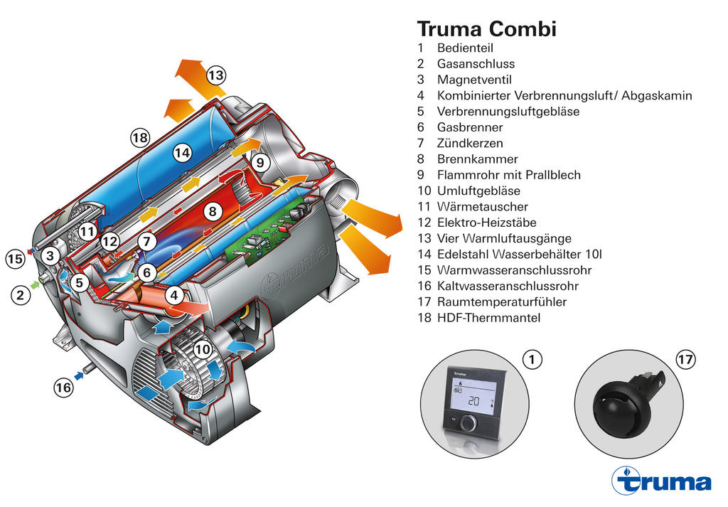

It's down to the design of the system. The heating elements are in the center, then the air ducts and then the water tank. So if the heat is on the heat has to go somewhere. If the blower is on it comes out the ducting and heats the water otherwise it heats the water if the fan is off. It is therefore impossible not to heat the water unless there in none in the system but can you use it without damage with no water.
it's quite logical ....if you put the heating on part will come from the hot water
It's down to the design of the system. The heating elements are in the center, then the air ducts and then the water tank. So if the heat is on the heat has to go somewhere. If the blower is on it comes out the ducting and heats the water otherwise it heats the water if the fan is off. It is therefore impossible not to heat the water.
