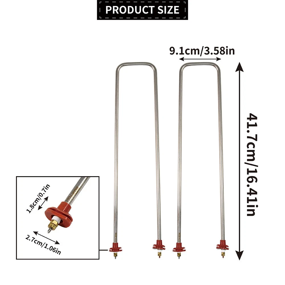

Does anyone have an original element in their shed for the combi 6 that they could take dimensions from, i have a company in Scotland that is going to look at manufacturing some for me.
Taken from an Ebay ad for Truma Combi 6 replacement elements Sam;
Feedback seems good although one reviewer said he had to cut back the thread slightly. Other reviewers said that they fitted perfectly.
https://www.ebay.co.uk/itm/28551196...id=10001&customid=eb:g:vms:eb:p:285511961550;{GCLID}&_trkparms=ispr%3D1&amdata=enc%3A1iKCCZ4g2RtOmQfa3axt-YQ37&adtype=pla&loc_interest_ms=&loc_physical_ms=9046204&gbraid=0AAAAADmMgigiv2Wue3u0MgLJ9-3YIjhE1&gclid=CjwKCAiA3-3KBhBiEiwA2x7FdDGIsVurvkGJJerqPCvSjdhdYb_I4LGsORVL_xhNyQAnyeVPEHqWZxoChKoQAvD_BwE
I thought i read the element was 20mm too long on one review.
Haven't seen that one Sam but you need to be sure if getting a few manufactured.

They look like the elements have the same rating as the 4e at 900 and 1800w on elec so if it's pulling anything around 1800w I would think they are both good. It does seem to take an eternity for them to get any sort of heat into the van when just on elec, when everything is down at freezing.
I assume these are being specifically designed to operate at the high sheath temperatures of dry elements not at the lower temperatures of wet immersion heater elements. I believe the Truma elements are made with high temperature alloys unlike immersion heater elements.
It would have been inconel, they can manufacture but not with these ends. I have found another UK manufacturer who produces them if I do need to replace.
