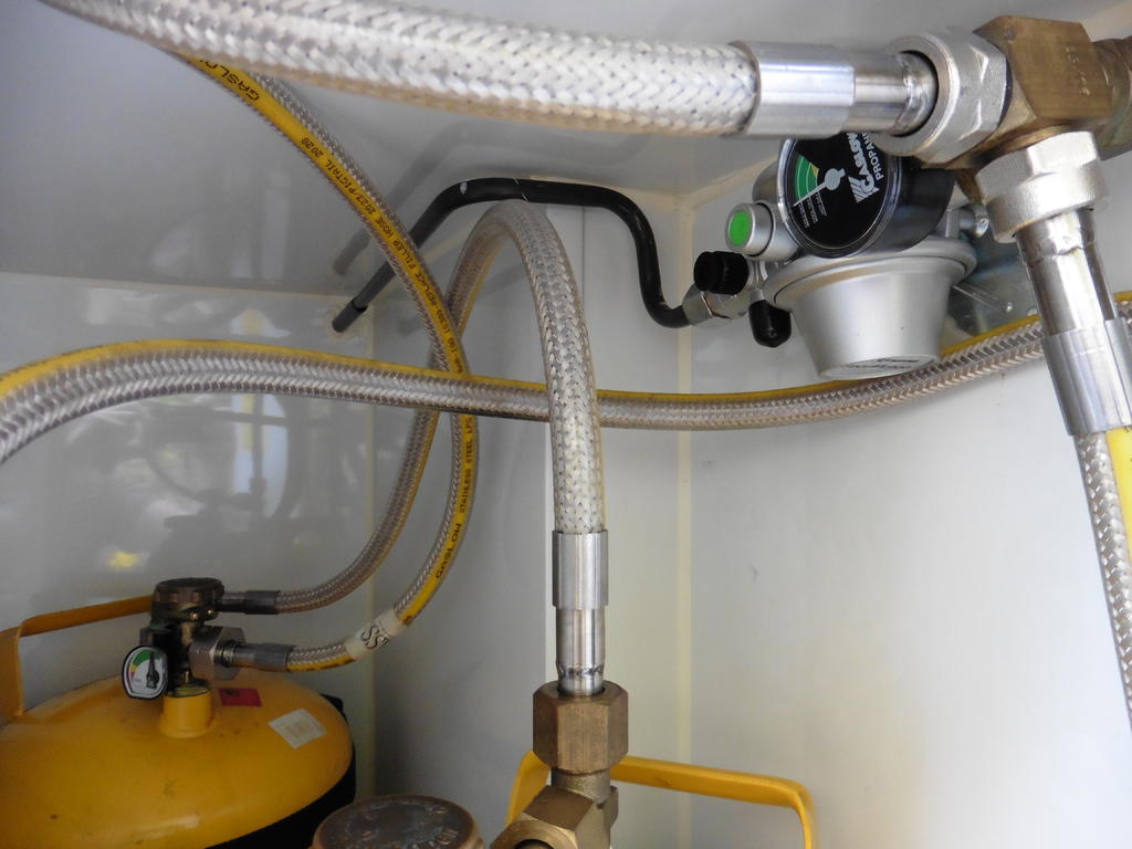

As far as I am aware there are no filters between the Gaslow cylinders and the regulator. Each cylinder is connected directly by a Gaslow hose to a Gaslow "T piece" pressure gauge which is screwed directly onto the regulator. Here's a photo of the system:
I notice that your regulator is a lot higher above the cylinder than mine, whereas, mine is just slightly higher. I wonder if this could be a factor?

Is your regulator quite a bit higher than the cylinder, like in the picture Roger has posted?
You could be right. I have 7Kg cylinders which are much less high than your 11Kg ones. Is it possible that when your cylinders are full liquefied gas could get up into the regulator when cornering/braking/going up or down hill? If this happened could it clog up the regulator?
I think it could Roger. The regulator was originally connected to two 7kg bottles, I replaced one for a 11kg but didn't move the regulator up because it was still above the cylinder - just. It may be best to raise the new regulator and fit a couple of filters as a secondary precaution.
Not as high, my gas it bottle is the biggest I could fit in the locker the regulator is only a bit higher than the top of the bottle. Bearing in mind the bottle design is intended to guarantee only vapour take of it seems odd that a non vapour is carried of with the gas. A more likely scenario is the gunge condenses out in the connecting pipe and gets carried into the regulator that way. It is also a good story to cover bad design, after all in the days of bottle mounted regulators this was never heard of.
