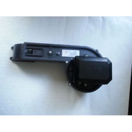

Is there a delay between you turning it on and the Clik say about 30 secs. If so it maybe the combustion air fan located at the very bottom of the heater some times a foreign body may jam it a sharp tap with a say screwdriver handle may just start it mine did for a while but eventually had to replace it heres what mine looked like so you know what to tap

Yes the fan I eventually replaced was light enough for something like that to jam my vent is the round type I made my own cover as not designed for one used a short piece of 4" drain pipe with a split clips on and stays there

Firstly didn’t realise a fan existed…never hear one…

You won't have a fan unless your Truma is also a space heater, I think your's is just a water heater.
