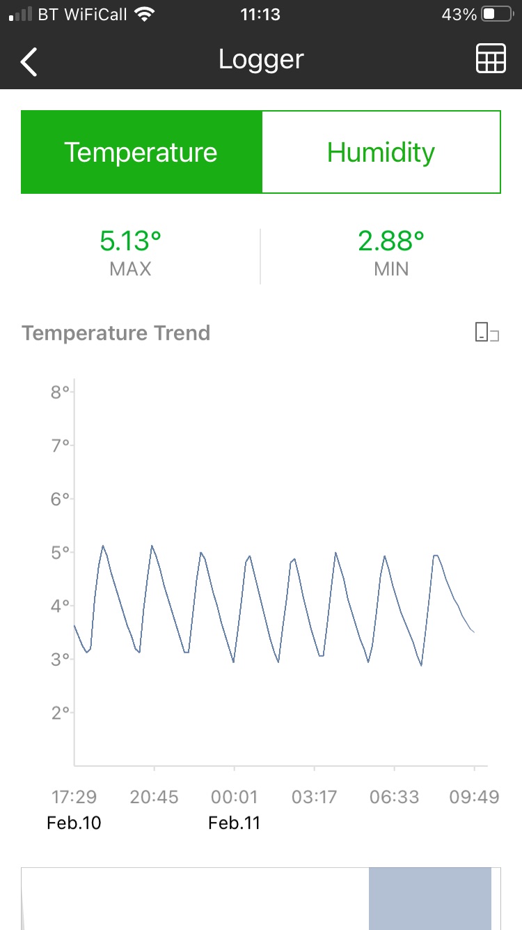

Depends on the system I suppose, there will be a hysteresis for on and off, on my PVC I have a Whale complete heat thingymyBob I recorded it at various settings to understand what illuminated bar equated to a temperature as they are not numbered. See attached picture which I took of it on the frost setting, you can see the off and on cycles, it heats to 5c then drops to about 3c before cutting back in again.…
