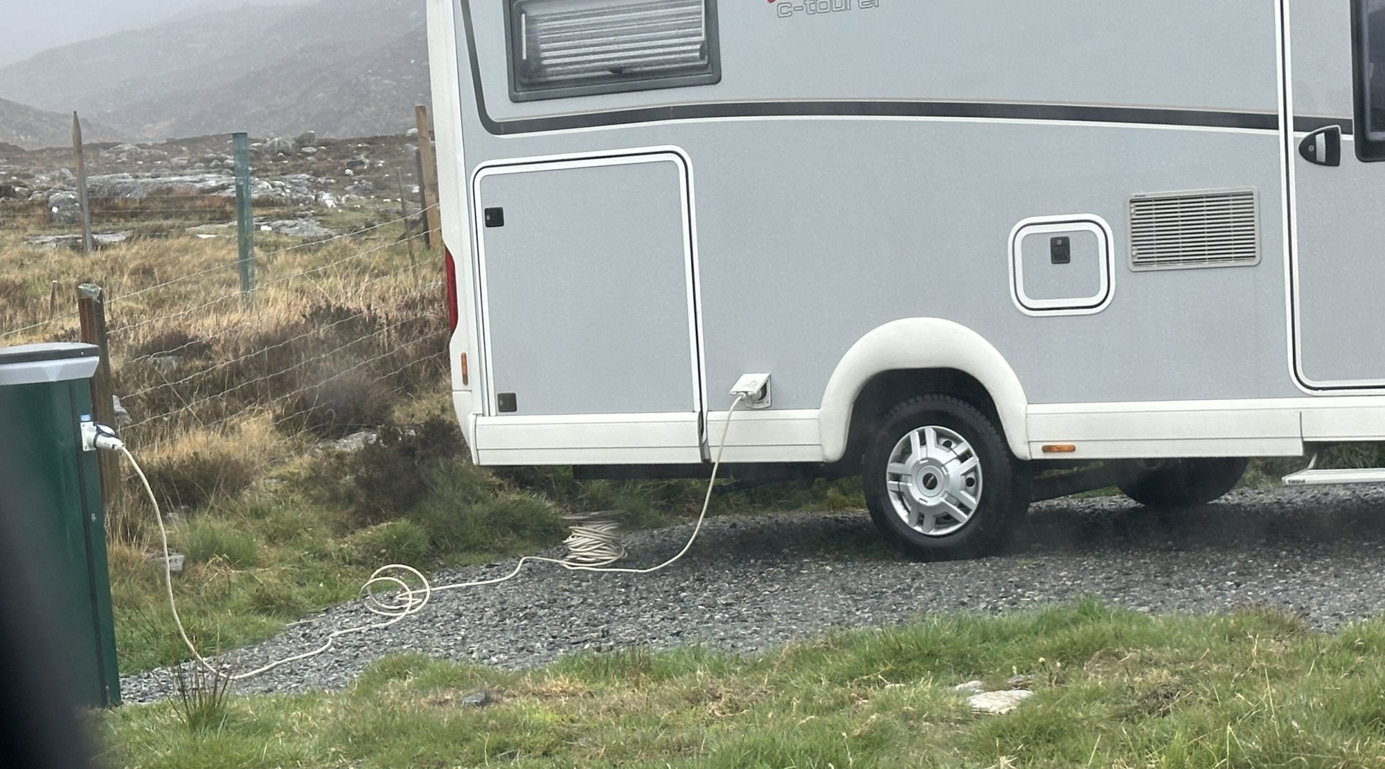

I am currently on an Aire on Harris. In the photo below the van next to me is connected to the mains with a cable which appears to be below required rating, and left tightly wound around a drum. I see this all of the time. People are either ignorant of the risk, or can’t be bothered unraveling the cable. Using a cable which is properly rated like this can lead to fire, doing it with a cable below required rating increases this risk. I thought this was worth a mention.

Oooh, wait until he's had his 3Kw electric heater running all night, you'll be able to pull up a chair and toast your marshmallows off of that reel in the morning Bill.
Have you been and spoke to them Bill? Awkward I know but that looks like a thin cable. Whats the ampage?
I may do so Barry, but honestly I see this all of the time, even on club sites where you think the wardens could highlight this to their customers.
Sadly many moons ago I attended a fire where two students lost their lives in a fire caused by this. They were probably ignorant of the risk, maybe this guy is to.
This needs to be highlighted more than it is currently.

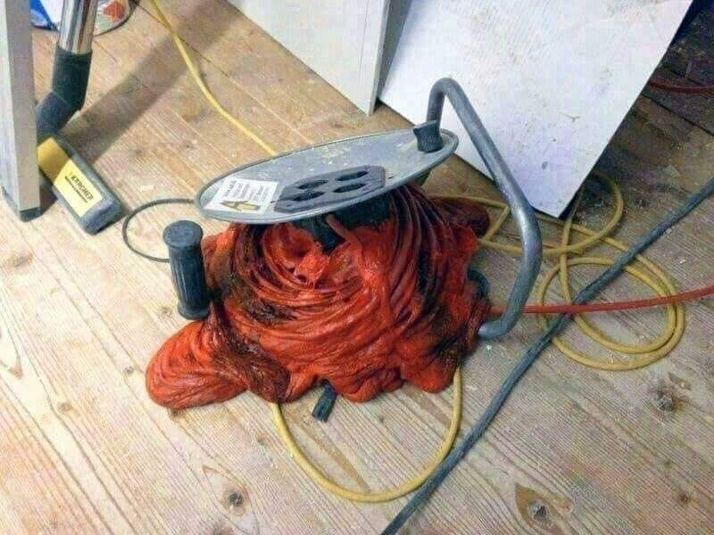

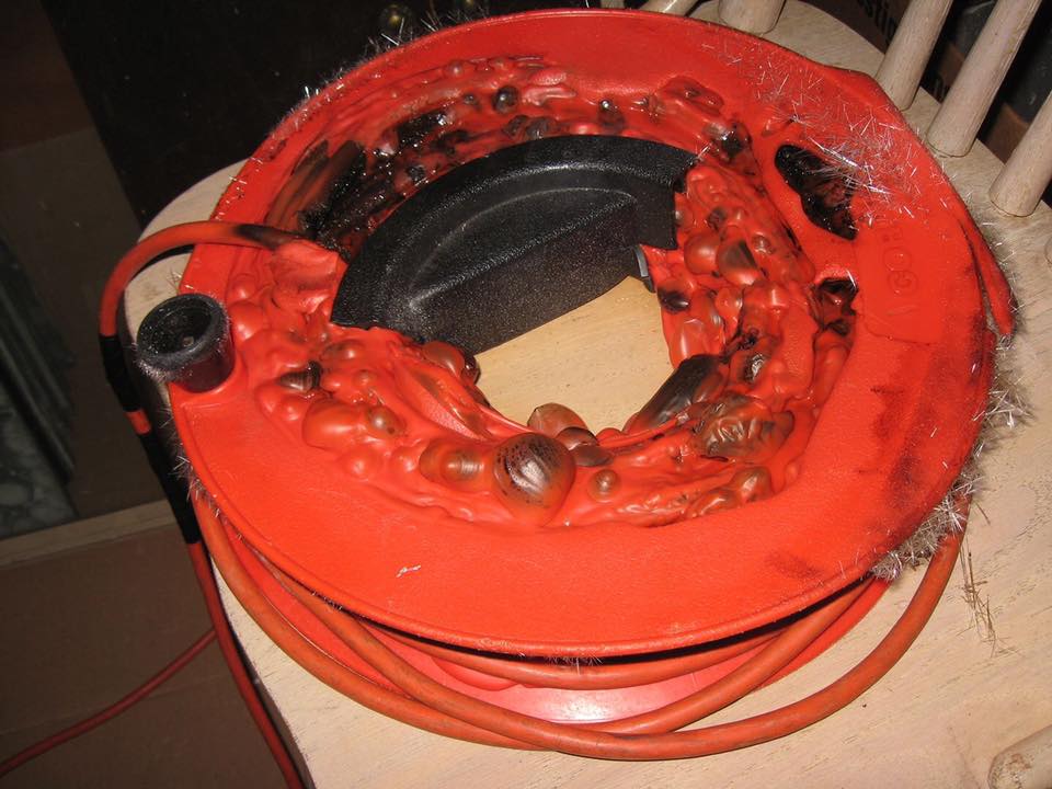

So, I got the call, "the heating's packed up".
Well of cause it had, after all it was a week since W-B serviced it, and that usually happens. :mad:
Anyway I go over to see if it was something simple, as soon as I walked in the door I could smell hot plastic, yes BiL had plugged an electric heater into a almost fully wound cable reel, which of cause begs the question "why not plug the heater straight in the socket", which I did ask and got no sensible answer., so I explain why not, and got him to touch the reel which was pretty hot.
A about a year later I get a call from SiL who was visiting, "the heating's packed up over here", as I was about to end call I thought to ask if the electric heater was plugged into the cable reel, what do you recon?
