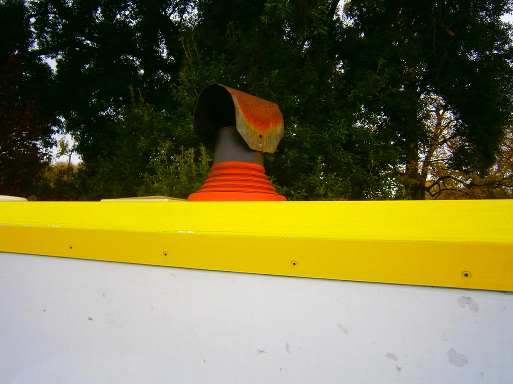

is the flue coming out the back ? why not through the roof ? never seen it done like that, out the side occasionally, but not the back. does it draw OK ?

Has a detachable chimney that fixes onto the back. Tried it without one night when was feeling a bit lazy, and no, it doesn't (cough cough cough). Not sure why its done that way, maybe stealthier? Or a bit easier to install as you wouldn't have to worry as much about a neat seal as you would coming vertically out of the roof leakage wise?

coming out the roof isn't hard,with a silicone flashing , and you wouldn't need to put the extension on every time you use it. you need to have that upright length of pipe for the flue to draw, but it could be a pain if you have to move on after lighting it
Yeah that's been in the back of my mind a bit - so far its been warm enough that whenever I've been overnighting somewhere that I'm not quite as sure about I've left the burner off, but can't really be carrying on like that in these sort of temperatures now. Not to mention nearly driving off forgetting it was still up there a couple of times.
make a hole about 8'' across, cut the silicone as directed, this will then be a stretch fit on the flue, making it watertight, then use mastic round the hole and screw the flashing down through the metal. then bend a bit of sheet metal and bolt it on to form a cowl P1010046.jpg
make a hole about 8'' across, cut the silicone as directed, this will then be a stretch fit on the flue, making it watertight, then use mastic round the hole and screw the flashing down through the metal. then bend a bit of sheet metal and bolt it on to form a cowl View attachment 48119
Sounds pretty straightforward that's great thank you! I suppose that I would have to put a ring of chequer plate or something heat proof around the flue where it passes through the insulation on the roof then. Would I have to leave much of a gap between flue and plate too do you think?
push the insulation back a few inches from the flue , just cut a flue sized hole in a bit of sheet metal, slide it over the flue then screw it to the ceiling, a gap of 3mm is enough, it gets warm but not enough to scorch, as with anything like this, keep your eye on the sure there's no charring going on !
