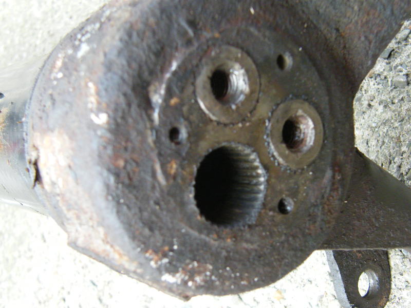

Ok set of with my sagging shed was ok on motorway after 200 miles I came off motorway hit a pot hole big crack wheel and swinging arm came out of round bit of axle till it hit body work, what a devil to get it on a tow truck!
back home now if the weather is fine I will pull axle off and see how this silly thing works, if it helps I will put pictures of innards on here any feedback would be appreciated. also any known scrap yards etc for replacements.
Ok pulled the swinging arm out ot the axle this one has 3 round torsion rods which I was not expecting from what others have said, all three snapped which is why wheel slid out against body work seems this is the strong version ha, how the rods are fastened in the middle I have no Idea, if welded it would seem I am stuffed have taken pictures for anyone interested all comment appreciated I think!
