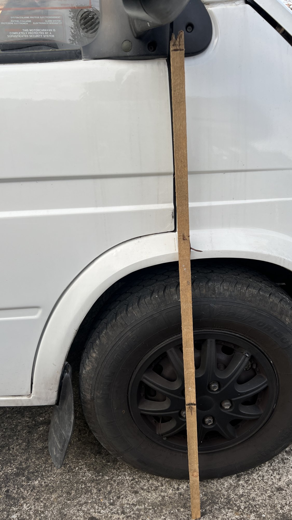

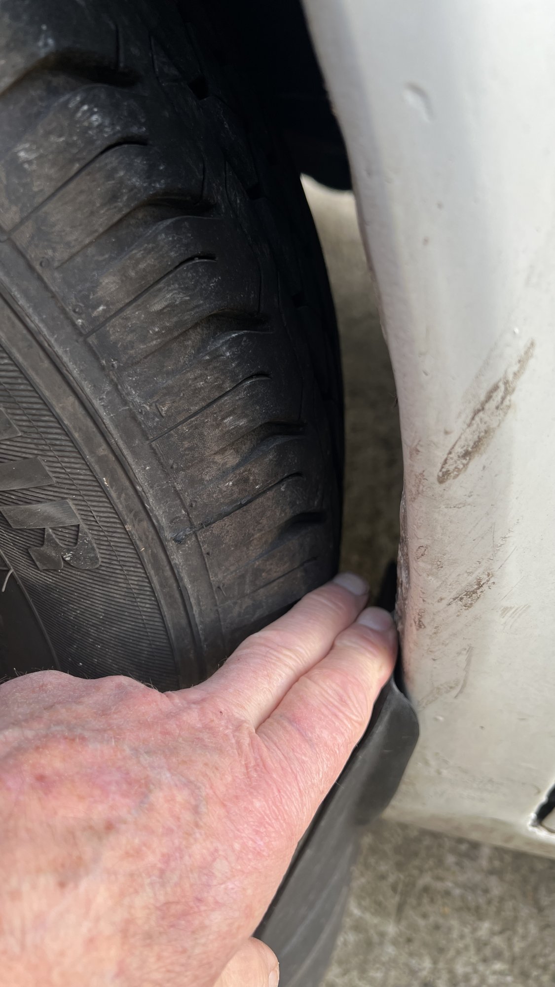

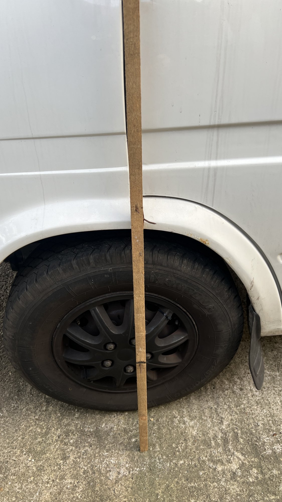

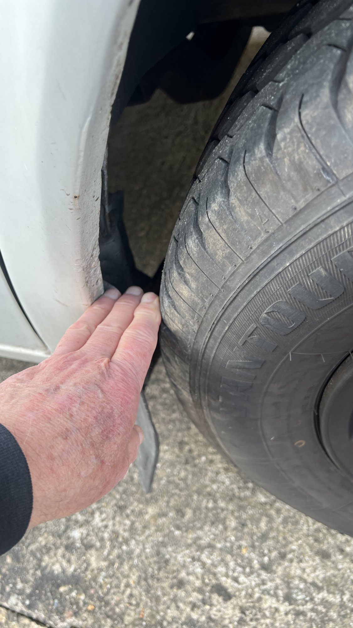

Then I stood up, puzzled and wondered if the driver's side wheel was the same, but if it was, why didn't it rub? I noticed that the door / front wing line is vertical and dropping a plumb line down the join would enable me to compare the passenger side with the driver side so I got a big stick and held it against the vertical door-to-wing joint. On the passenger side with the rubbing tyre the line cut through some of the wheel nuts. On the driver's side, all the wheel nuts were forward of the big stick. So the passenger side wheel is probably one inch behind the driver side wheel. The gap between tyre and wheel arch on the driver's side is three fingers wide. The gap on the passenger side is less than two fingers wide.

Something is not correct on your van, has it been hit at some time, tape messure back to front from wheel centres both sides to see if the same distance.
In your pictures with the length of wood the alignment is not the same with respect to the leading edge of the doors.
If it was it would probably match your verbal description.

View attachment 141200View attachment 141201View attachment 141202View attachment 141203
It looks to me like in the top pic the wood is on the door side of the gap and the next it is on the wing side of the gap so expect a difference the width of the wood
Would that matter Kev if you follow the left edge of the wood on one pic and the right on the other?
I don't think it matters, I could have used a piece of string and a weight.
