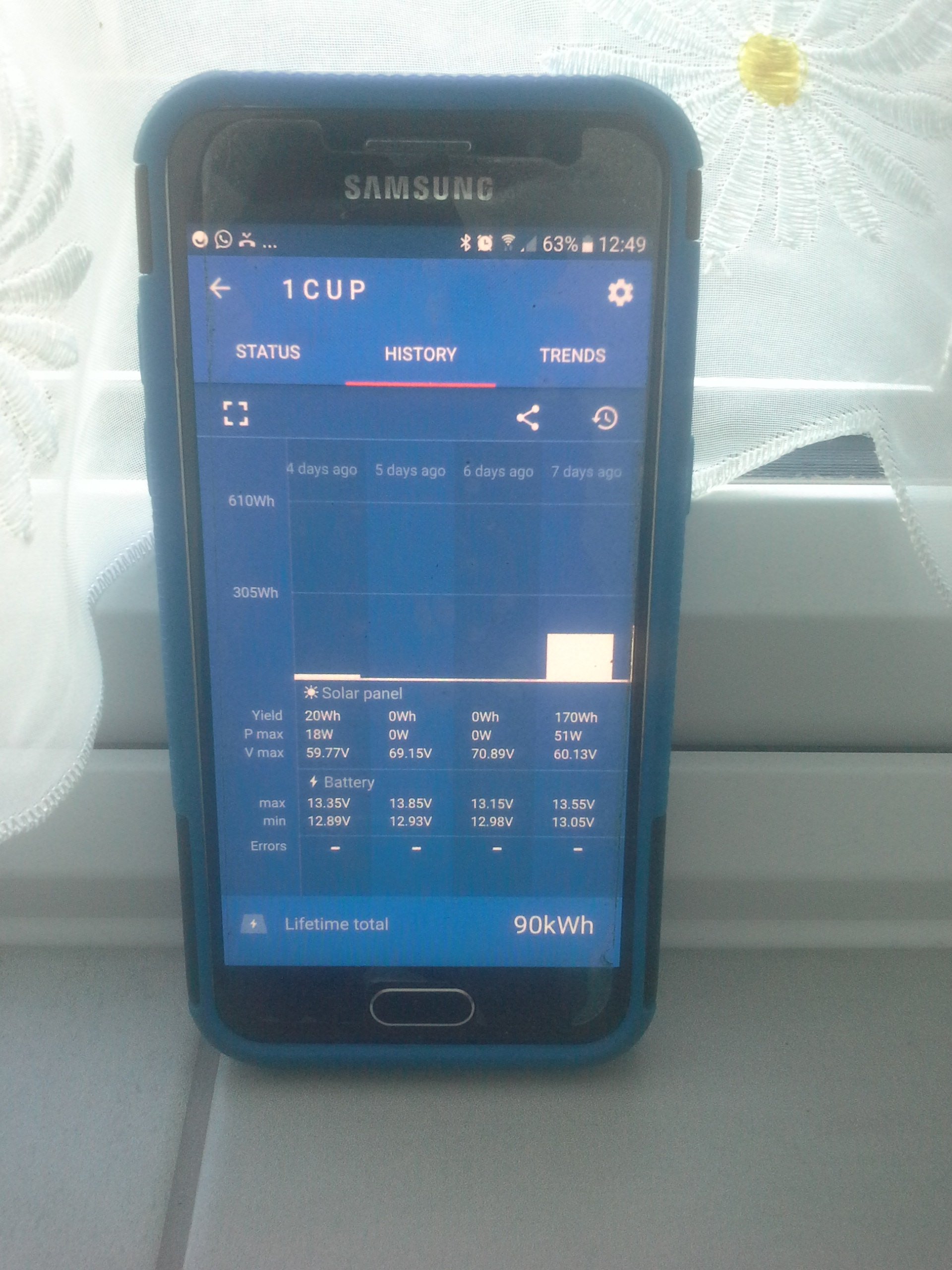

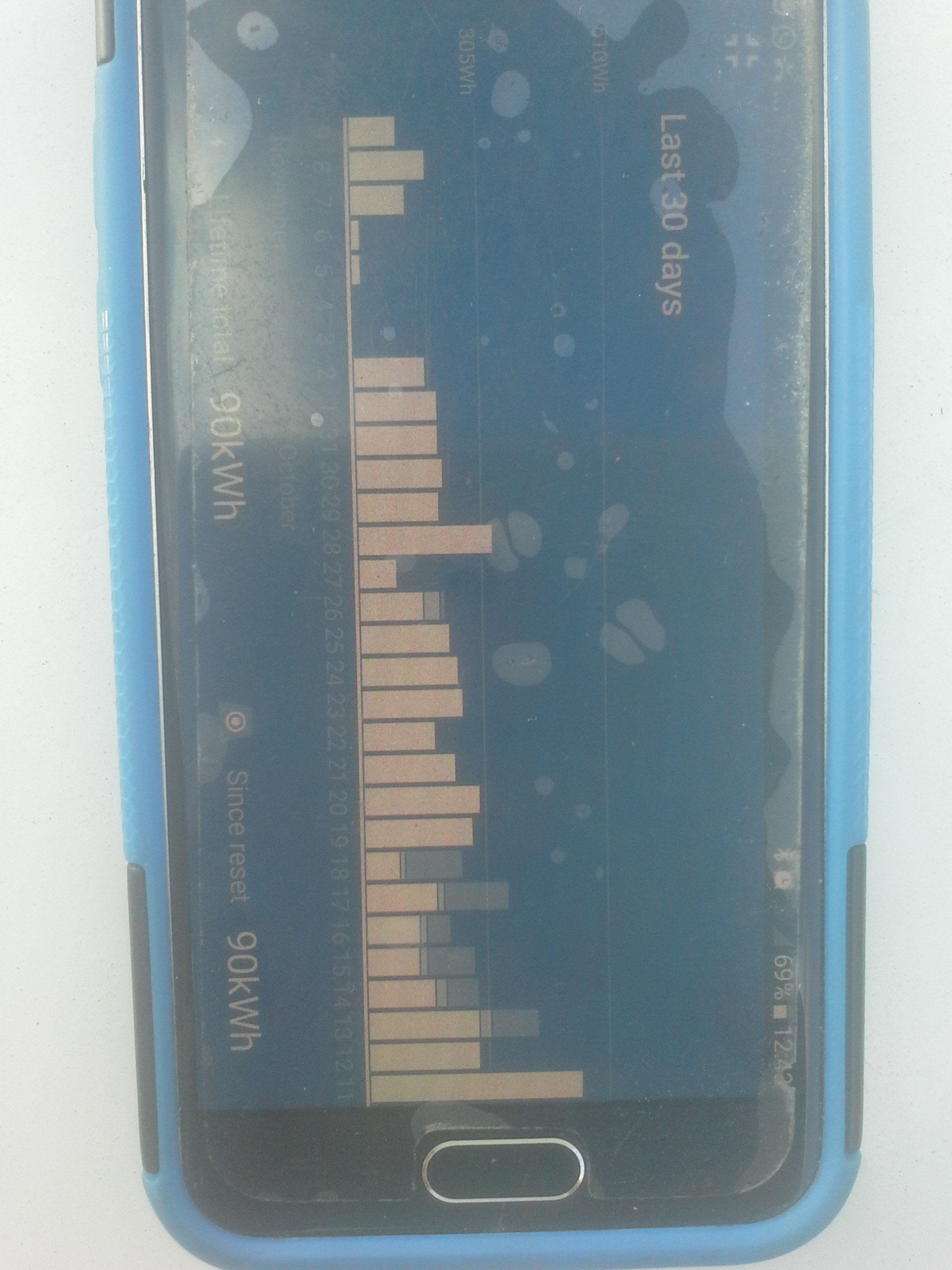

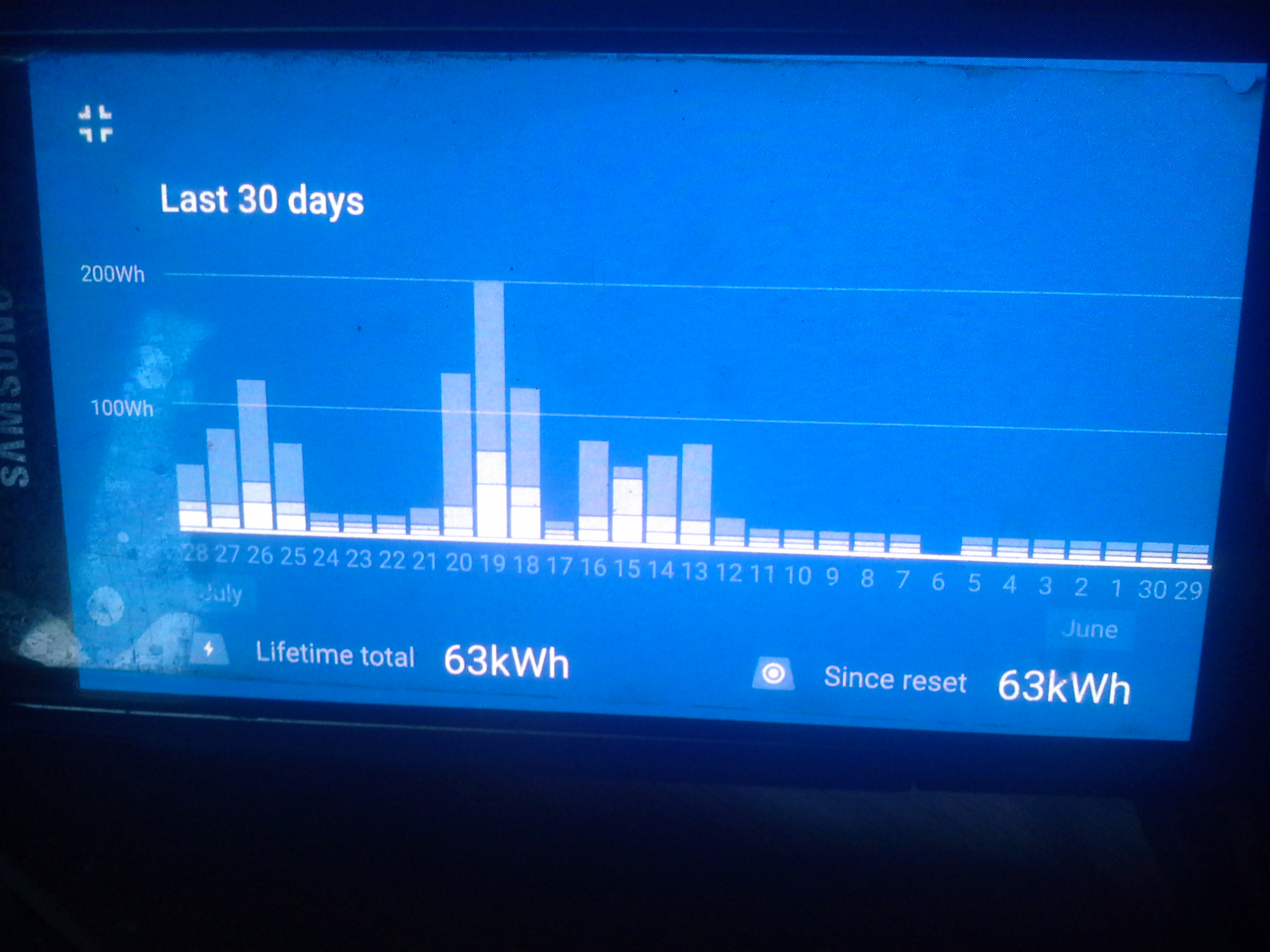

Have you up graded the software as I have .? Last weekend 3 blank days ! I dont have temperature on mine.
100 30.
But it started on june. 6th its just blank .....
Just a pic of blank days. Mines just blue tooth
