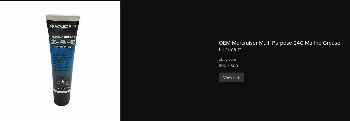

Anywhere there is water spray try using 24C Marine grease with PTFE.
