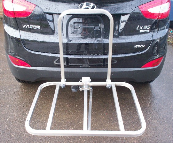

Out on my travels today I spotted a van parked up with a Bak-Rak towbar platform and it had a Solent lockable box attached.
Way more secure than a Fiamma box setup and considerably cheaper.

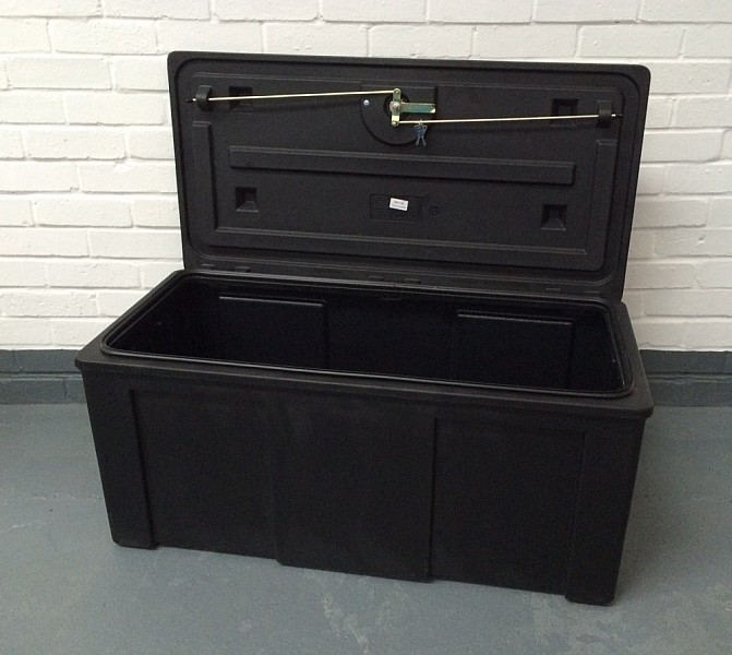

961053AF-1445-4C4E-841B-15C350C78D34.jpeg approximately £120.00. Heavy duty, locks and rubber seals to lid so waterproof.

Any members use a Bak-Rak or Thule easy base which is very similiar ?

Wonder how the Solent box fits onto the base. Any idea?
Easy, the Bak-Rak has holes in both the base cross members and the upright so it would just be a matter of drilling corresponding holes in the Solent box base and back then bolt together preferably using nyloc nuts. I always use oversize washers when bolting plastic to anything to spread the load, easily made out of Ali plate or similiar.

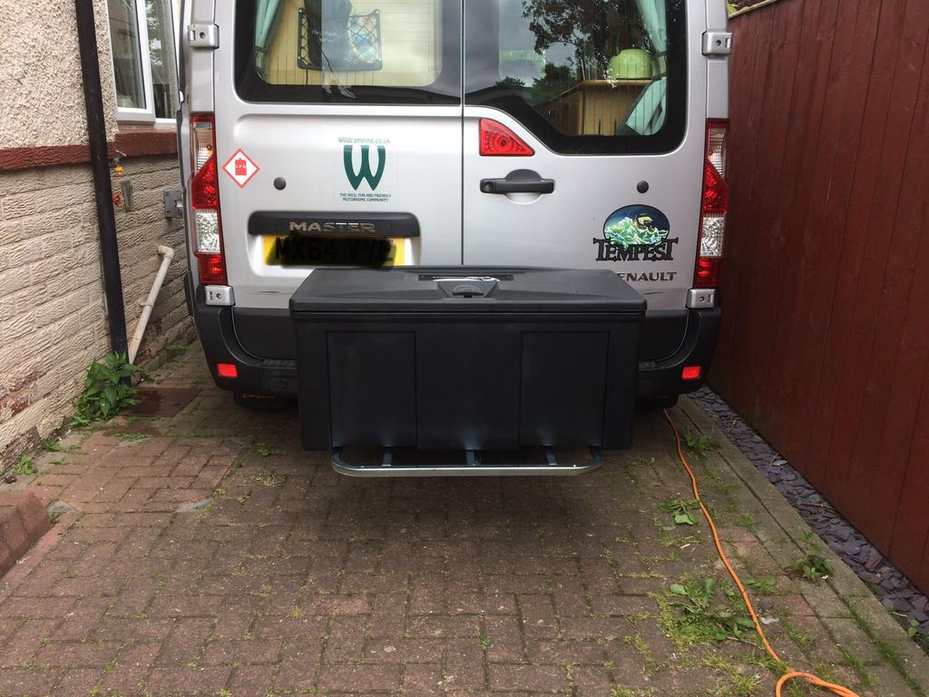

Towbar, Bak Rak and Solent box all fitted. Bonus is my number plate is more or less visible so not going to fit a number plate high up as I previously planned. Any comments regarding number plate ? I reckon I should be ok.
Have to say impressed with the Bak Rak and box, both sturdy and watertight. I have put my interior and exterior windscreen covers, 2 x chairs, camera tripod, hose reel, ehu cable and a few other odds and sods in box so loads of space freed up. Well pleased with result.

Unfortunately not. The platform does drop down but with box attached not enough to clear doors.
I don’t use the rear doors much so was prepared to put up with that inconvenience to gain the extra storage.
