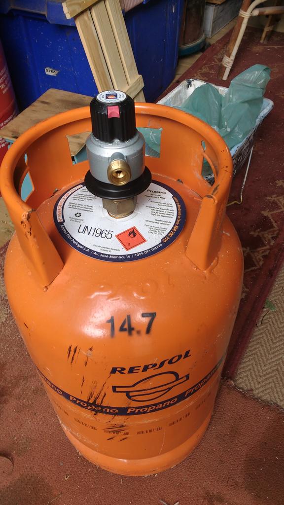

We are going to Northern Spain for October and some of November and were considering whether it is considered necessary to take an ACSI card for sites or whether to rely on aires? Last time we did this in Southern Spain we struggled occassionally to find reasonably safe aires. Also what gas connections, ie pigtails, for Spanish propane bottles. We live in France so we normally run on 2 x 13Kg French bottles going through a baulkhead mounted regulator. Although I think there is no way we are going to run out of gas on this trip, we will be going in January and February as well, so may well need to buy a Spanish bottle then. The only Spanish bottles I am familiar with have their own regulator and I would rather just change the pigtail if possible to our baulkhead reg but don't know what bottles would fit. Thanks.

Most spanish bottles have a clip on attachment either a regulator or just a tap easily available where you get the bottle your french pig tail screws directly onto it mine does I only use french gas but have a spanish repsol bottle to use in spain
The spanish thread on adap is the same thread the french bottle

Most spanish bottles have a clip on attachment either a regulator or just a unregulated tap easily available where you get the bottle your french pig tail screws directly onto it
Pic's are on and off the bottle
