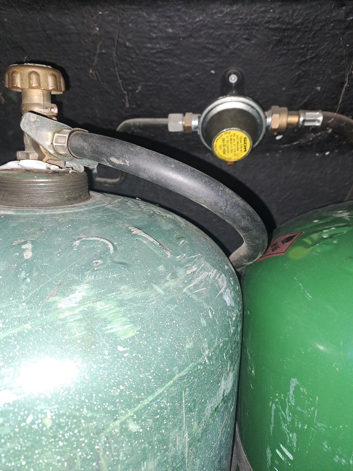

Preparing for a trip to UK. We will be in UK from the end of January until early March. We currently carry 2 13kg propane bottles. These are the Primagaz variety and are only available for exchange in France. We toured UK, mainly Scotland, last year in March/April and I made sure both bottles were full before we left France. We use gas for heating and hot water (Truma), cooking and for the three-way fridge which I updated to a Vitrifrigo at the end of 2023. We used CL's and the like occasionally but remained off-grid as much as possible. The Truma heater only runs on gas with no electric option.
I have acquired an empty 15kg blue butane Calorgas bottle which I plan to bring to UK and exchange for a 13kg red propane Calorgas bottle. I will leave one of our French bottles at home. I am attaching a photo of my existing gas set-up. There is a fixed propane 30mb regulator with a pigtail connector for the French bottle. I need to know what type of connection I need for a red calor bottle and how to make the connection to my existing set-up.
I am hoping someone has experience of this type of bottle and can advise me accordingly.

The UK propane bottles use a POL connection, assuming your regulator has the typical M20 thread all you'll need is a Pol to M20 (often called W20) pigtail.
The ones with a handwheel are nice because you don't need a spanner.

I am not at my house till later this week but I am pretty sure the fitting on the top of the calorgas blue 15 kg bottle is the clip on type. The 13kg French bottles are definitely the left-handed thread screws.
Thanks for this link. I will be buying one of these pigtails to use while we are in uk. This will allow me to use the bulkhead regulator you can see in the photo.

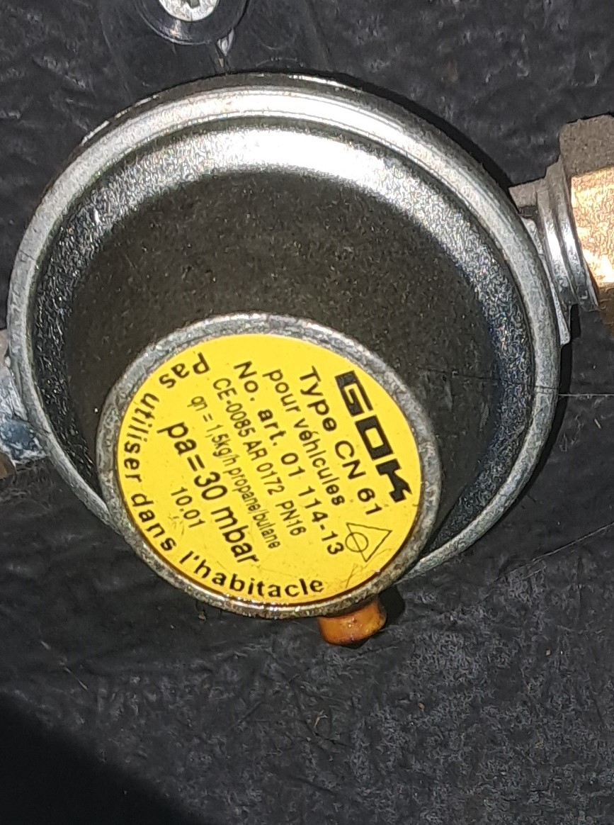

What's the practical difference between propane and butane. Apart from propane gassifies better at low temps. What's the difference between a propane and butane regulator apart from the colour ie can u use a propane regulator on a butane bottle, can we swop between propane and butane as and when we've got bottles to use up. In the past we've only used butane.
Our van actually came with a small propane and regulator connected to a copper tube on van by a rubber hose and jubilee clip. There's also a small butane with its own regulator and rubber hose. Can I just swap them over when the propane runs out..... We're only using a twin burner hob. There is a gas space heater connected in but we don't intend using it.

Typically butane uses a 28mb regulator and propane around 35mb so if you've got regulators that fasten to the bottle outlet you should use these values. However most vans have a built in bulkhead regulator that's midway between the two at 30mb so that either gas can be used using a flexible pigtail connecting the bottle to the regulator.
Butane through this 30mb reg will produce a little more heat than propane.
You're able to use propane at much lower temperatures because butane stops 'boiling off' at around zero Deg C as you say.
Here is my regulator pictured above. You can see it's 30mb and suitable for butane and propane. As the gas compartment is effectively outside the van, one should use propane especially in cold weather.
