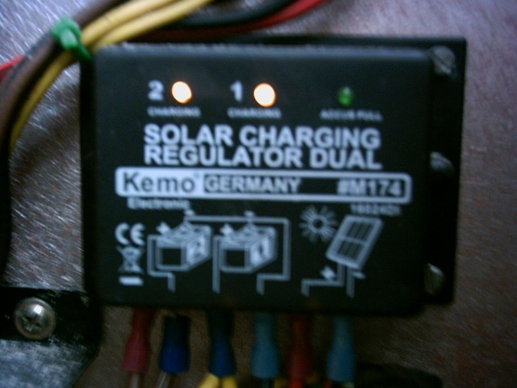

I have this set up which has a auto select battery charge so you can determine which batt you want as priority then it will pick up the second.I will take 16 amps which is about 200w.

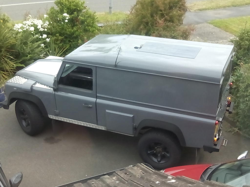

Most of you have more roof space for the solar panels. My 80 watt panel sits on the sloping bit above the front seats of my land rover series 2 but it does the job .
