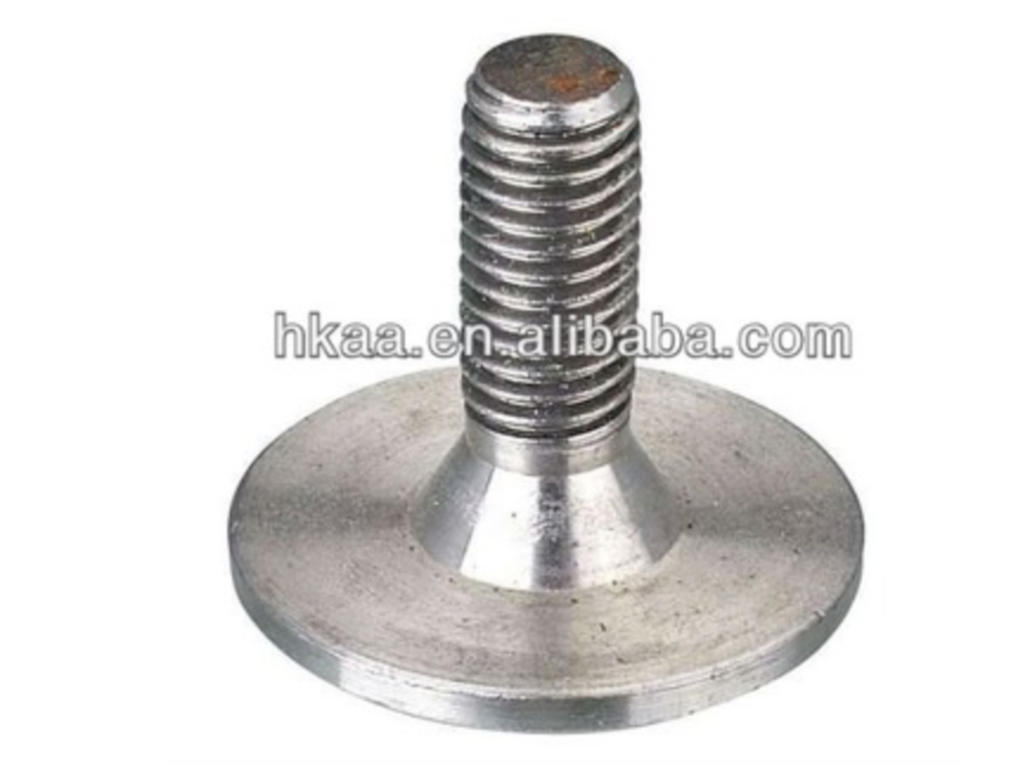

Anybody know where I might source nylon bolts with a flat bottom somthing like this one in photo I’m going to put some solar panels on that I bought last year the panels are decent quality stick down but have 8 fixing holes was thinking of not sticking them down but just using these bolts stuck to roof and sealing round the edge and fixing some sort of wind break flashing just before panel on front edge. 7BF0E674-85FC-4417-ADAB-3A63F275986B.jpg could do with the bolts having a bigger base as to give more sticking surface any help appreciated.
Can't you use the plastic corner mounts on you panels, I'm not sure you'll get enough adhesion using the fixings you've shown.
Not sure how rigid the stock down panels are but wouldn’t they just ‘flap’ about for want of a better word the way you want to mount them.
Could you not stick them to a piece of plastic sheet say 10mm thick and then use standard panel brackets ?
Just don’t want to stick them directly to roof jumped the gun and bought these panels thinking no holes or fixings just stick them down but Dethleff make the roofs on there new vans flexible expand and shrink under different weather and stresses and to help drainage bit of a pain and I’m realy restricted to space with skylights air con and satellite I’ve heard stories about these stick on panels only lasting a few years so thought about these nylon bolts with wing nuts would make it easier to take off and on that’s why I went down the rd of the efoy to save all this palava but thought I’d fit them as there just lying around may look at fixing them to some checker plate I havel and fit as standard or just sell the feckers and buy a few tubs of fuel for my efoy.

Anybody know where I might source nylon bolts with a flat bottom somthing like this one in photo I’m going to put some solar panels on that I bought last year the panels are decent quality stick down but have 8 fixing holes was thinking of not sticking them down but just using these bolts stuck to roof and sealing round the edge and fixing some sort of wind break flashing just before panel on front edge.View attachment 64158 could do with the bolts having a bigger base as to give more sticking surface any help appreciated.
Get some made up i.e countersunk screws welded to a larger piece of stainless plate so you can have a larger area to apply adhesive to. I would be wary of using wing nuts without some positive locking .
wel the only way i see it is to put a bump in the middle of panel stick back and front and lift center of panel by putting a piece of wood a few mm thick then taking it out when they are fixed down so if it does stretch then the panel should pull flat only my thinking it could be stupid
as regard flexi panels had one on front of old van for years like a go faster stripe down the curve of the roof stuck with sika flex just made sure that the front edge had a bead all the way along it
Frankly I suspect that this is your best option Wully. It seems to me that you're putting the panels into service just because they're there, not to solve a problem.

get a tube of Everbuild 145 butyl mastic and stick 2 flat things together ,then see how much effort it takes to pull themapart the next day.
i reckon this stuff would do it , with a bit of Gorilla tape along the front edge to stop the wind getting under. and it can be removed years later with white spirit
LARGE HEAD Slotted Pan Head Machine Screws Stainless Steel Sizes M2 up to M8 | eBay

I would advise against those brackets for a semi flexible panel. Yes, they will hold it down, but they are not going to stop it vibrating and flexing slightly.
Despite what people say, the panels fail because of flexing, not through overheating
Glue it down all over. If you are concerned about removability, choose your glue carefully.
So what glue sticks and allows you take them off? I've heard that they are nigh on impossible to remove in one piece

i just put this on another panel thread. i would experiment with everbuild 145 and gorilla tape on the edges . it never dries and can be removed with white spirit
