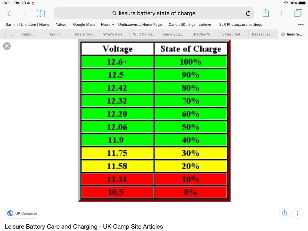

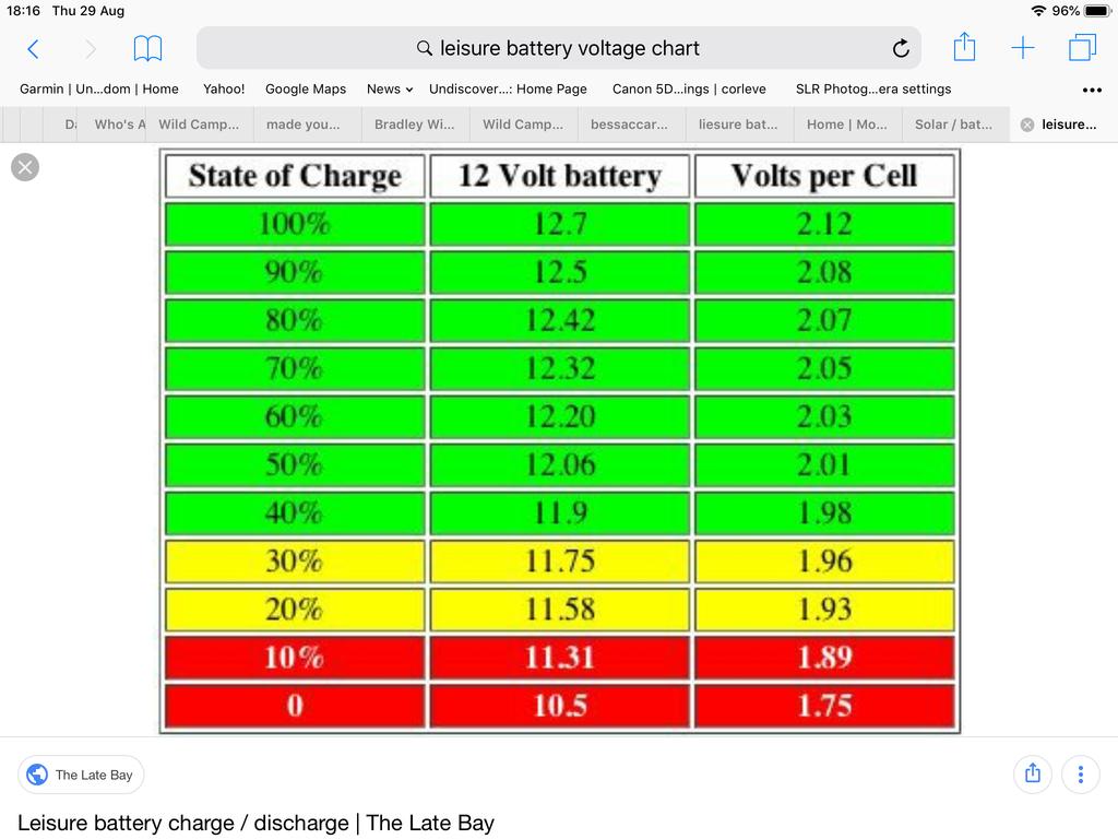

12.7 volts in a battery is a dead battery.
Is it ?

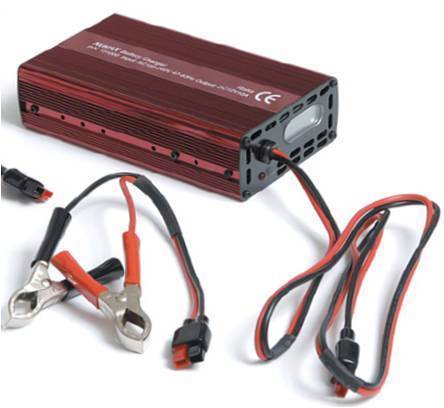

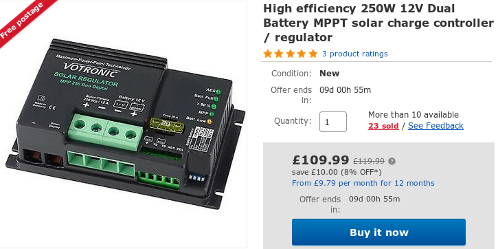

First of all most of them so called charger power supply units are poor to say the least,better to have a proper multi stage and float charger ,as for the panel again a sep unit mppt which will charge both van and starter battery.

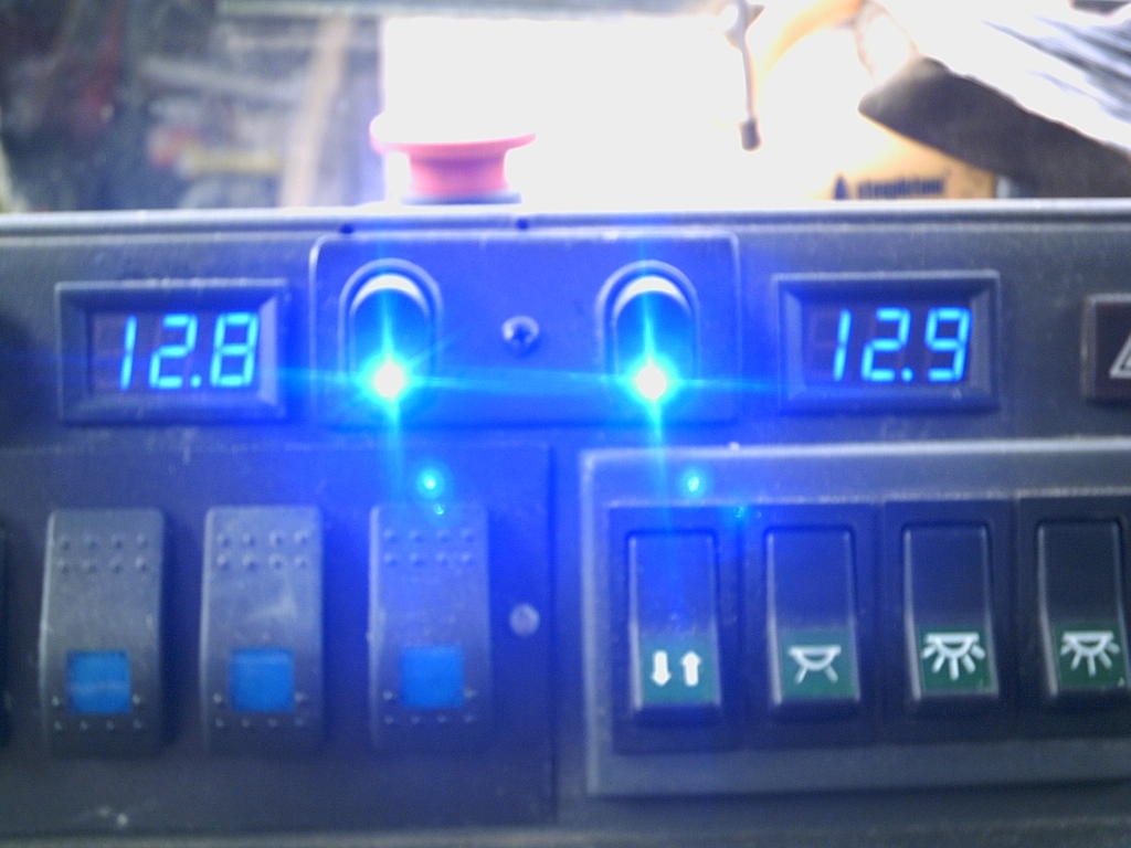

I use a couple of them plug in jobbies, one in the dash and one in the hab end. The hab one gives the same reading as the Pilote tablet display but as it’s on permanently its easier to view.
Cheap as chinese chips voltmeters..
I only have 1 on my LB.
Shows 14.4 in thr bright sun.
Down to 13.3 or so when it is dull.
Now at gone 10pm 12.9
Might go down to 12.6 at 3am.
Up at 13.5 or more at 9am.
1 LB at 90 ah
1 solar p at 120 watts.
The digital chinese voltmeter is consistent with my onboard control panel which is displaying green with 4 out of 5 lights on.
They are fitting a additional 110 watt panel and a new mppt controller to my van ,so it will be interesting to see the results when i pick it up and start faffing about with it,just when my old vantana was on song i go and change.Oh and a second leasure battery so i hope there`s no messing with the 120 panel.
I would ask them to fit the solar regulator i put on here as it has a 1ah trickle to starter battery,all others do not.
