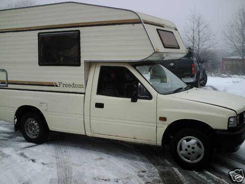

Thanks all the van currently has no heating bought as a stop gap till we find our perfect van following our beloved Fiat Pandora being written off in June I suffered confidence wise afterwards being in a vehicle and needed something I felt comfortable in (no rational to this) We have bought a Freedom camper on a Bedford Brava base looks like a demounable but isn't if that makes sense. Has an upper double meaning other half can have a lie in whilst I can get up and have a brew and read a book or whatever. Van is 1990 in date any one with any information on the conversions I would love to know more. !BpYQk7g!Wk~$(KGrHqEOKisEuZjHqP5+BLrH+7l!C!~~_12.jpg
