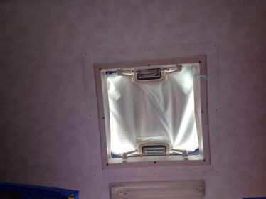

Someone I met at some recent music festivals has a mid-1990s Compass MH (not sure of the model) in which the dome and spiders of the front skylight has failed. It looks like a 400x400mm MPK but the MPK won't fit as the roof is tapered so that one end of the opening is almost 2" thicker than the other. His local dealer can't identify the skylight and doesn't know where to get a replacement. I'd be grateful for help to identify this skylight. TIA, Geoff

Thanks. I've asked my friend for photos but not received them yet. At first, I thought that the inner panel had dropped at one end and that the skylight would pull it back up when fitted, but that doesn't seem to be the case. The taper is pronounced enough that the connecting screws miss one end of a standard MPK. I suspect the job could be bodged by fitting a tapered liner between the inner roof panel and the lower part of the skylight (to counter the taper of the roof) and using over-long screws to make up the increased separation between the inner and outer skylight assemblies. That said, I still can't understand why a manufacturer would design their roof this way.

I don't know whether they'll help, but my friend has sent me some photos. Right now the water is held at bay by some heavy duty poly sheet in place of the original dome (and I suspect he's praying for no rain!). He's asked his local dealer, who says they can't help because of the age of the van :( So he'd welcome any info to help source a replacement.

Brain fade means I can't think of make, but that looks like a standard off the shelf one still available!
sounds like he's unwilling to settle for anything less than an exact replacement
Looks like an MBK, If an original fitting then it's going to be
over 25 years ancient, mouldings and details are likely to have changed in
the meantime.
So long as the roof cut out dims. match, many rooflights will
drop in. It may be that screw hole positions may not coincide.
With the Fiamma 400x400 the exterior plastic frame screw fixes
through the roof skin to a frame, usually just wood 40mm width X
roof thickness depth, it doesn't rely on screwing the outer frame to the
interior frame cramping the ceiling lining and roof skin together.
The ceiling lining is screwed to the underside of the wood frame the inner
plastic decorative frame covers these screws.
So if the roof tapers the wood frame can be scribed to suit any taper.
It may be possible to reuse any inner parallel or tapering linings
The main thing is that the roof flange sits as flat as possible on the
roof, no making up any discrepancies by tapering!
The best sealant Sikaflex Elastomer 710 always remains plastic rather
than elastic can be messy to apply, but allows removal without ripping
the roof off!
Not true, he'll settle for a functional equivalent. As Byronic mentioned, it looks like an MPK -- but the van is mid to late 1990s and so it'll be a model from a couple of decades ago. As the MPK works by screwing the inner to the outer, thus clamping the roof between the two assemblies, it won't work here. From Byronic's post, I suspect the Fiamma 400 x 400 might do the job.

This was precisely the issue with the MPK I originally suggested before I understood that the roof thickness tapers. Just by offering up the assemblies, you could see that the screws would enter the mating holes at an angle and that the screw guides on the lower assembly did not line up with the screw holes in the upper assembly. I was going to suggest he might be able to use the spiders and dome from a new MPK 400x400 to replace the damaged dome assembly of the original equipment, but he'd already returned the skylight. I know that you can buy a "dome with handles" assembly (here from Leisure Shop Direct), but I can't say that'll fit without knowing the dimensions for both new and old. Perhaps he might be able to order one on a "return if it doesn't fit" basis. Then again, the Fiamma skylight isn't massively more expensive than the MPK dome assembly.
That was what I was going to suggest, have done it on an old skylight myself.
