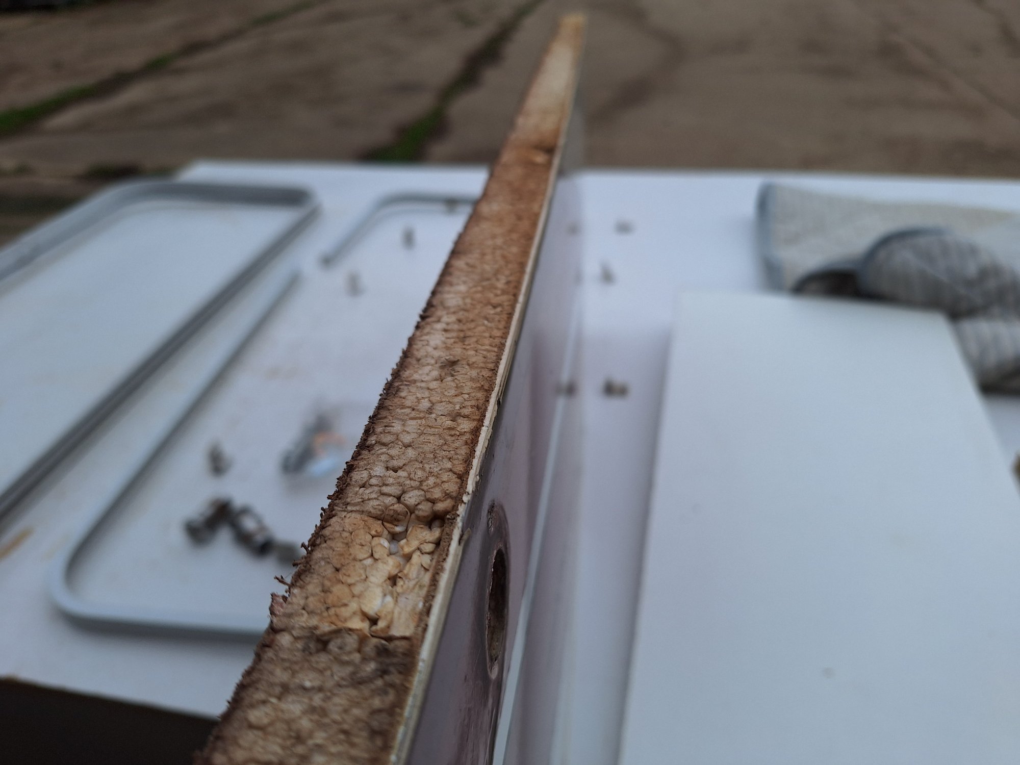

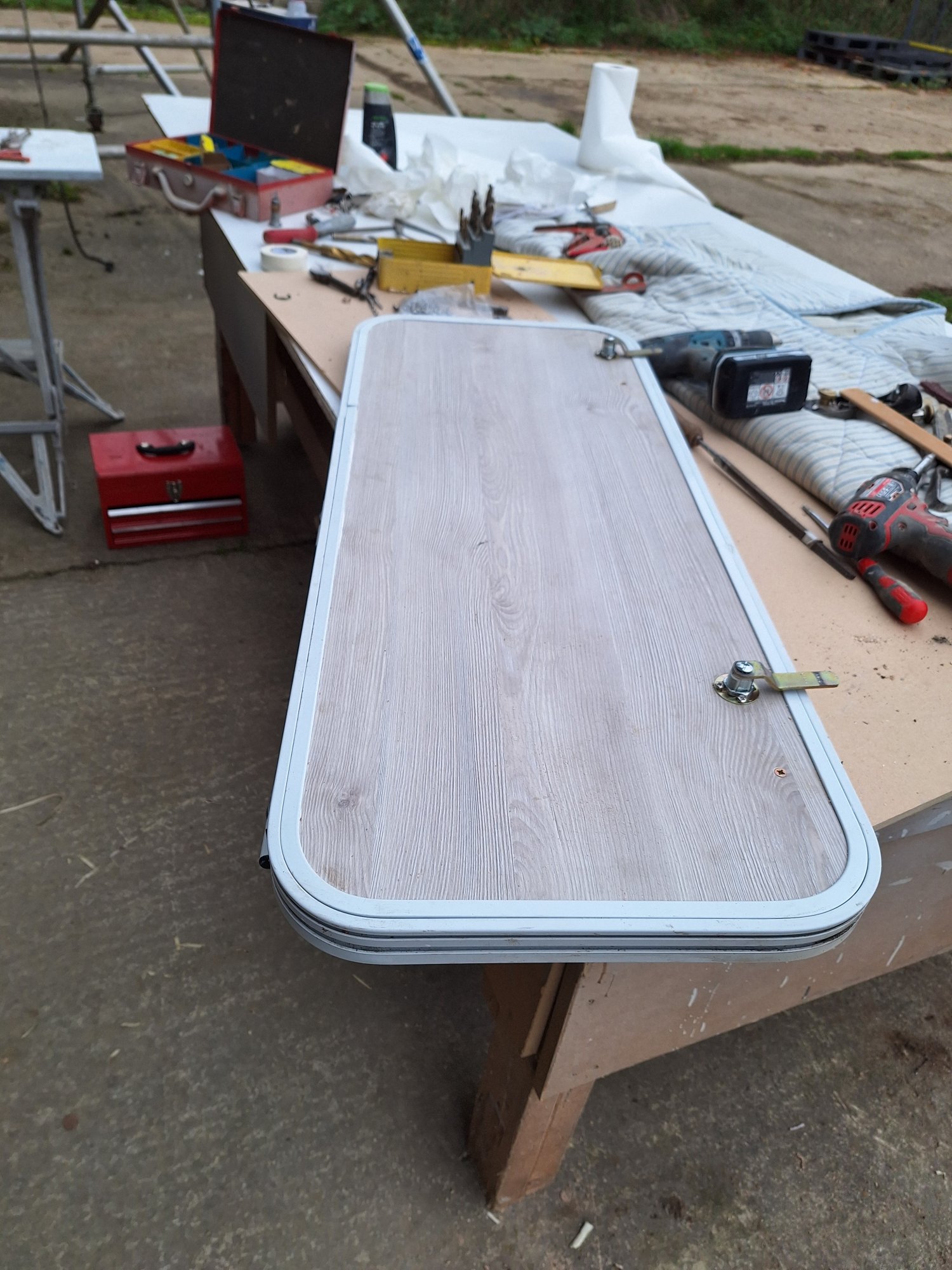

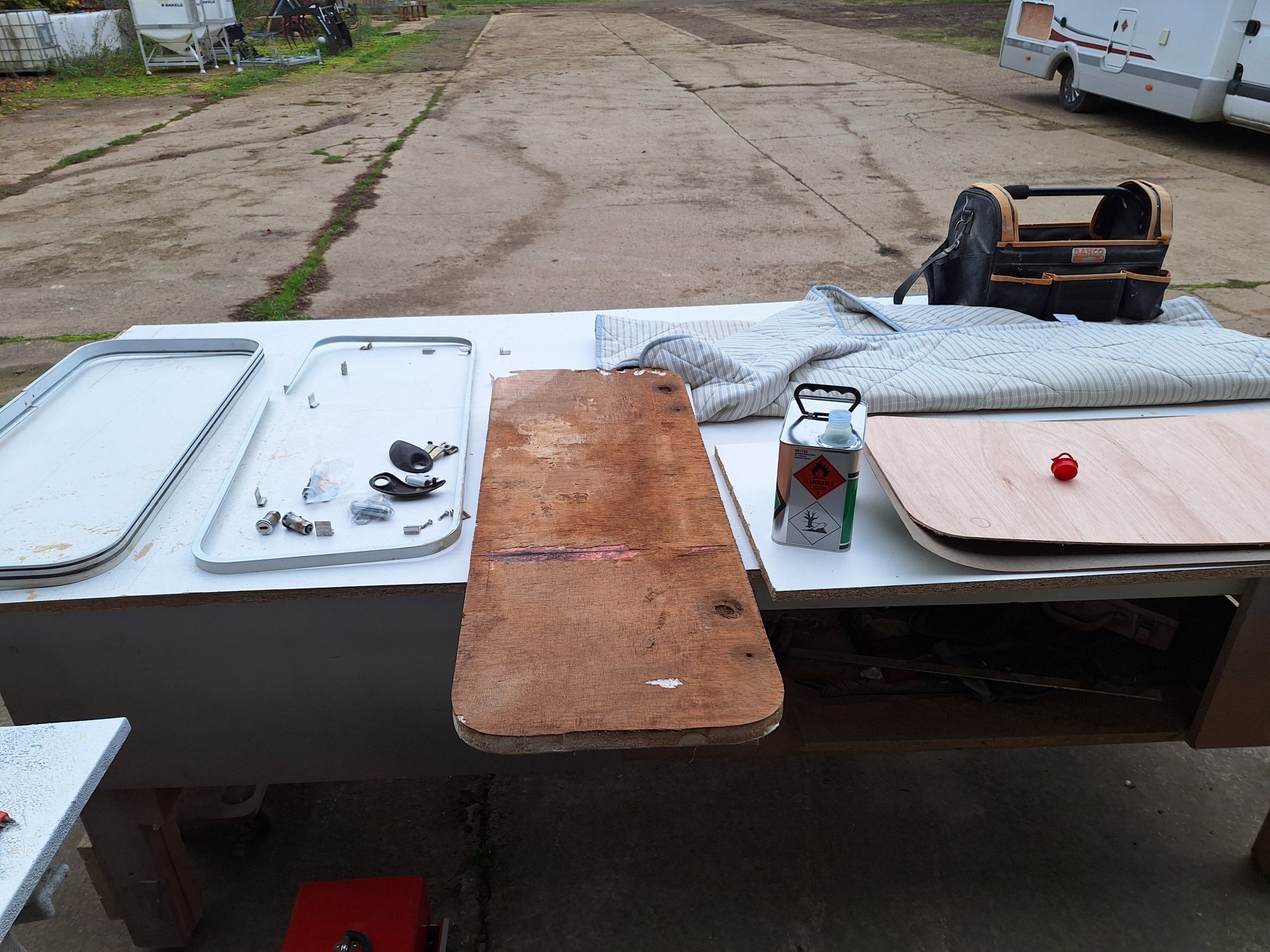

Here is the hatch in its component parts. The panel is a sandwich made from an aluminium outer skin polystyrene inner and plywood back. Water had got in and badly damaged the plywood and where the locks went through the plywood had completely collapsed . The lock washers had lost grip allowing the entire lock barrels to spin. The nuts on the back of the locks had seized up solid and had to be sawn off.

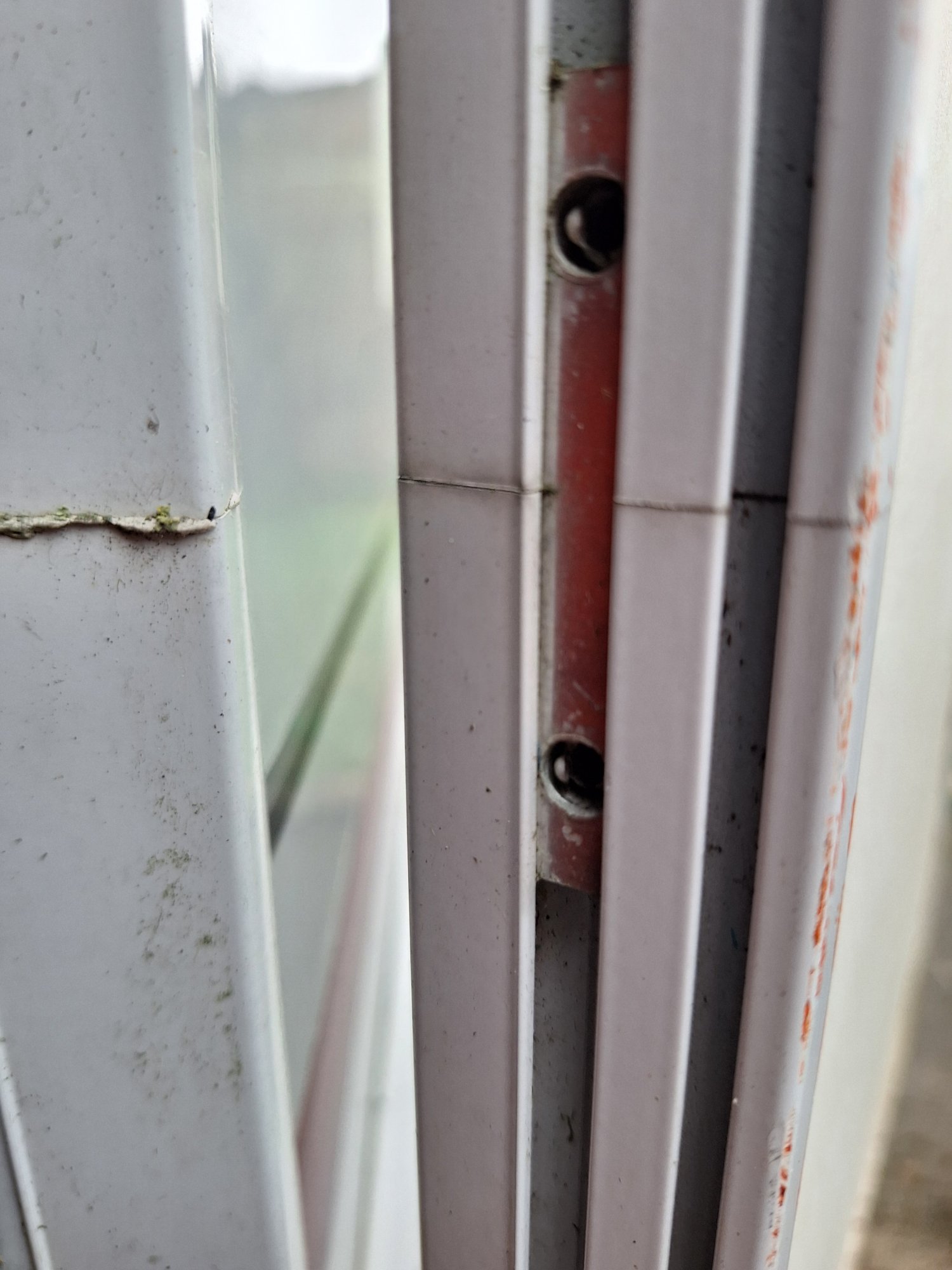

Splitting down was probably the hardest part of the job. There were no visible fixings apart from a plate like this which was riveted from the inside. These I drilled out

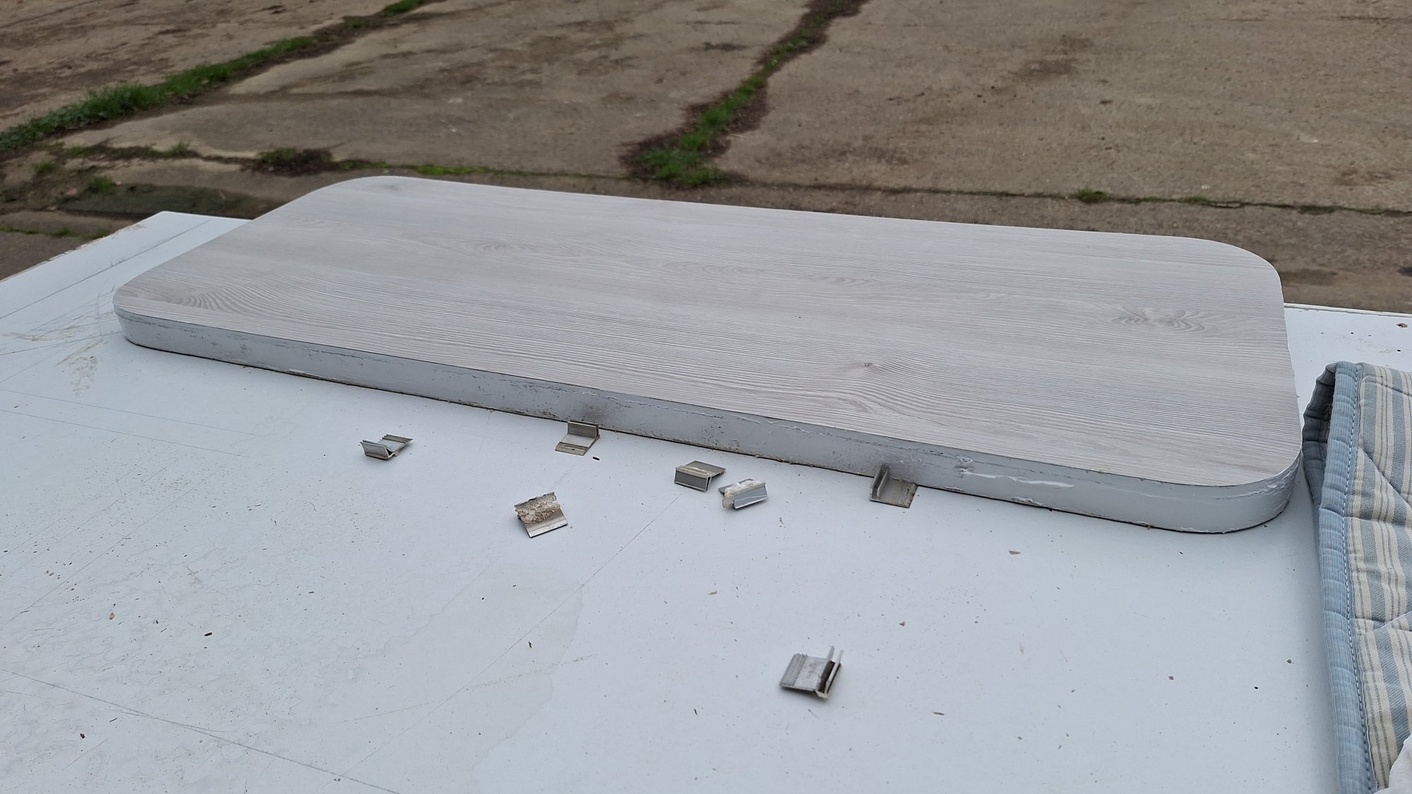

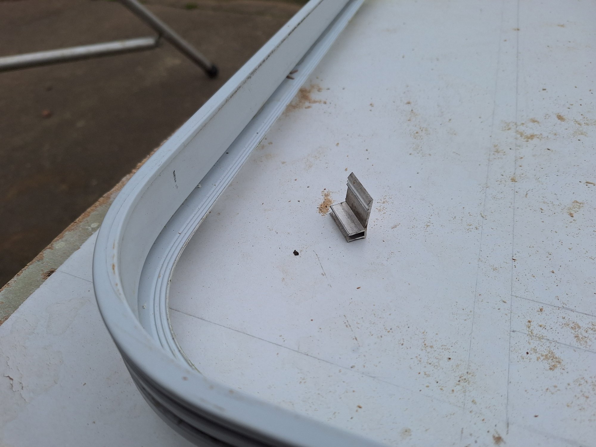

Then it was a case of running a blade around the ally section to break the sealant seal then once I could pull the end apart I could prise the inner section off the hidden clips

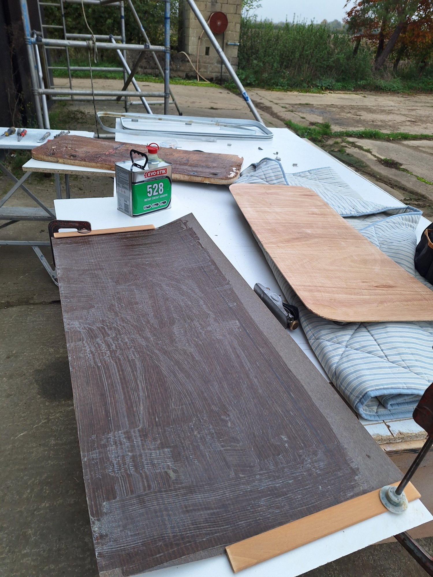

I had some 3.5mm ply and some .75 ish laminate so laminated up both sides of the ply.
After cleaning off the failed ply from the hatch panel it de laminated down but left its face veneer still firmly stuck to the polystyrene . This suited me well as I was able to contact my new panel to this.

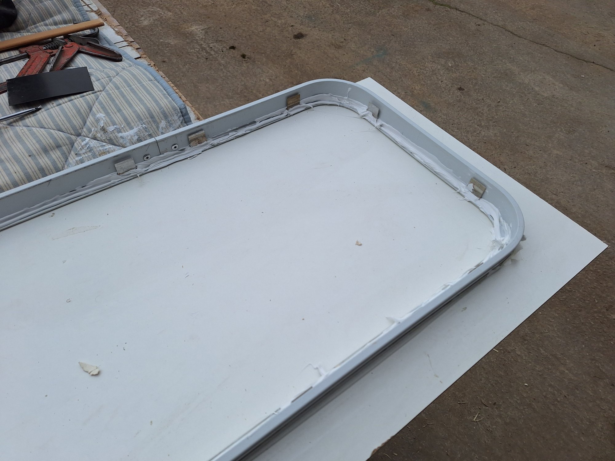

I re riveted the joint plate, refitted the clips and smagged everthing up including the edge of the repaired panel.
The inner ally section just presses in and is caught and held by the clips
