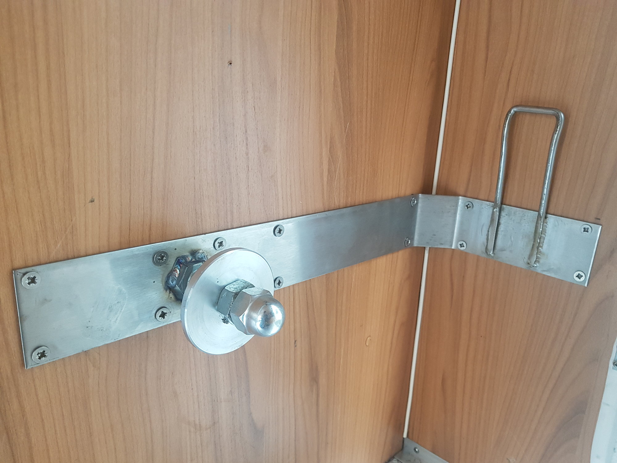

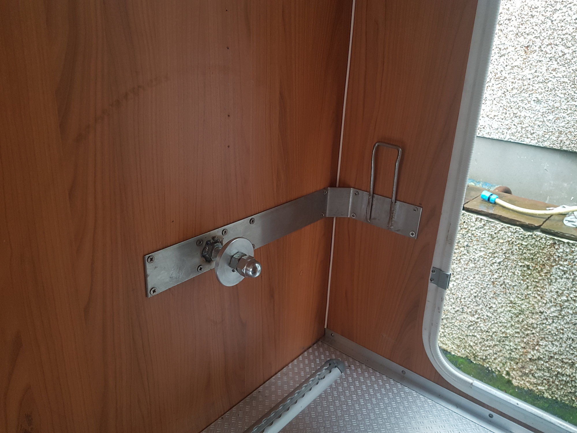

Dear mr Scotia please will you make me one of those it looks so much easier to carry your spare than the silly rack underneath that gets all rusty and sieges up.💋💋
Underslung spares are a right PITA! the VW T5 has those and when I first got my T5 it took nearly an hour of significant physical activity to undo the two securing nuts to free the wheel (probably not been touched for ages and IIRC the spare was bald as well! )
