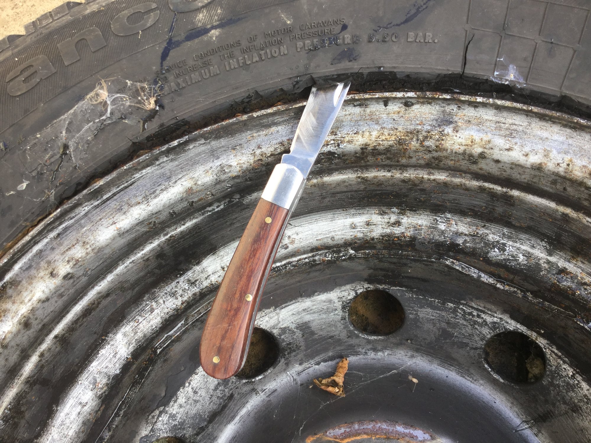

after i got back from portugal last year i decided that while locked down i would pursue raising my weight limit so ordered new16” wheels changed them all over a couple of months back & although i knew a couple had worn treads they were still within date 28/17 in the box so barely 4 years old , my last journey was 1500 mls back home motorway all the way so at speed came out in a cold sweat when i later examined this wheel tread is fine but on the inside around the rim it is breaking away can only think it was me exceeding the load rating but they are camping continentals , i have now gone with heavy duty 120 load rated tyres not worried about a little tyre noise

Not sure about overloaded, from the pic the damage looks limited to one area which would suggest a rather deep pothole with the weight contributing ........ either way a bit scary for an in date tyre 😱

Those rims also require shotblasting and epoxy on inside,we used to lots of taxi rims because of leaks or grinding the seal of the tyre.

But I didn't stick a penknife in mine ;).
Replaced mine with 121 Load index tyres. But Avons, which later found Avon do not recommended for use on MoHo or Caravans

after i got back from portugal last year i decided that while locked down i would pursue raising my weight limit so ordered new16” wheels changed them all over a couple of months back & although i knew a couple had worn treads they were still within date 28/17 in the box so barely 4 years old , my last journey was 1500 mls back home motorway all the way so at speed came out in a cold sweat when i later examined this wheel tread is fine but on the inside around the rim it is breaking away can only think it was me exceeding the load rating but they are camping continentals , i have now gone with heavy duty 120 load rated tyres not worried about a little tyre noise View attachment 87829
I wonder if the tyres have been under inflated and with little uneven road surfaces the metal rim has just worn the rubber at the rim edge with faster deterioriation especially with the heat in portugal and the run back - dont know - but you have had a very lucky escape

as above i did give my tyres a check over before leaving portugal i noticed one of my front tyres was worn though still legal & decided to swap it for my spare but when i got that out it was equally worn so with the help of Reg i rotated a rear one the damaged tyre was the other rear and the damage is on the inner wall so a bog standard visual check didn’t find this
