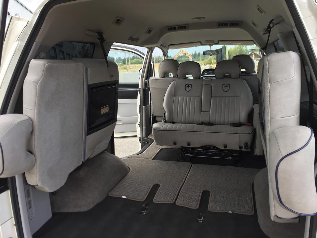

The centre seat in a Mitsubishi Delica L400 8 seater is a two seater that swivels - seat belts are attached to the seat.
Not a very good pic - but in this wiew its rotated 180 degrees.
This is a lovely looking seat. Looks a bit wide fornanfront passenger and none on eBay
