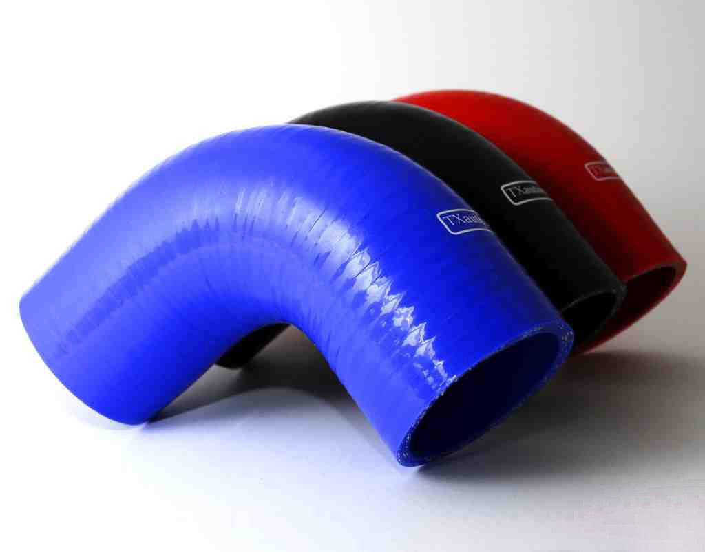

Cant you do it with copper pipe then use a soldered straight connection to get the swaged end which will hold a hose when fixed in place with a hose clip or use a copper bend to get the bend in the hose.
This could help
