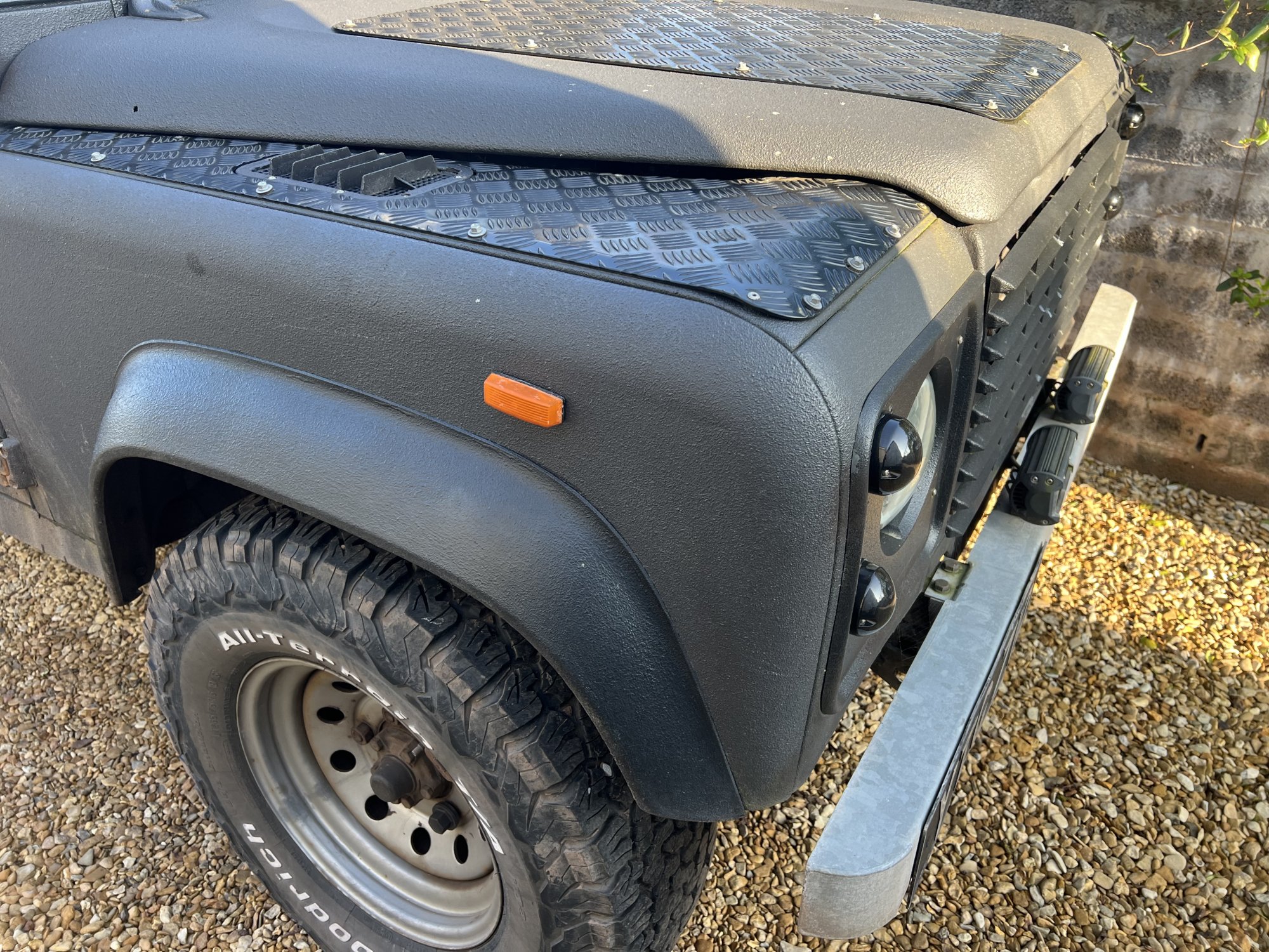

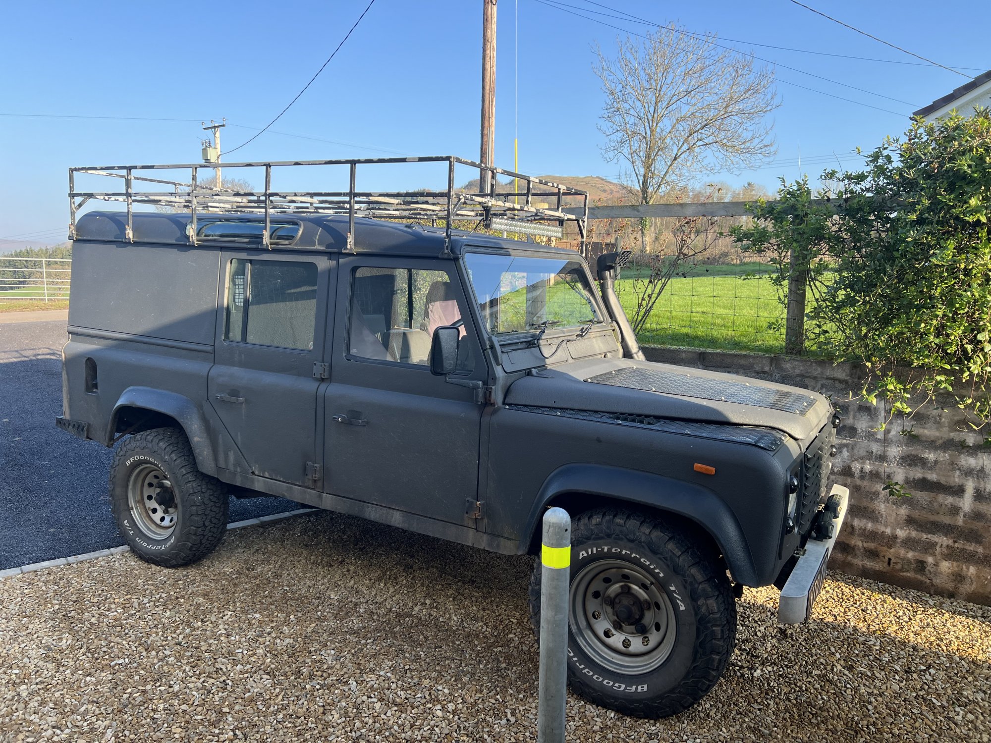

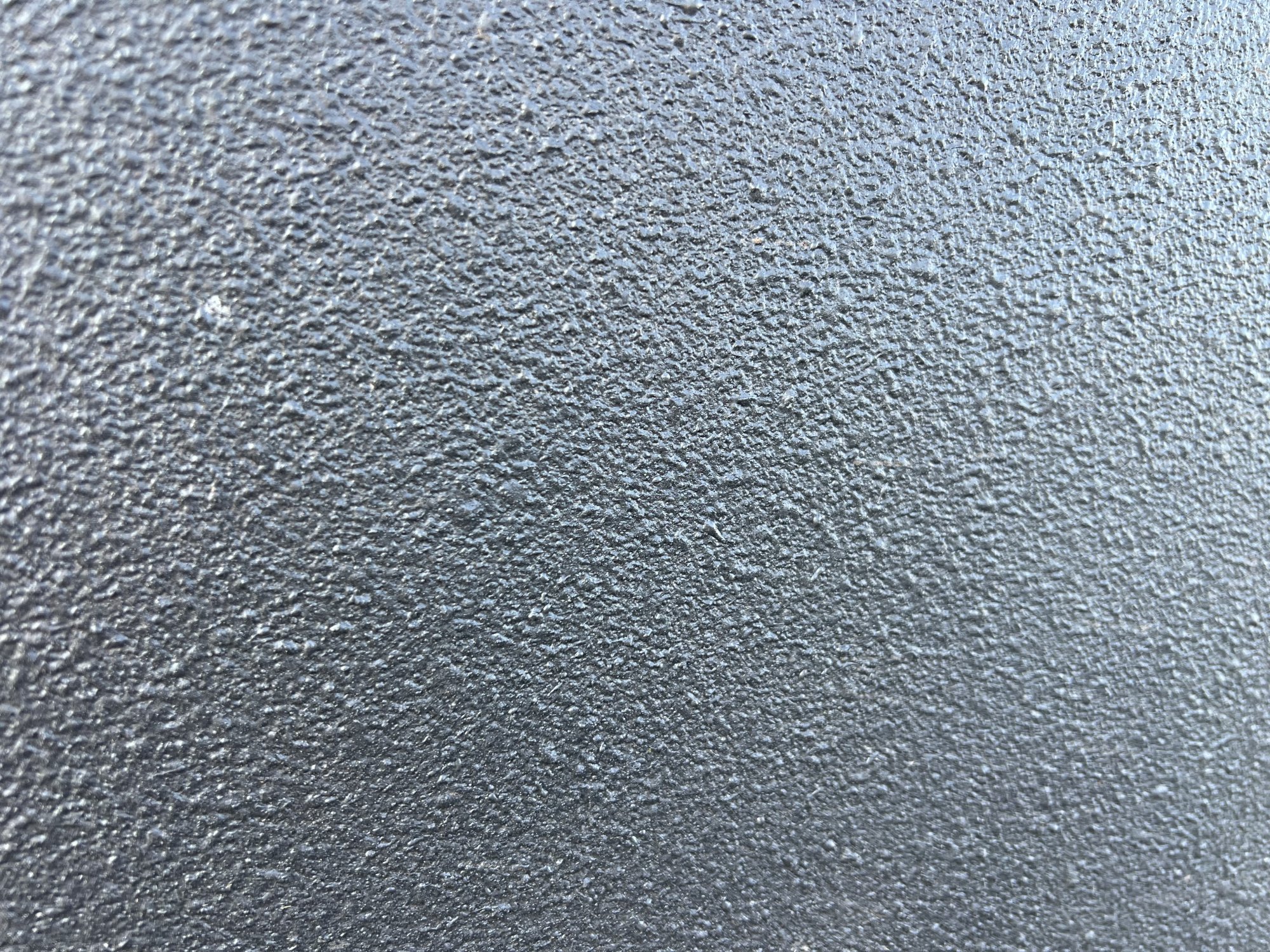

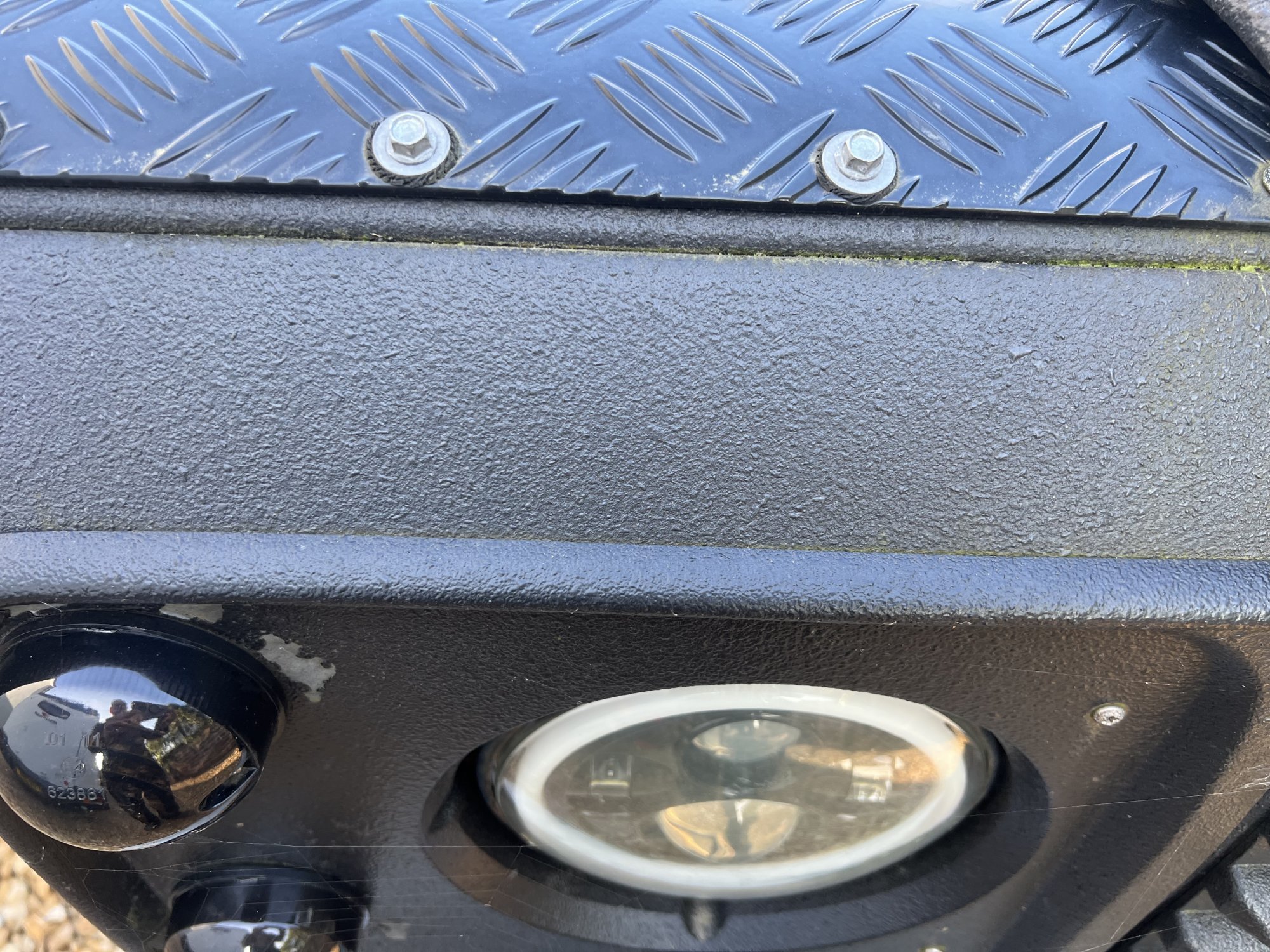

Hi Rob, my Land Rover has been sprayed in raptor, it is very hard wearing giving it a plastic coating but be aware it isn’t smooth it gives it a rough texture. I can post a pic if you like?

I quite like the textured finish - they supply 2 rollers so when I do my wet room I will use the finer one for the walls and the coarser one for the ply shower tray I am making. The roof will not matter really as the area I am doing is where I have bolted Unistrut rails to hold the solar panels so I will work the raptor in around the bolts with a very small brush. If I were to ever build a stealth van (which I won't at my age) I would love to have it sprayed in Army Green Raptor.

I would love to see a picture of the Landy.
Here you go, it is due a wash tho 😀. It’s quite muddy in the lane where I live!
