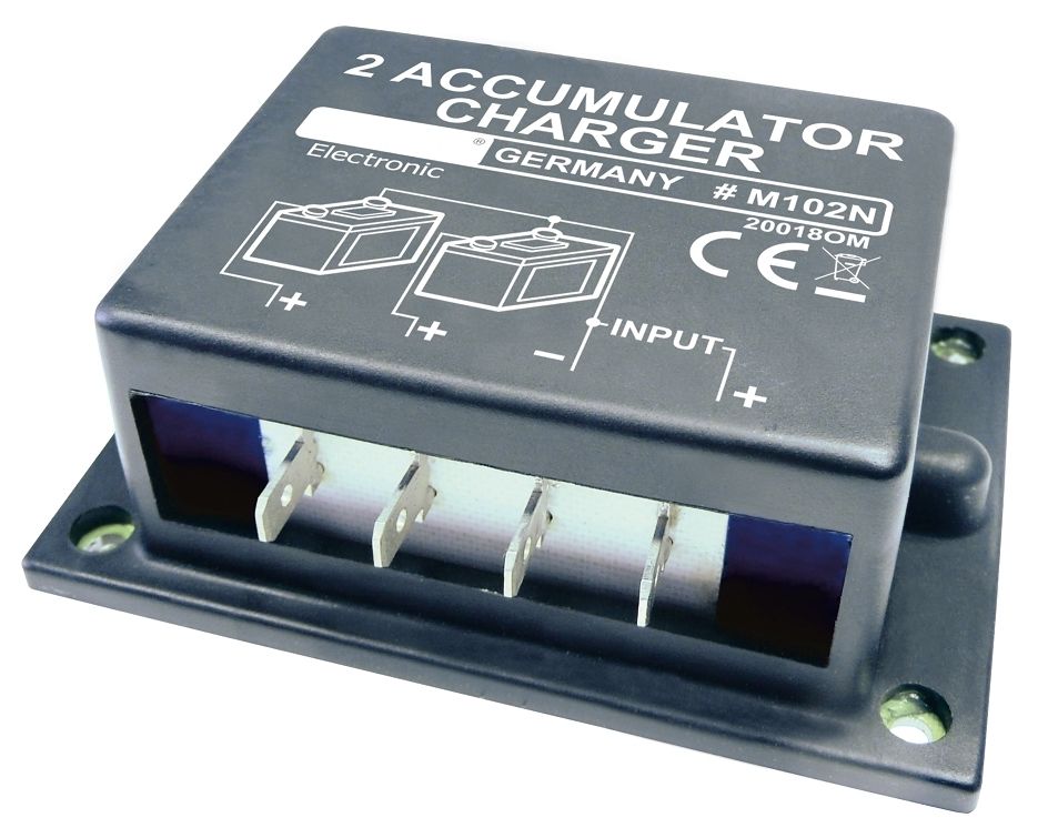

If it were me i would fit the smart charger and split the output to both leisure and engine battery with this unit as i have done.
The charger you have bought will do all this with no bother.
thanks foe the reply, 2 things how to split it between batteries and also the van is fitted with day time lights which come on as soon as you attach a charger, would it be easy to wire these in a different way? ps how will I find out about the transformer, and thanks again
just seen the attachment
