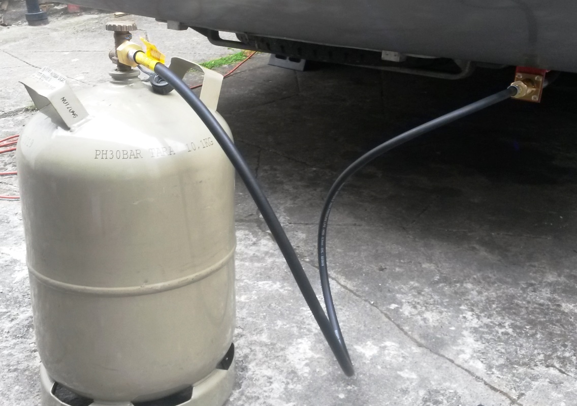

I bought the Gaslow Reserve Cylinder Connection Hose at the time in 2015 it was £16.50.I used it to purge air and check for leaks prior to filling at an LPG station.Here it is connected to the german bottle that came when I bought the motorhome in germany:
Although the link says it will not transmit liquid gas, physics says that if the external bottle is warmer and is inverted it will empty into the fixed tank,
Yes placed upside down and higher than the fill point of the van left in the sun most of bottle will drain into tank in a few hrs

Would one those connectors top up a low gassit under slung tank ??.
Short answer is NO.
The gas in a bottle or tank is at high pressure.
Any gas that has been though a regulator is at low pressure.
Gas does flow from low pressure to high pressure.
If you are asking about the hose I mentioned that connects to the fill point, then yes. The right way up it will feed gas and whether the propane bottle or the lpg in the tank was used would depend on which was warmer. That causes the bottles to equalise temperature quite quickly.
If the propane was inverted the propane liquid would fill the underslung tank , (if the propane was warmer, than the lpg), until the volume safety float valve shut off. If the propane got equal in temperature before that point it would need to be warmed again. Say a bath of warm water or the sun.
Transferring liquid does not equalise the temperature anywhere near as much as transferring gas as the temperature drops due to the volume expanded. There are many litres of gas in a litre of liquid.
Short answer is NO.
As I understand the connection pipe would fit directly on the gas bottle , the pressure would be regulated by the on board regulator. So bottle and tank would be high pressure, or am I missing something.the photo shows no bottle regulator.
the photo shows no regulator and the hose attaches to the fill point. So it is as I said.
