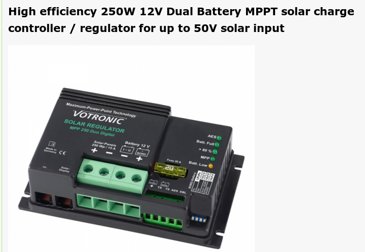

Many here will have there own pickings of regs but i like the votronic which also has a 1amp blead to the starter battery, it has all the settings for all types of batteries.

Buy a votronic, all simple marked switches.
