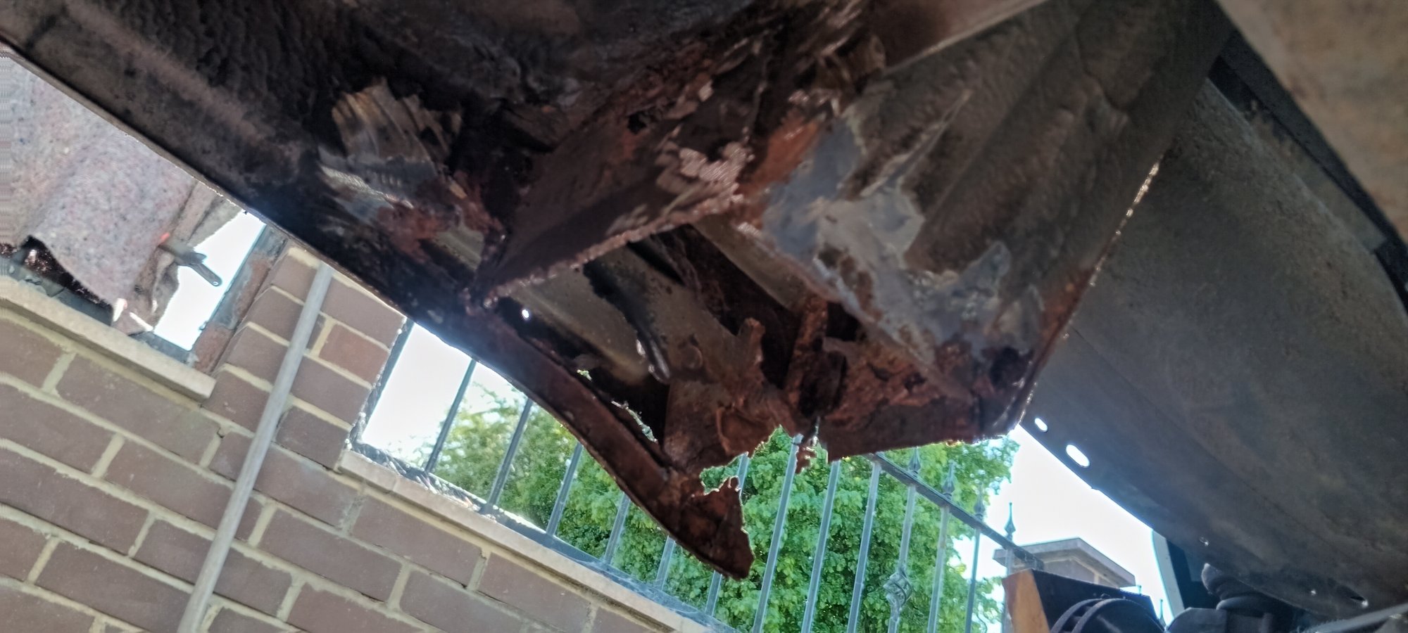

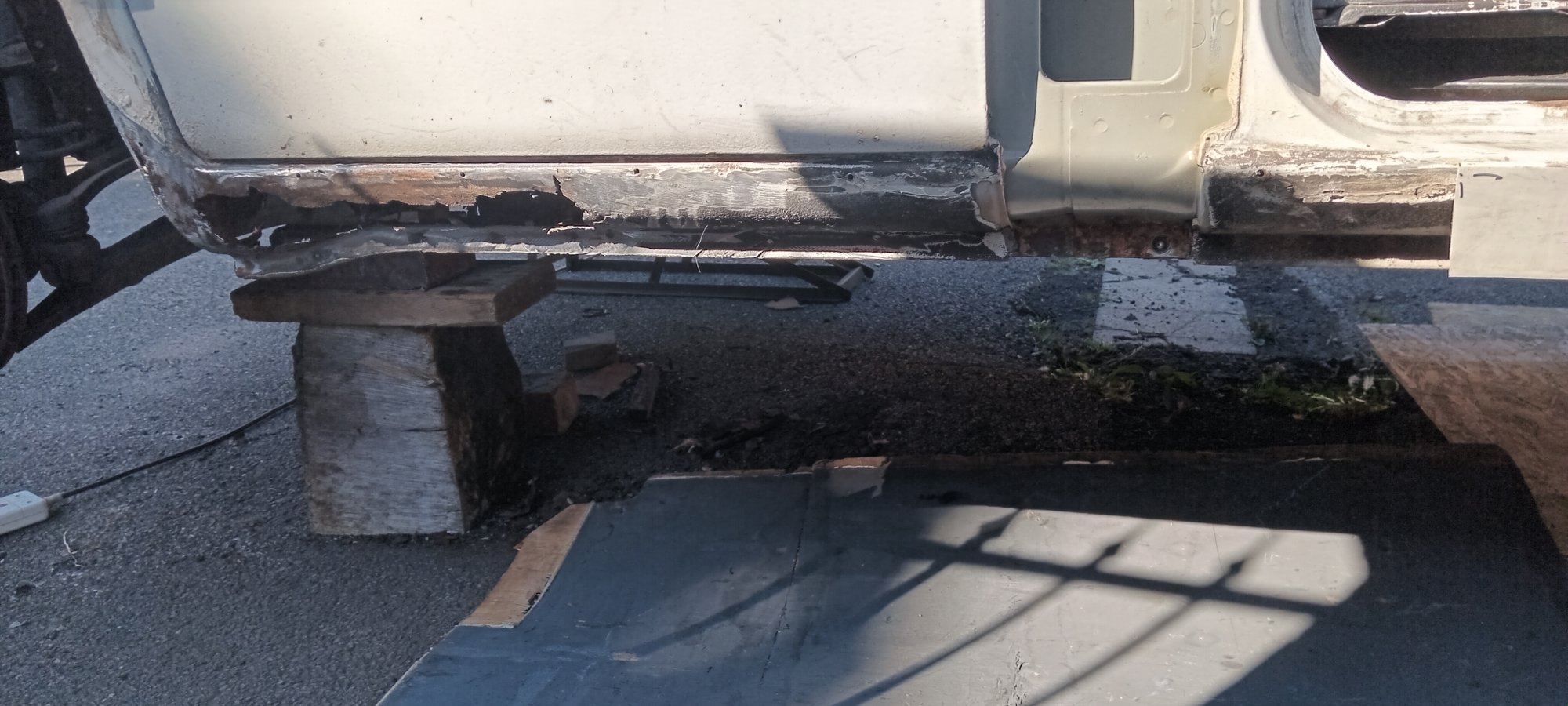

Have got a couple of these to do as they were MOT failures stating they could affect the structural integrity of the vehicle.
They are a massive construction fail considering the weight being lifted by such flimsy material - seemingly less than 1mm.
These have been repaired before but very much a bodge job. The glass fibre panel was a major pain to get off - the original repairer attempted, broke it and gave up thus making it difficult to get decent access to weld.
Have had to cut this one. Dunno whether there's a better way but open to suggestions?

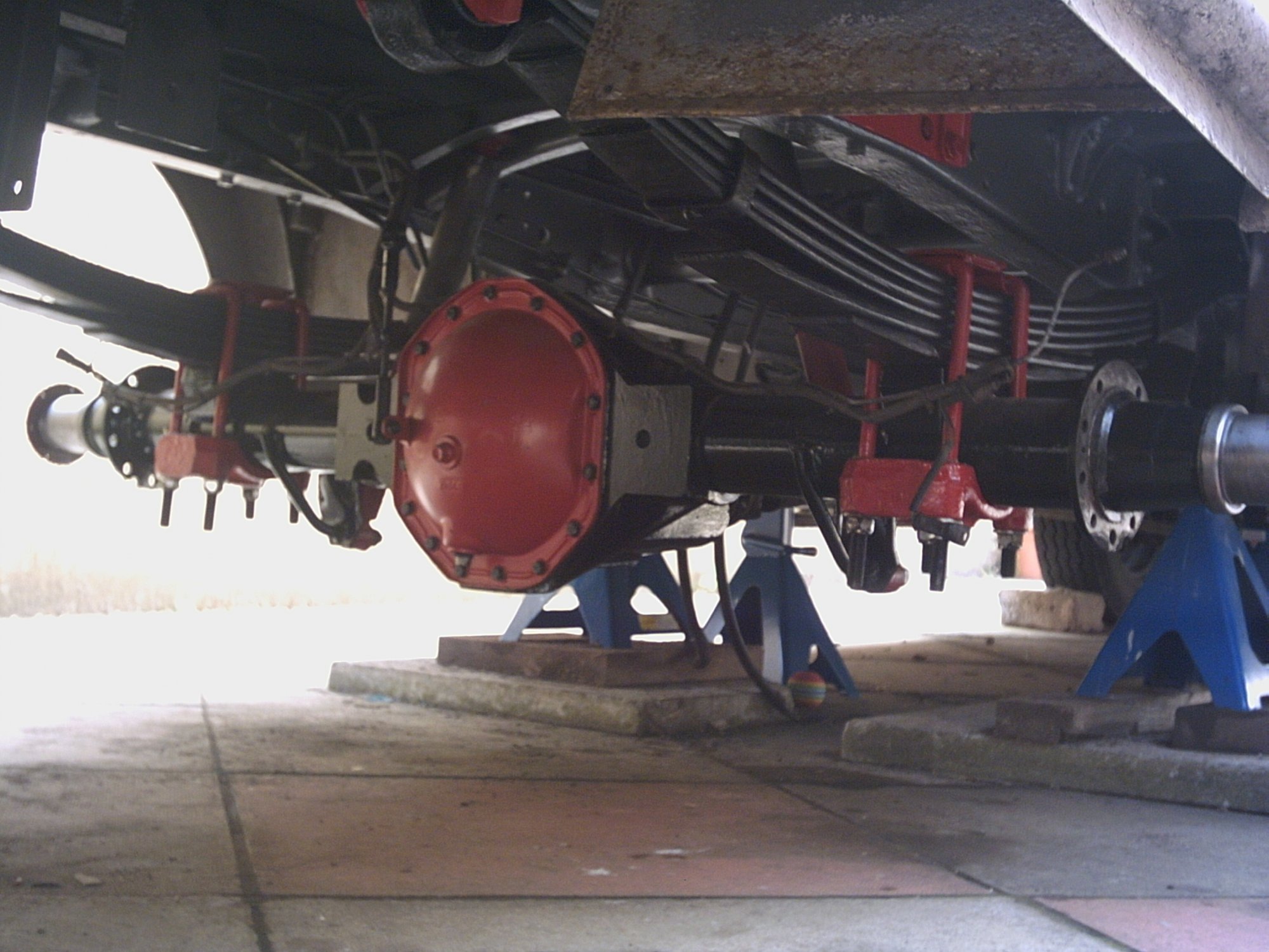

You jack under the ball joint and nout will bend, or if rear springs under the hanger brakets, almost 50 years in the trade and bent nothing yet.
Jacking on the body lifts it first which is daft and its very weak, jacking on ball joint or x member mount lifts the wheel.
